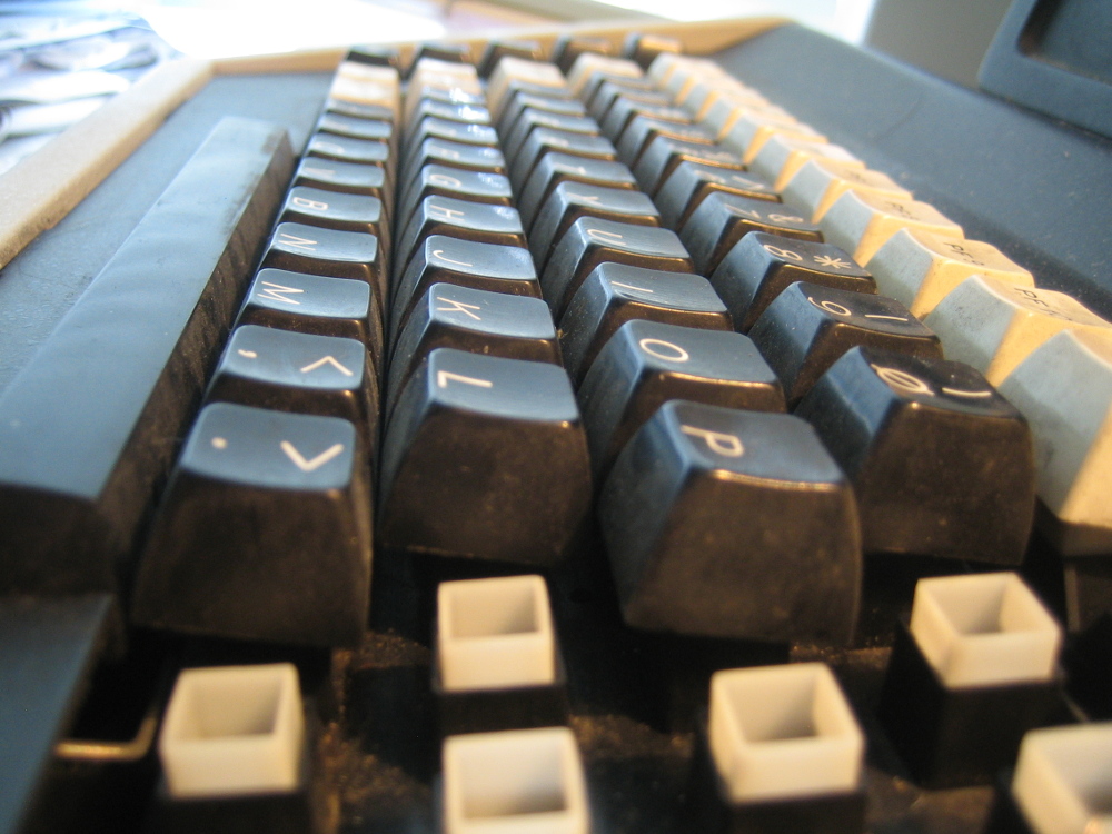

Nice keycaps, not specially sculpted. I like the '0' with a slash: that is how it should be !
The keyboard is advertised as 'detached', which is true by vt52 standards (most keyboards were still integrated in the terminal housing), but when looked at now, one of the striking features of the keyboard is the way it is connected via a ribbon cable that can not really be unplugged. The case is sturdy plastic, the top is metal, which tends to be other way around for most keyboards I own.
'Backspace' is still called 'Rub Out', which makes much more sense..

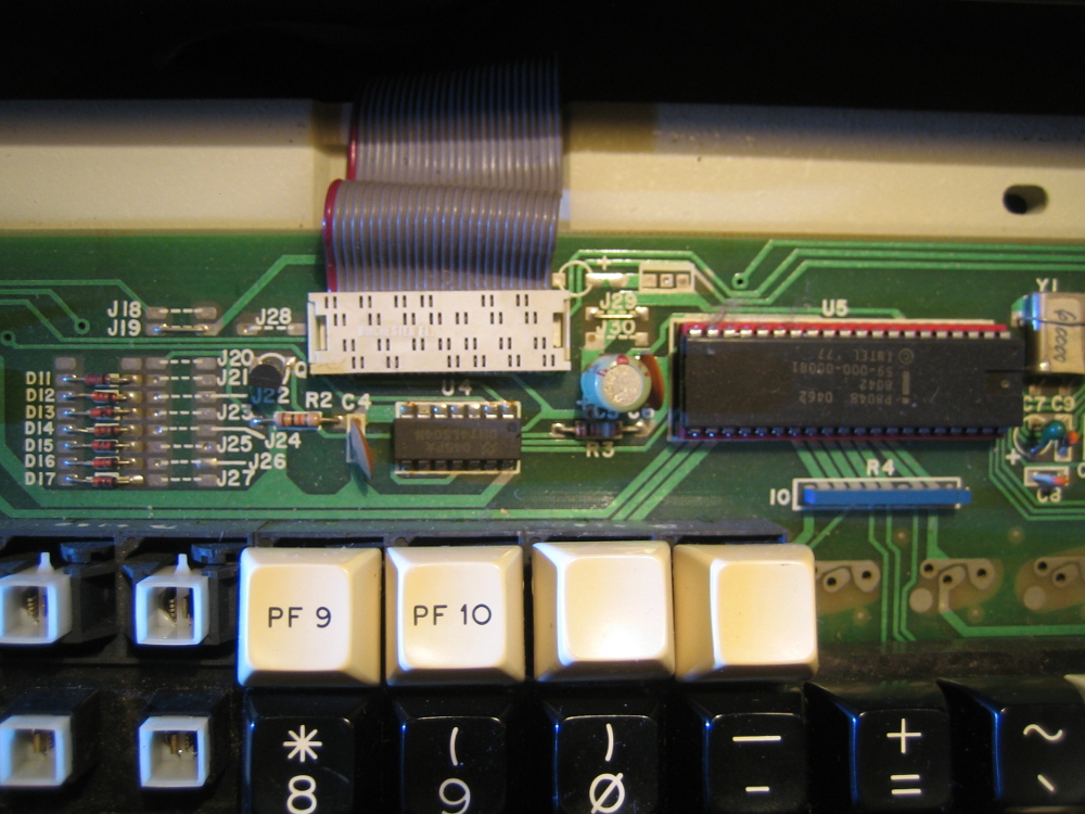

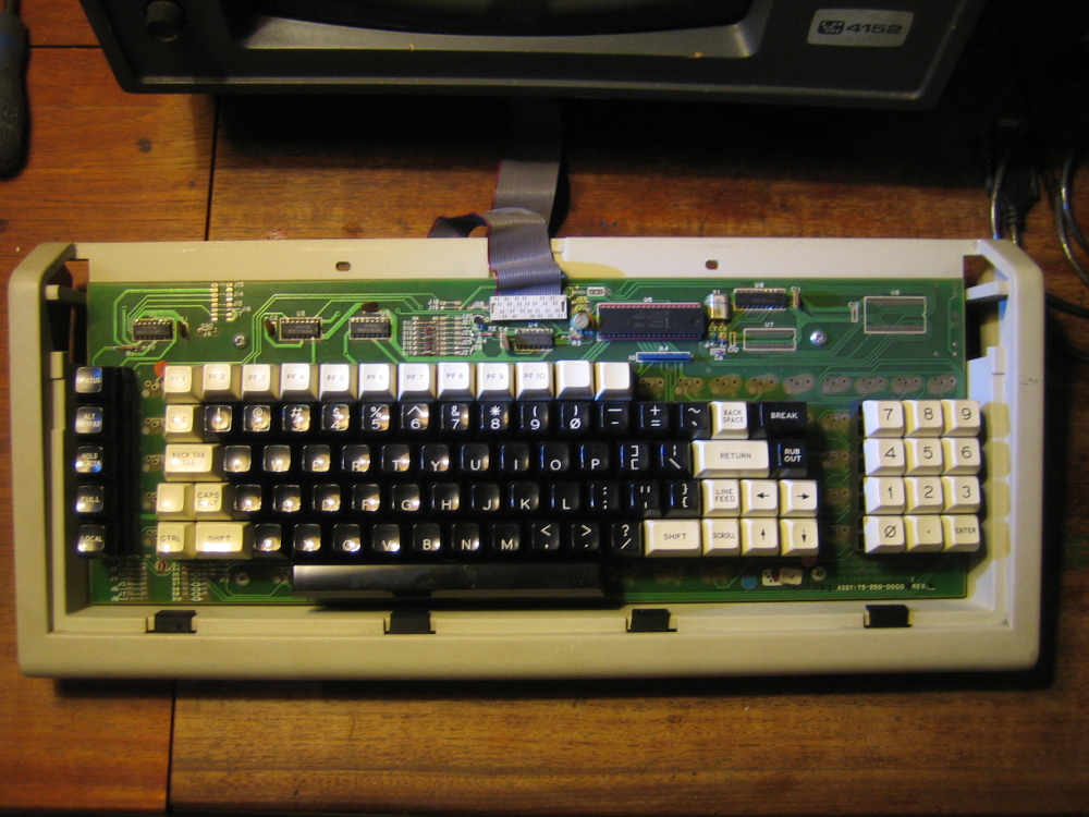

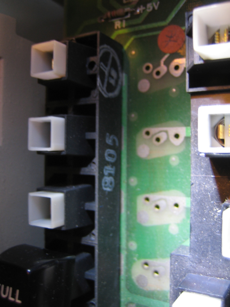

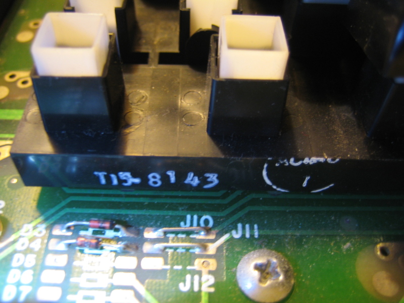

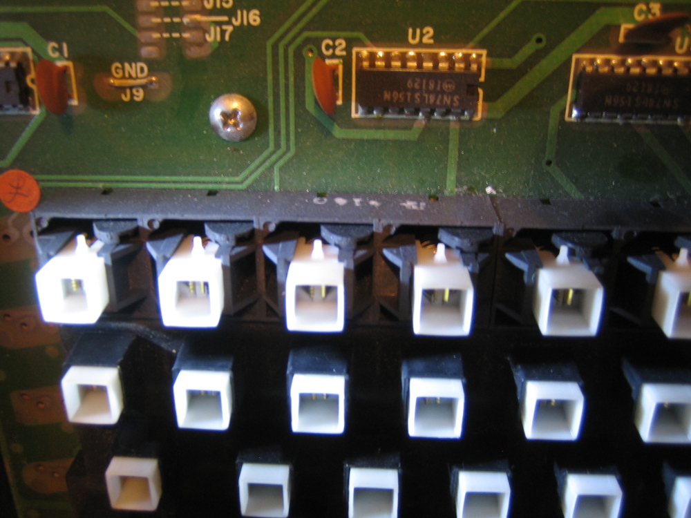

The switches are of the HiTek / Stackpole type that was very common in keyboards around that time. They are linear and this keyboard is more scratchy than some of the other boards I have with the same switch: that must be down to how it was used and stored.

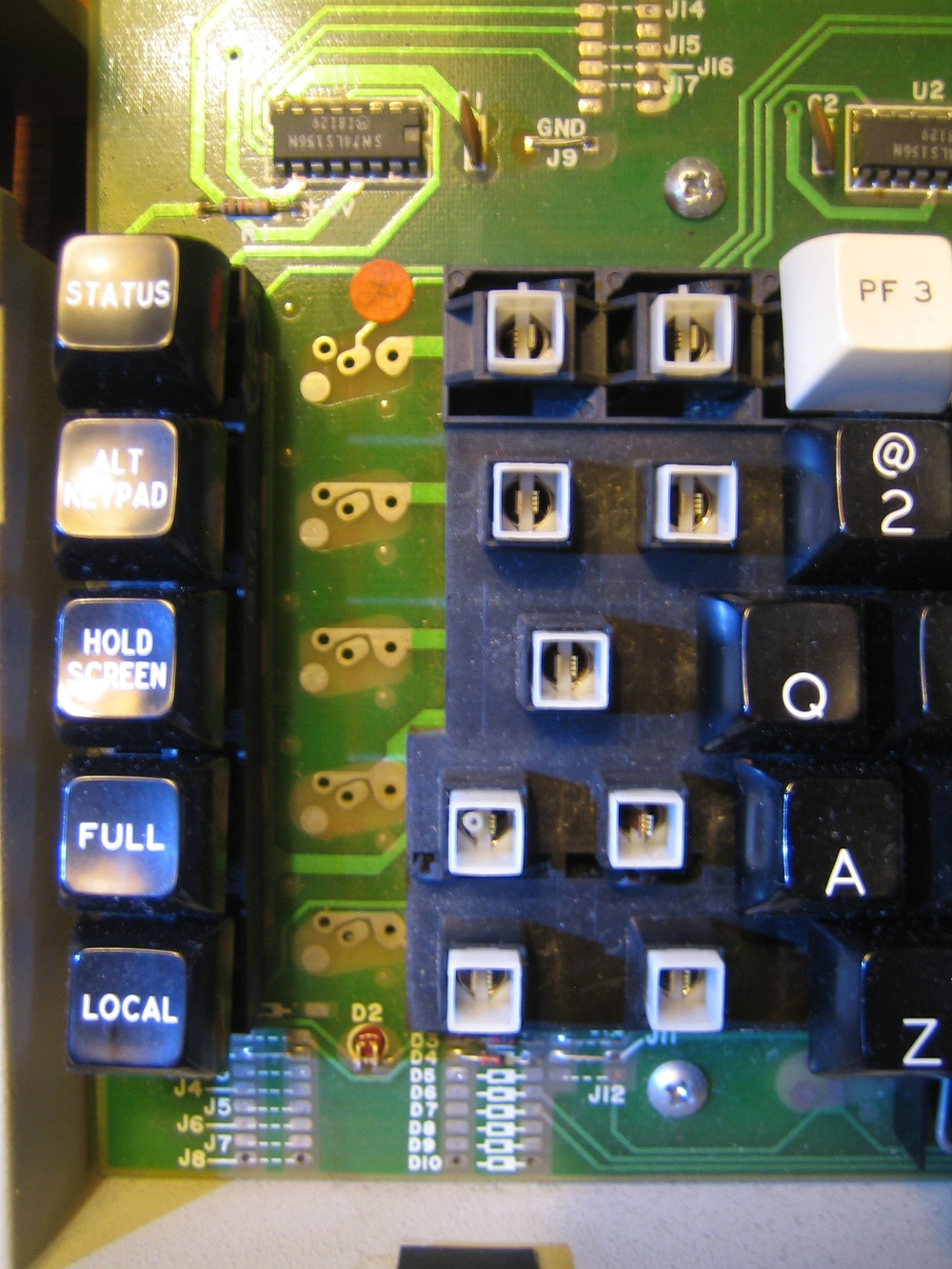

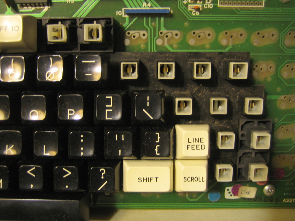

This keyboard seems to have keys added on to an original design; the larger plastic housing has smaller units around it consisting of just a few keys. And the pcb has plenty of connection points for more..
Note also the little coloured stickers and the written notes: the terminal is full of them and it gives a sense this thing was actually built by real people.
All the function keys can be made to latch by slipping on that little mechanism; I'm not sure how that would ever be useful. The only switch where this mechanically latching capability is actually used is caps lock.
1980 and plenty revisions.

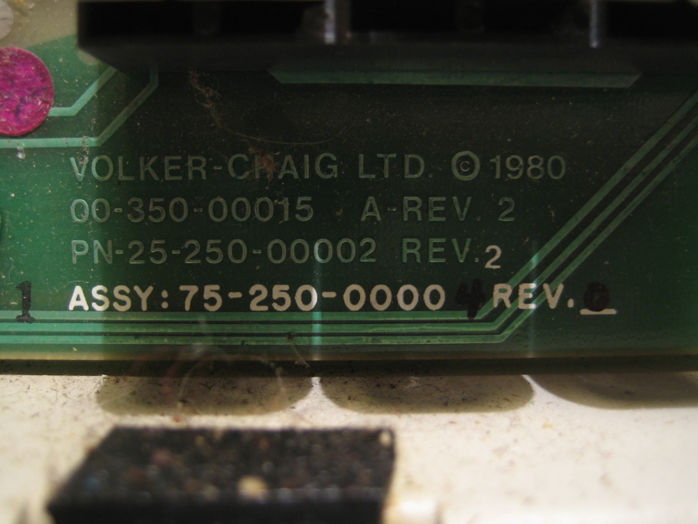

Together with the terminal I also received the operator's manual and all the schematics, including explanations of all the inner workings. I have not yet found what this led is for...
This terminal could be had with a few different keyboards, and I think I have explananations. protocol descriptions and schematics for about five different Volker Craig keyboards now: if somebody needs those...
some of the familiar white lettering that is found on such switch housings, no branding, but I did find the patent number below, under the spacebar, and it refers to a HiTek patent of this swich, from 1973.

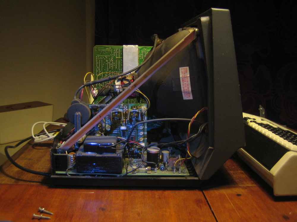

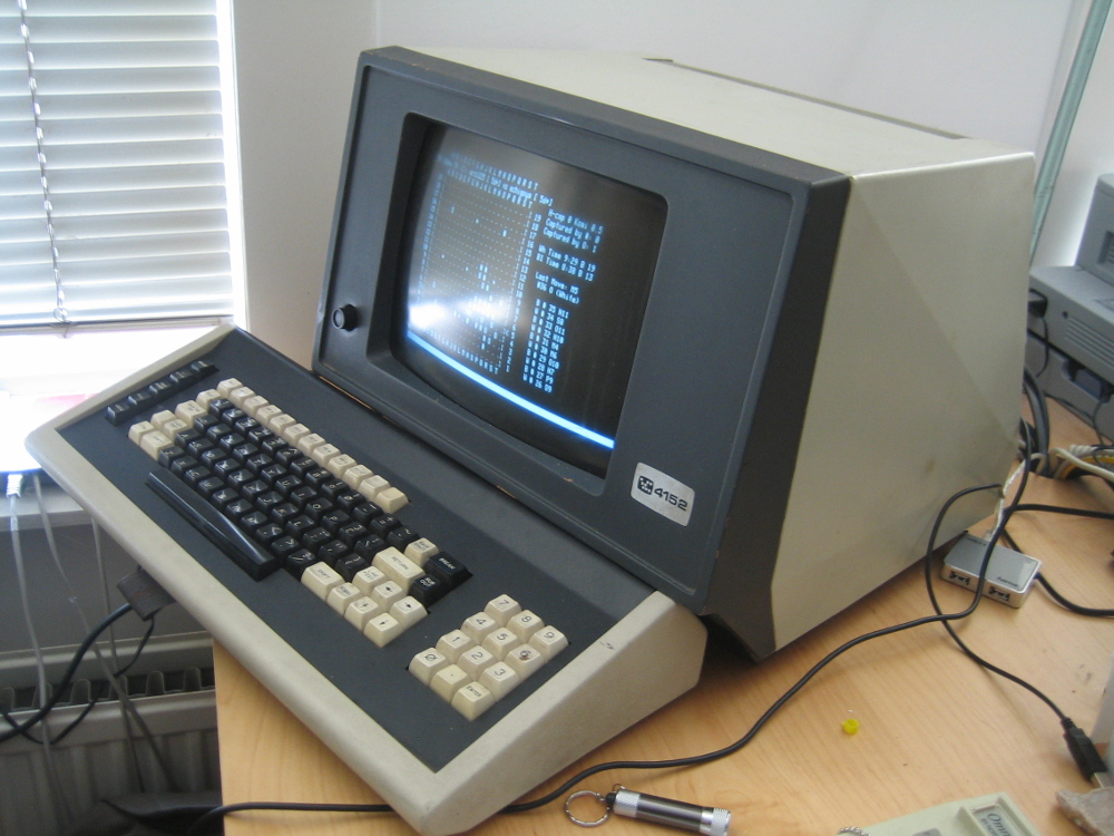

and some more picts that relate more to the terminal as a whole:
the insides are nice and sturdy and very empty too:

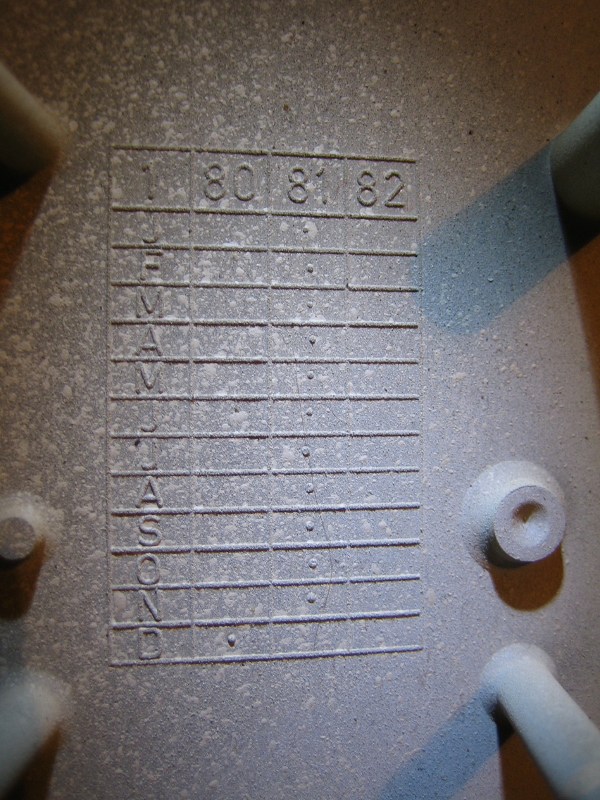

the grey piece that holds the CRT is actually made from mdf: wood !

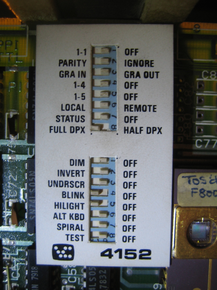

Some of the options. The most interesting was the first one: when 'off', the 'return' and 'enter' key only perform a carriage return, so the cursor moves back to the beginning of the SAME line, and only 'line feed' advances a line, but then (ofcourse) without moving the cursor to the beginning of the new line.
Very confusing for a modern typist, but setting that first switch to 'on' takes care of that by inserting a 'line feed' after each 'enter' or 'return'...

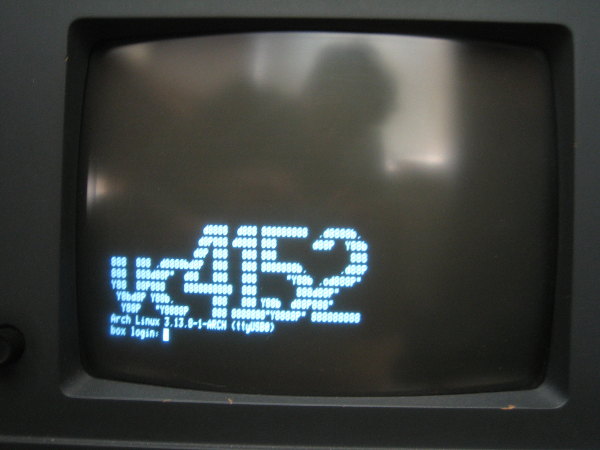

it was interesting to find out how to connect such a terminal to my computer; I'm not an expert in such things at all !
first you need plenty cables and converters to go from 25 pins serial female to 9 pins serial male, you need a 'null modem cable', which allows direct connection between terminal and host (bit similar to twisted ethernet cables, if you ever used one of those), and a serial to usb converter.
In Linux, it is still rather common to have a real console (which is something else than a terminal / console emulator program that runs in a window under a window server), and essentially the only thing I had to do is to tell my system to also start a console via my serial-to-USB- converter and to tell it that that connection is secure.
The first thing is accomplished (in Arch Linux) by having a 'service' that looks for terminal-like behaviour on the right serial port, a small file which looks like this and which is named 'serial-getty@ttyUSB0.service':

ExecStart=-/sbin/agetty -I \012 -f /home/<user>/issuevc4152 -L %I 9600 vt52

I copied this from an existing template, and the only thing I had to figure out is this line
which specifies the baud rate, some options and the terminal type, 'vt52'. It took me quite a while to get to that point though, and without the help on the Arch linux forum I would not have managed.. I find it great that all these old terminal descriptions still exist in Linuxland and that they are still part of pretty much any Linux system. It is sort of funny to switch on this hulk that smells like old electronics, instead of opening a terminal window. And text-only web browsing is a relief in a sense: no distractions !

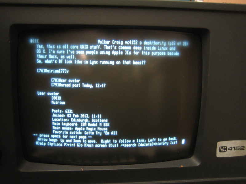

So, what's DT look like in Lynx running on that beast?
nourathar
03 Apr 2014, 17:56
mr_a500
03 Apr 2014, 18:02
nourathar wrote:Image
I can see what you're doing on the screen. It looks like you're booting up the Nostromo!

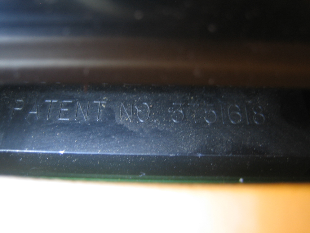

Interesting observation about the patent — I wonder if any other unidentified keyboards have that, but no-one's noticed?
What's up with the blank key to the left of Caps Lock? There's some sort of mini Cheerio or something inside the slider.
Also, a new design of latching switch. It's waffle frame plus the arm from the flat-top switches.

I was exploring the riches of pure ascii for a while, and one game that works really well in such an ascetic mode is Go.
'telnet igs.joyjoy.net 7777' gives access to a super lively community of Go-players on all levels. And there's quite a few more graphic looking games too.
Muirium wrote:Oh man, I like the look of this! Both reading DT and navigating a space barge full of longpigs…
I'm also a complete sucker for this.. and I suddenly had memories of the time that telnet (and even gopher) were still an alive part of the internet. All that stuff still works, but there are hardly any gopher or telnet sites left, which is a pity..
After a while the slowness of the terminal starts to bug me though: for some reason I haven't been able to get it to work at the highest baudrate it can handle, and that would help..
And lynx is sort of troublesome for modern sites like deskthority; you have to wade through quite a long list of useless links in order to get to some substance..

so I made this login screen:
Daniel Beardsmore wrote: Interesting observation about the patent — I wonder if any other unidentified keyboards have that, but no-one's noticed?
On waffle frames it would not be possible to put a patent number there, and the only relevant keyboard I have in this respect is that DEC vt100 I posted earlier. The patent number is not particularly hidden, so I doubt it has been overlooked in similar boards.
For the blank keys, they put an isolator around one of the 'hands' of the switch; I don't know what they are trying to prevent there, and it is easy to remove.
I guess you are right about the latching switch: it is indeed a different kind of mechanism, I did not actually notice that !

Daniel Beardsmore wrote:What's up with the blank key to the left of Caps Lock? There's some sort of mini Cheerio or something inside the slider.
It's not uncommon to see blockers on the blank key. See, for example a similar one under the blank key of this microswitch keyboardImage
tlt
05 Apr 2014, 07:16
Maybe they thought you should not be able to push a key that does not do any thing, a usability feature?
05 Apr 2014, 11:08
Makes sense. You can still get them for modern keyboards too. Nowadays it's to prevent admin access or the like. Back then, it was probably just to customise the keyboard to the particular computer model's needs. When all you had was a text display, you paid more attention to all those keys.

nourathar wrote:The switches are of the HiTek / Stackpole type that was very common in keyboards around that time. They are linear and this keyboard is more scratchy than some of the other boards I have with the same switch: that must be down to how it was used and stored.
I remember them as stiff and unreliable. One of the features of the UW terminal rooms was the notes on the blackboard indicating which keys didn't work on which terminals.

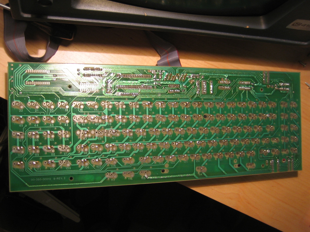

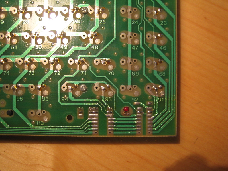

I managed to grab one of the VC terminal keyboards when I was at UW. I did ask around (2010) but it seems most of them had been disposed of at that point.
Volker-Craig KB-4412
It uses MEI WEAB switches. I don't think I've located a patent yet.
Yeah, I saw the pictures you posted of that board, and I was sort of disappointed to find out that this VC had HiTek / Stackpole switches since those are a lot more common !
