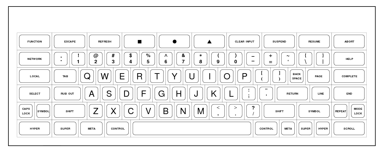

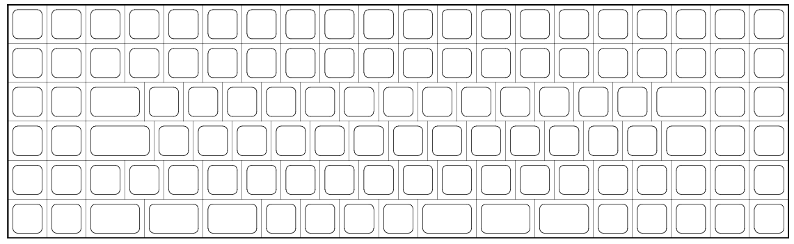

Top: PCB matrix
Bottom: Symbolics layout
- SymbolicsCloneMatrix.png (11.02 KiB) Viewed 32632 times
- SymbolicsLayout.png (28.5 KiB) Viewed 32632 times

This idea is ingenious!asciilifeform wrote:The solution to the PCB size problem is this:
One PCB per key.
This PCB should hold only:A larger microcontroller will be used to master the bus and translate signals from the many key units into the PS/2 or USB keyboard protocol.
- one keyswitch.
the cheapest available low-pin-count microcontroller (for instance, the PIC10F200, which comes in SOT-23 packaging!)
two small connectors for daisy chaining (simple one or two-wire bus)
two or more screw holes for anchoring to the baseplate.
Stamp these out in huge quantities. Each one is a key.
Transparent keycaps are available, under which users can place home-printed labels.
Result: anyone can build a true custom-layout keyboard.
I thought of components (5x2 and 1x8 or so). But your idea is brilliant in the way that you think more radical to reduce it to 1x1!
Every keyboard layout will be possible. No more whining over too long or too short keys!
Thanks a lot!
This will be the way we go.
asciilifeform wrote:One PCB per key.
Interesting, but before you get carried away will the cost work out better? Even in quantity you're looking at something like €30 per keyboard just for the controllers suggested? PIC10F200 @ Mouser Electronics Of course these are typical inflated EU prices so you can probably get the cost down a lot by buying from somewhere else?7bit wrote:This idea is ingenious!
It's a very promising concept to supply hobbyist builders, maybe there is potential to mass produce enough to bring the cost to a modest level.
