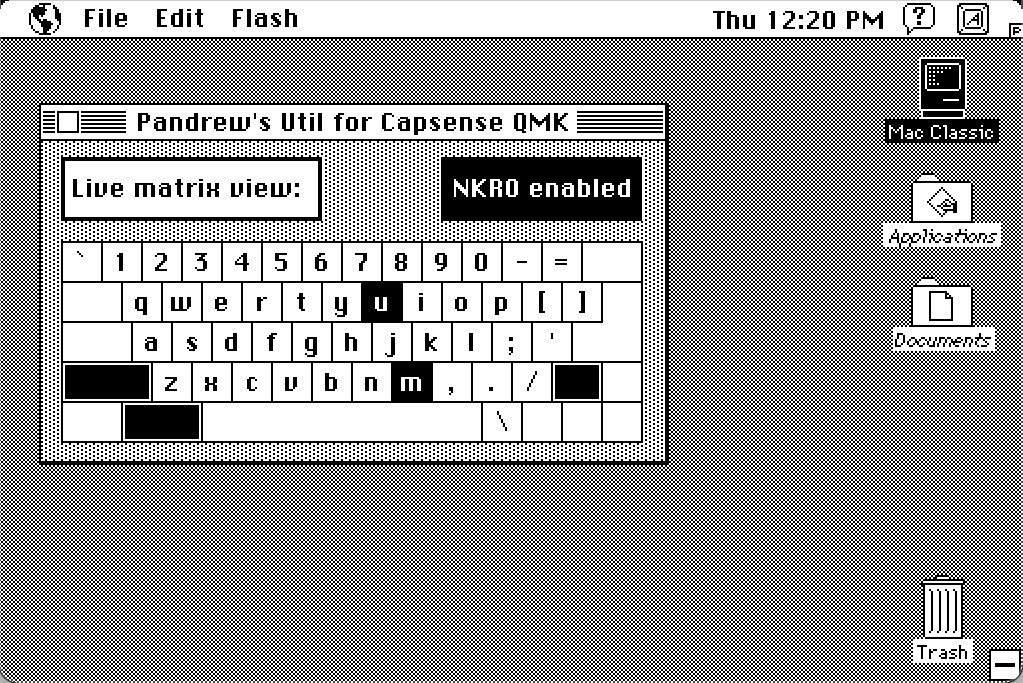

I already mentioned my PowerBook G4. Let's raise the stakes with a 4th architecture:
A cookie if you can get it running on 68k! :lol:
Pandrew's 68k.png (7.64 KiB) Viewed 138847 times

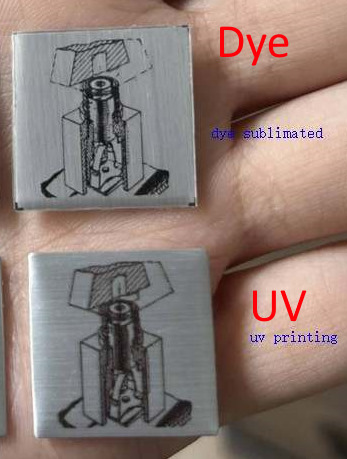

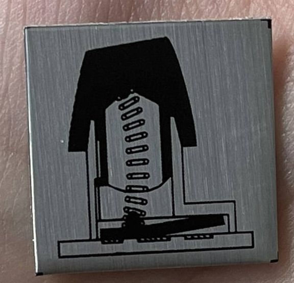

I have just approved production of the dye sublimated badges. Almost no factories I asked even had the capability of dye sublimation to aluminum. They tried the UV printing option which was fine on its own but a bit fuzzier when compared directly to the dye sublimated option, as shown below. Now available to order here:
https://www.modelfkeyboards.com/product ... ng-extras/
On the production units, there will be no alignment marks and the brush marks will be horizontal like on my original IBM F122 badge. Also the sample edges appear slightly curved as they were not stamped/cut clean like with the production badges but they appear to have been cut by tin snips or a similar tool.
Also the beam spring badge images look slightly blurry because they left the protective film on the sample for the beam spring badge photos. They removed it for the Model F photo.
Another change is that they said they will not crop the bottom of the beam spring image. I initially thought it would be better cropped before the edge, but the gap just looks a bit out of place.
2023 09 10 badge samples (4) - Copy.jpg (79.57 KiB) Viewed 138558 times
2023 09 10 badge samples (1) - Copy.jpg (49.73 KiB) Viewed 138558 times

Supports pandrew's diagnostic utility which has the Signal Level Monitor and Enter Bootloader features (you need to download the latest version which is found in the manual)

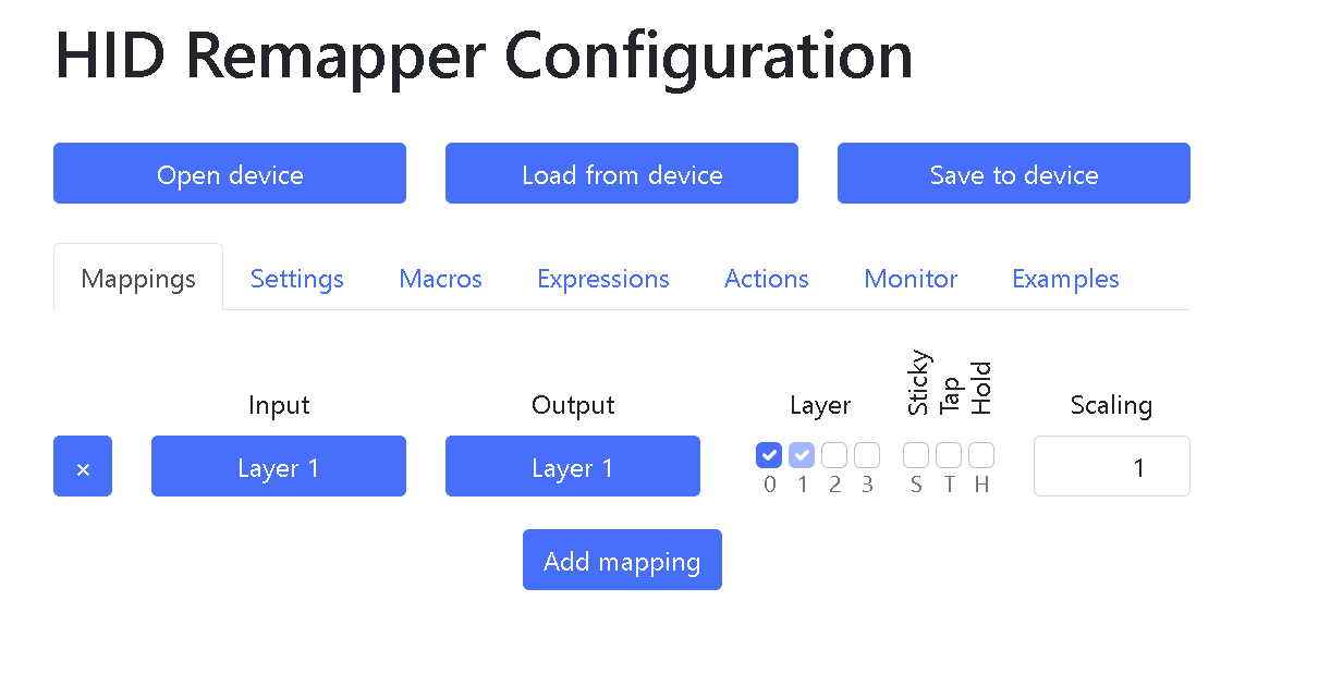

hid-remapper current testing results:
hid-remapper is correctly passing through both keyboards' keypresses, but I do not know how to configure it to pass through the MO(1) layer key. Here's what I tried. I also tried with the Hold field checked.
The single pi pico version did not work. The dual RP2040 version worked so that is what I expect to order from JLCPCB: the v1 board here https://github.com/jfedor2/hid-remapper ... tom-boards
I tested with a USB 2.0/3.0 unpowered hub that cost a few dollars on Amazon and it worked fine; I expect to order these on AliExpress for all 50 split ergo boards. https://www.amazon.com/dp/B0C7NPS5Y9
I also tested a Plugable USB 2.0 only hub with and without external power and it worked fine. An Anker USB 3.0 only powered hub did not work.
The only oddity for all of the working hubs I tested was that you have to leave the second keyboard unplugged when you are plugging in everything else (the PCB, hub, and one keyboard). Then wait a bit and plug in the 2nd board and everything works fine. A little annoying though, but again this is only for those who want to share function layers between boards (for example, press Fn on one keyboard and a key on the other board). As noted earlier, if you just want to press Ctrl on one board and S on the other board for example, you don't need to do any of this and you can just connect both boards directly.

Ellipse wrote: 11 Sep 2023, 23:55 hid-remapper is correctly passing through both keyboards' keypresses, but I do not know how to configure it to pass through the MO(1) layer key.
I attempted to explain this in a PM but I'm not sure I explained it very well.
This will never work. Period. If somebody told you that this was possible, then they were confused. And if you asked the hid-remapper project lead about this and he answered that it would, then either he didn't understand your question, or you didn't understand his response. Or both. Either way, I think you were talking past each other a bit.
MO(x) keys in QMK do not generate scancodes. Pressing MO(x) + some key stored in that layer *internal* to the keyboard will generate a scancode, of course, but pressing the MO(x) key all by itself will not.
Even if it did, there is no provision for one keyboard half to be able to "talk" to the other keyboard half when they are both plugged into a common hub sitting behind the hid-remapper. The two keyboard halves are completely unaware of each other, and can only talk to a single common host, not to each other. Thus if you have a MO(1) button on the right half, you can't hold it down and then expect to press a key on the left half & have it register whatever is internally programmed using Vial into that key on layer 1 of the left-side board.

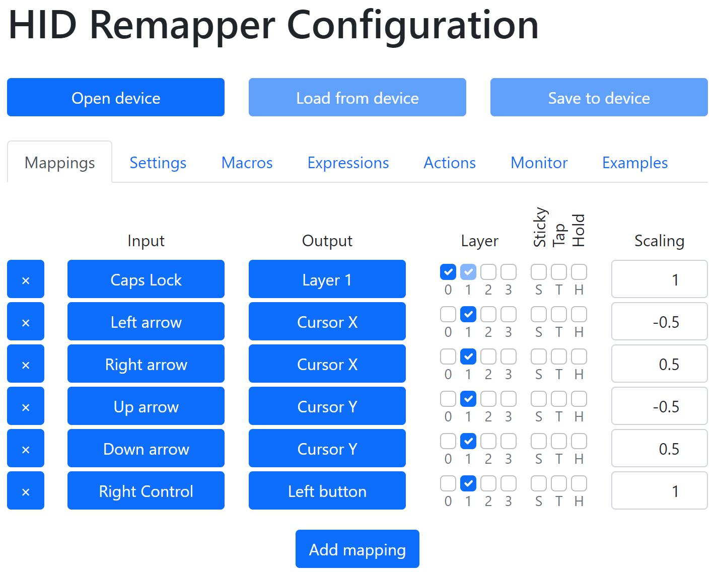

I believe the way that this is expected to work is that the hid-remapper has its OWN set of layers that you program into IT. So the "layers 0/1/2/3" that the hid-remapper interface is referring to is talking about layers inside the hid-remapper's memory. It's NOT talking about the layers that Vial/QMK knows about. Those are two separate things.
So when you are using two QMK-based keyboards plugged into a hid-remapper, you actually have TWO completely different & separate sets of layers to think about:
  1. The native QMK/Vial layers, one per keyboard, which are internal to just that keyboard and which the other keyboard is not aware of & vice-versa. Also, the hid-remapper is not aware of QMK/Vial layers, either, and has no way to be able to trigger them.
  2. The layers that you program within the hid-remapper that would then be common between both keyboards, but are controlled wholly by the hid-remapper (the keyboards are not aware of these layers; the hid-remapper takes care of implementing this itself before passing the scancodes to the host computer).
In the screenshot of your config, you show mapping "Layer 1" to "Layer 1", as if the hid-remapper can pass a layer selection from one keyboard to another, which again isn't possible. This just turns out to be a nonsense configuration that the hid-remapper interface allows you to configure, because it happens to give you the same options for "Input" and "Output" and won't stop you from picking the same thing for both. But that configuration effectively does nothing.
If you want an example of how to configure a shared layer using hid-remapper, you can go to the Examples and look at the one titled "arrows act as mouse when caps lock held". First, you have to pick a key that actually generates a valid scancode when pressed to use as the layer select (so can't be a QMK MO(x) key); in this example, Ctrl. You set that key as the Input, and then for Output, you pick the hid-remapper layer # that you want that key to trigger when held. So now holding Ctrl down acts as the Layer 1 select key for hid-remapper Layer 1 (again, NOT QMK/Vial layer 1! completely separate!!!). Then for the keys that you want to trigger particular actions on that layer, you select that key as Input, make sure to select the appropriate layer checkbox on the right for that key (in this case layer 1), and then for Output you select the action that Ctrl+that key should trigger. So now Ctrl+Left moves the mouse cursor on the X axis by -0.5 units. And so on.
The only way to actually share QMK layers between split keyboards is to wire the two keyboard controllers directly up to each other, and utilize the native provisions within QMK to support split keyboards. In which case the split keyboard would only have one cable going to the host computer & it would appear as a single keyboard to the host without the need for a hid-remapper-like device.
Ellipse
12 Sep 2023, 02:43
Thanks for this explanation NathanA, very helpful. So as to avoid using a key that would potentially have a use within certain programs (for example, Ctrl + Left Cursor moves the cursor by a whole word when editing text - I know it is just the example here - and using this sample setup would possibly eliminate that text editing functionality) I guess the trick would be to set the key in each Vial configuration not to MO(1) but to a rarely-used key recognized by QMK as a key press sent to the computer but that won't do anything on the computer, so that the hid-remapper could recognize it, and program each Layer 1 intended function in hid-remapper. For example, special key + D to send the mute command. Which keys would work best?
The down side would likely be a loss of internal QMK layer built-in functionality unless another key is set to MO(1) in Vial?
Also if it has to send a scan code anyways to the computer, it seems that a software-based remapping solution would be much simpler and have the same functionality compared to this hardware solution for what we are looking to do?
NathanA
12 Sep 2023, 06:41
Ellipse wrote: 12 Sep 2023, 02:43So as to avoid using a key that would potentially have a use within certain programs [...] I guess the trick would be to set the key in each Vial configuration not to MO(1) but to a rarely-used key recognized by QMK as a key press sent to the computer but that won't do anything on the computer, so that the hid-remapper could recognize it, and program each Layer 1 intended function in hid-remapper. For example, special key + D to send the mute command. Which keys would work best?
Yup, either that or pick a very not-often-used key, or at least one that a particular user doesn't find that useful to them. One example might be code 0x65 "Application" (e.g., "the right-click key"), which I feel like not too many people actually use. Or maybe 0x39 Caps Lock. :P
It is somewhat unfortunate that it doesn't look like the hid-remapper interface allows one to specify arbitrary, raw keycodes...instead you can only pick from a predefined list. Maybe a feature request to make to the hid-mapper developer? Because then you could pick some keycode ID that is unassigned, and program Vial to send that keycode, and the hid-mapper to listen for that keycode. For example, it looks like according to the USB HID spec that 0xa5 through 0xaf are unassigned/"reserved". ...ugh, scratch that: looks like QMK went ahead and assigned those to Power/Sleep and Volume/Audio controls. Likewise, all of the ones at the end from 0xe8 - 0xff are assigned to Mousekeys. But! It looks like 0xde and 0xdf are unassigned! So those are potentially open for use...
One set of keys that hid-mapper is aware of and that virtually no modern software does anything with is F13 through F24. I know people like to have those keys available on large 122-key models, but on split ergo boards with under 100 keys, it seems very unlikely that anybody is going to assign any F keys above F12 and actually use them for something. So maybe pick some F key above 12 to use as your hid-remapper layer key.
Ellipse wrote: 12 Sep 2023, 02:43The down side would likely be a loss of internal QMK layer built-in functionality unless another key is set to MO(1) in Vial?
Now you're getting it! Yes, if you want the hid-mapper shared layer, your choices here are either to give up a QMK layer key, OR to sacrifice up to THREE keys as layer-selector keys: two separate Fn keys (one for left, and one for right) for the QMK layer select, and then a third Fn key on either keyboard to act as your hid-remapper layer select.
Ellipse wrote: 12 Sep 2023, 02:43Also if it has to send a scan code anyways to the computer, it seems that a software-based remapping solution would be much simpler and have the same functionality compared to this hardware solution for what we are looking to do?
That is definitely a conclusion that I'm sure some people will come to. Heck, a few here already have; for example, Mu and his beloved Karabiner. ;)
The one potential advantage to a hardware solution like hid-remapper is that it doesn't require that you install and configure a software solution on every single computer that you might plug your split keyboards into. You can move your hid-remapper between different computers & it will always behave the same, without putting in additional work. Also, depending on which software solution you go with, a software solution can also have the potential downside that you might want your key remappings to ONLY apply to ONE particular keyboard, and not another. For example, if you are on a laptop, you might decide that it is okay to sacrifice Caps Lock on your split keyboard to do something other than Caps Lock, but you might still want Caps Lock to behave *as Caps Lock* if you press it on the laptop's built-in keyboard. Or maybe you sometimes use the split keyboard on a given computer, and at other times you like to switch over to a full-size keyboard, and you want the two boards to behave differently when used on the same computer. I don't think most software keyboard remapping solutions will distinguish between multiple keyboards plugged into a single computer in that way: to them, a Caps Lock press is a Caps Lock press, regardless of which keyboard it happened on.

Regarding key combinations: the boards use separate controllers that do not communicate with each other, which means that only keys with scan codes sent to the computer can produce key combinations. You can’t use internal QMK keys like MO(1) for cross-keyboard keypress combinations. This does not affect 99% of what most folks do. For example, you can click Ctrl on the right side keyboard half and click S on the left side to send Ctrl+S to the computer without doing anything extra. You can’t click a key designated as Fn or MO(1) on one half and another key on the other half, since the Fn key press is not sent to the computer but is only used inside the QMK controller.
Recommended option: use the built in tap keys functionality instead of the old function layers, or use that half of the board’s function key for function layers on that board. Tap keys example: you can set the 1 key to send “1” if pressed normally, or “F1” if pressed and held down for a slightly longer amount of time that you can customize. Included by default in the firmware – all you have to do is configure it.
Software remapping: AutoHotKey, Sharpneys, Keytweak on Windows. Karabiner Elements on Mac. xbindkeys, xmodmap, autokey, keyd, kbct, kmonad, interception, xmodmap, setxkbmap, xkeysnail on Linux. In Vial, set one key on each keyboard to an unused scan code (such as F13 through F24, 0xde, or 0xdf). Then in software you can configure a keypress combination of that key plus another key, in order to produce a specific output like volume mute, skip track, etc.
hid-remapper: based around using 2 Raspberry Pi Picos and a USB 2.0 hub. Both keyboards plug into this device and you can program function layers with it. It still has the above limitations (can only work with outputted scancodes) so it is only recommended if you cannot use the above software-based remapping solution. See the Deskthority forum thread for additional details and limitations of each option (no option is perfect).

In terms of getting both halves of the split ergo boards to communicate function layers with each other without software remapping or an additional hardware device like hid-remapper, the below idea was mentioned before as another possibility - would this be implementable?
"It can be done with scroll lock / num lock / caps lock. You would press one of those on one device, then program the other device to do something if one of those is pressed, such as layer change.
More info: https://www.reddit.com/r/ploopy/comment ... ball_nano/
Does it have to be a LED lock or can it be another key like F13-F24 or the two unused scan codes as discussed before? My thinking was that if you press and hold a num lock key that sends caps lock to the computer, it may enable the num lock functionality if you have a second connected keyboard that is full size and rotate keyboards around. Maybe they were suggesting a lock state option so that you could press and release the key, and then have a new layer as is done with the Num Lock and Num pad for example, but I would think that most folks just want to press and hold a key to activate the function layer temporarily on the other keyboard, only while the first key is held down.
Source: https://www.reddit.com/r/olkb/comments/ ... k_devices/
"There are a couple ways layer states can be communicated between QMK devices.
The simplest is for layers that have associated led indicators defined in the HID spec (Num Lock, Caps Lock, Scroll Lock, Compose and Kana). qmk feature_led_indicators 1. Any time the state of one of those keys changes, all usb connected keyboards receives notice. I’ve used this method to trigger layer changes and it happens virtually instantaneous. Scroll lock is convenient for this since the key has become unused. Scroll_Lock Other_uses 1. You can also program a qmk device to change layers only when an led indicator is toggled very quickly, faster than a human can tap.
Qmk also has the Raw HID feature which allows for bidirectional communication between qmk and the computer. I haven’t explored this myself, it would probably require the computer to actively relay messages between qmk input modules."
Source: https://community.frame.work/t/how-can- ... s/28812/11
