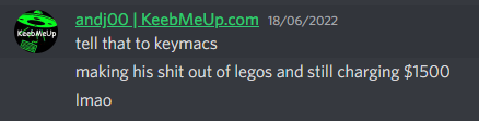

Posted: 22 Jun 2022, 20:09
by peter_pane
Insane work! I really respect every step you make. Insane craftmanship and I hope to hold one of your works in my hands someday. Thanks for your partaking in the community and beyond.
Sadly not everyone is as happy, so I'll just leave this here.
Re: Custom Polyurethane Keycaps by Keymacs
Posted: 22 Jun 2022, 20:36
by KeebMeUp
peter_pane wrote: 22 Jun 2022, 20:09 Sadly not everyone is as happy, so I'll just leave this here.
lol, cute you felt the need to create a new account just to bring my name up.
also, thanks for including the context of that conversation
ill just leave this here
