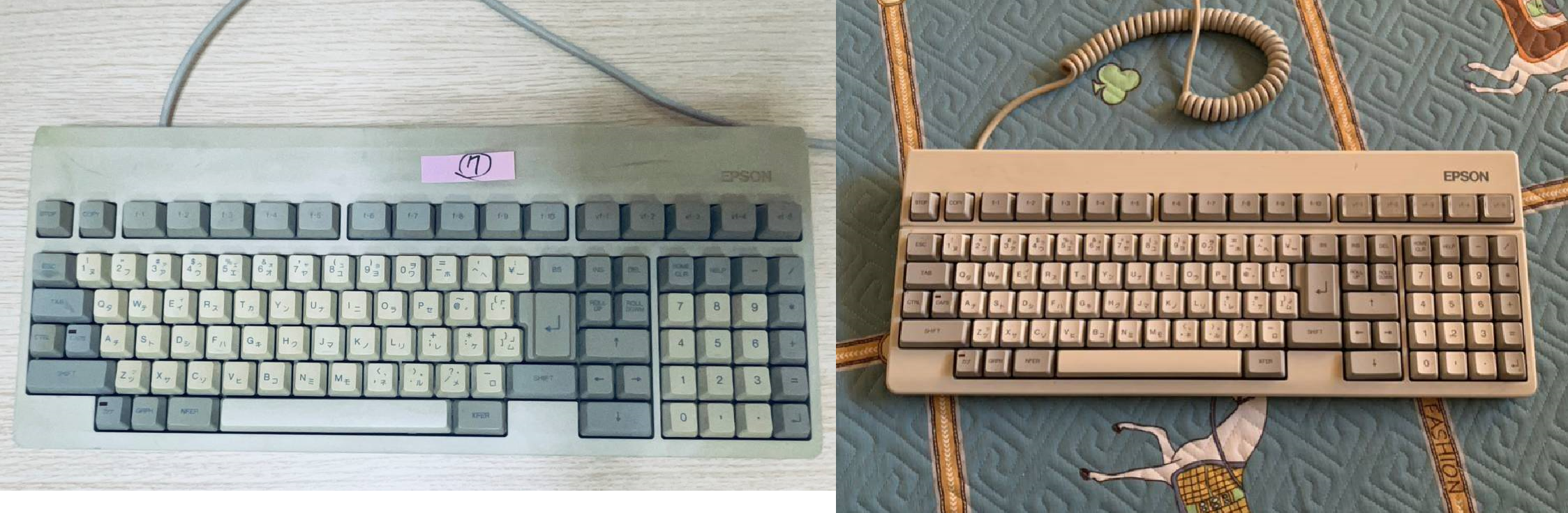

Hello everyone,
I recently found an Epson AP1003a with Alps SKCL Brown and likely an amber alps spacebar. Not exactly in new condition, but switches are quite smooth for the condition that the board is in.

Ok, some updates:
I found the Epson board in a warehouse, but I would prefer not to disclose the name or location of it. They had ton of Epson boards there, maybe 9 or 10 in total... I think this is the only alps keyboard out of all of them. I think they even had one of those Epson FLS gen 2 boards which was pretty cool, but I was only able to get my hands on this one.
The board was absolutely filthy when I got it.
Funnily enough, however, the mounting plate was completely clean and most of the switches are pretty smooth. After dusting off and cleaning the mounting plate, the plate looks awesome. Also found one switch - I think it's the E key - which has some pink marker on it. I'm pretty sure this is was DT wiki refers to as lipstick switch but I have no idea what purpose it serves or why it is there. You can see it in the picture. I have not taken the spacebar off to check out the spacebar, but I'm pretty sure its amber alps according to other reports.
I'm glad to report that with a Soarer's converter, all of the switches work properly! Weird that it has an AT layout but XT protocol.
From the same place, I got a few other boards, including a Omnikey 101, a Laser 2269 keyboard without the laser branding with SMK clicky MX mount, and a vintage SKCL green Texas Instruments keyboard. I think out of all the boards I got from that place, the Epson is the cleanest, though. Does anyone know if this board was built by Alps Electric? It looks nearly identical to the Packard Bell keyboard with SKCL Brown switches, along with some other alps-built keyboards like the OEMMAX MCK-860. The plastic clips on the back remind me of those used on Dell boards, but maybe it's a stretch. idk.

guidemetothelight wrote: 19 Jul 2023, 10:28 Is it possible to tell from the lock lights which switches are used ? location doesnt match alps switches as far as I know
Both boards look like they have the same style lock lights as that of Fujitsu Peerless keyboards, but I can't be for sure. While I was at the location where I got this board I found another Epson board which felt like it could have had Peerless switches, so it might be possible. From what I have heard, Epson keyboards are pretty rare.

hipower8-32 wrote: 19 Jul 2023, 22:10 Both boards look like they have the same style lock lights as that of Fujitsu Peerless keyboards...
agree, probably they are, or I would have probably found a post from a lunatic like us describing how they can come with browns :D
