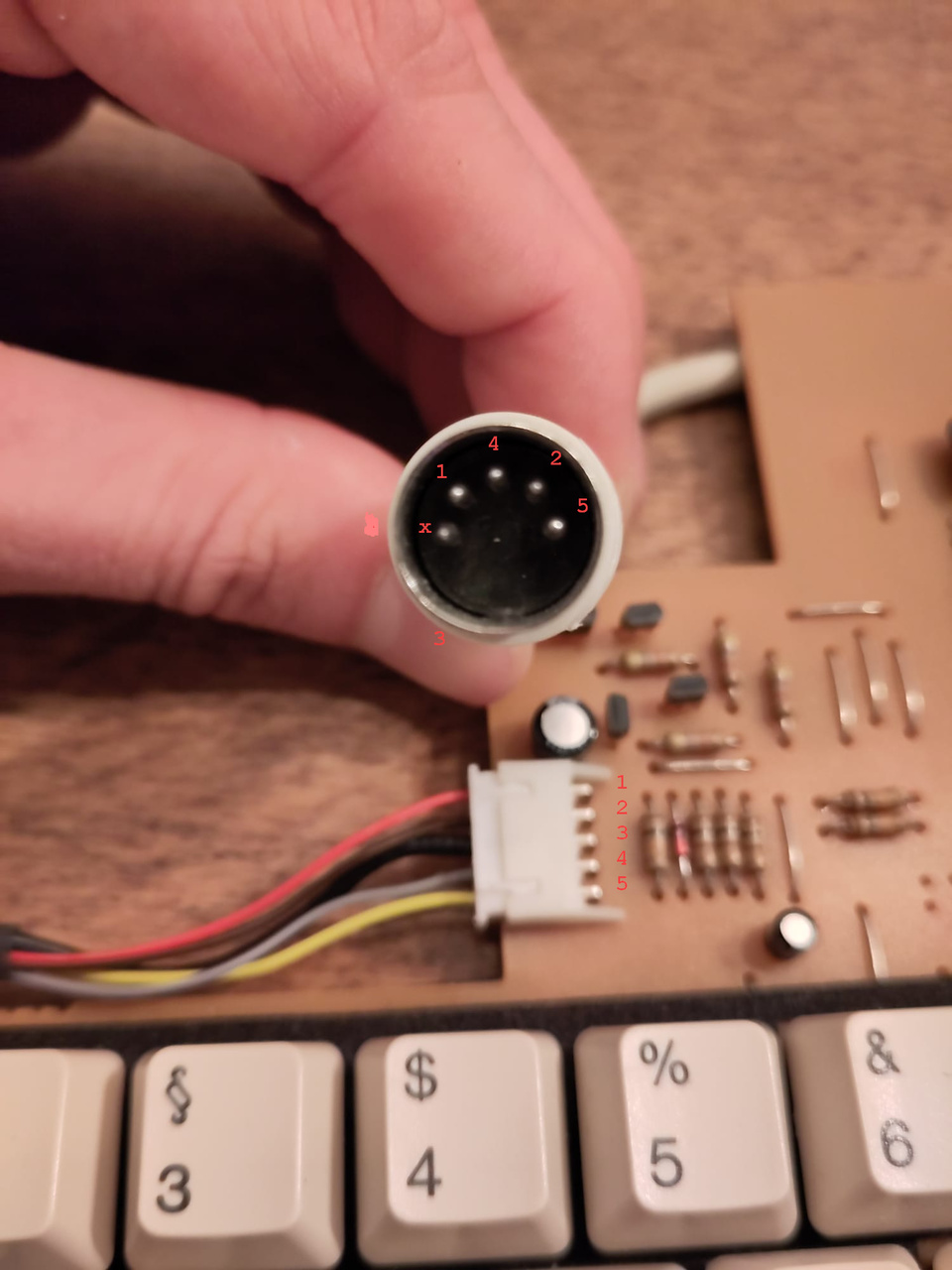

Yes, I can confirm it is XT. Here's a picture of the pinout:
Re: NEC Multispeed Alps Keyboard Conversion to USB
Posted: 06 Oct 2023, 00:21
by TNT
I just realized the way I positioned the three could lead to misunderstandings. The leftmost pin is unused

Dude, @TNT! You just saved me a lot of time and tinkering! Thank you! Do you have an XT to USB converter you'd recommend? Something like this maybe?

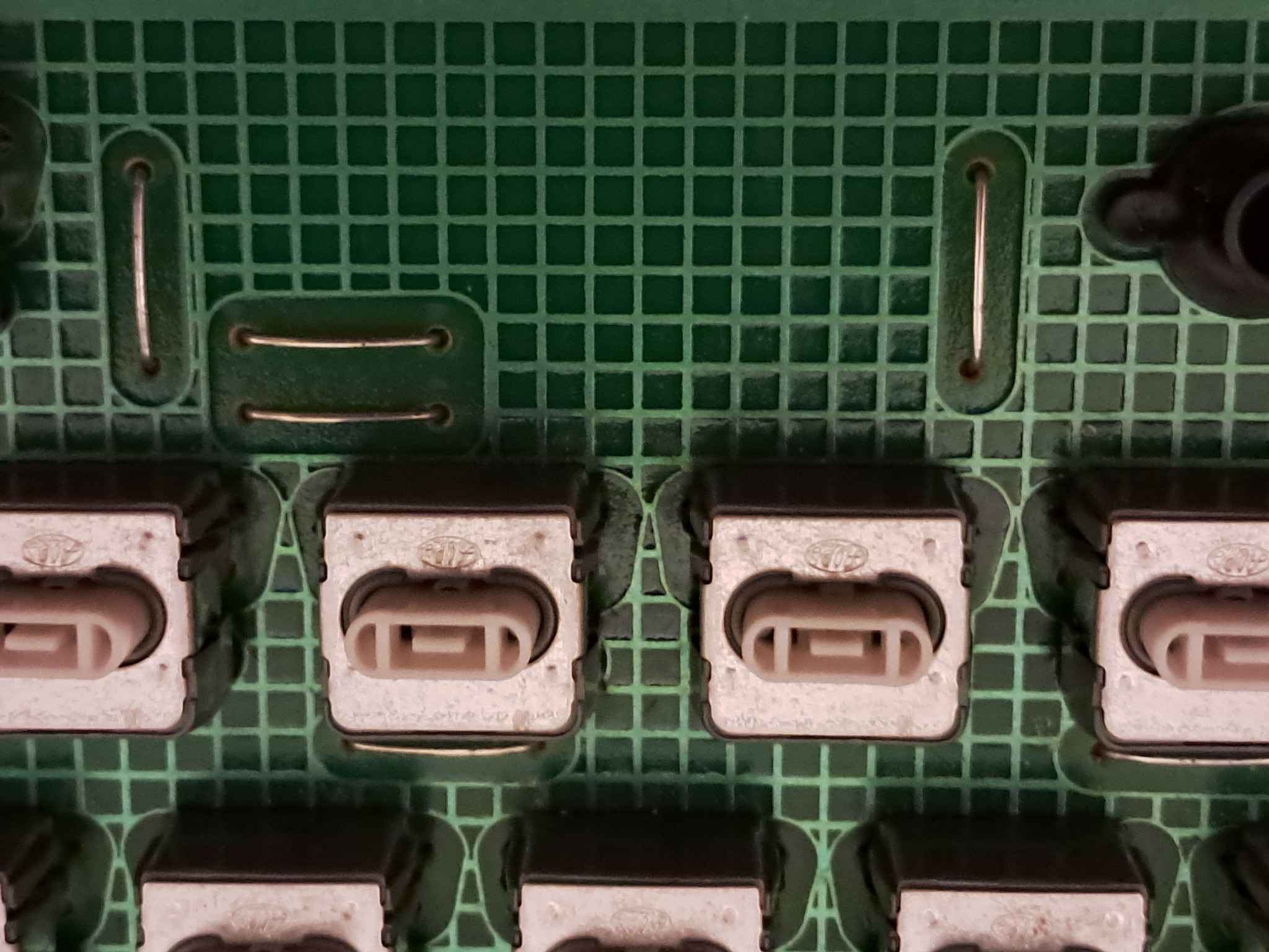

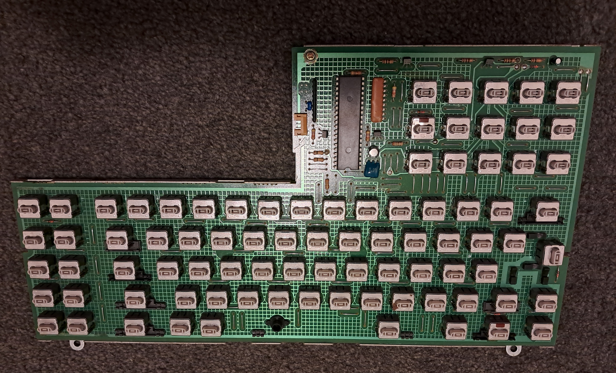

I've got the same keyboard, except for some reason the motherboard on mine is green and the shape of the board is a little different :
The key switches are Alps SKFL :

I managed to dig up the manufacturer's manual for it and can confirm that TNT's wiring is correct. In my case, I also wired up pin 3 (Reset). I don't know for sure if it is needed but I ended up doing that while troubleshooting issues I had getting it to work (which were actually my own fault) during a prototyping phase and left it in when I actually soldered up the converter anyway.
