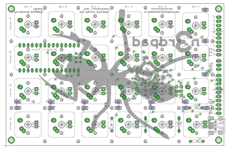

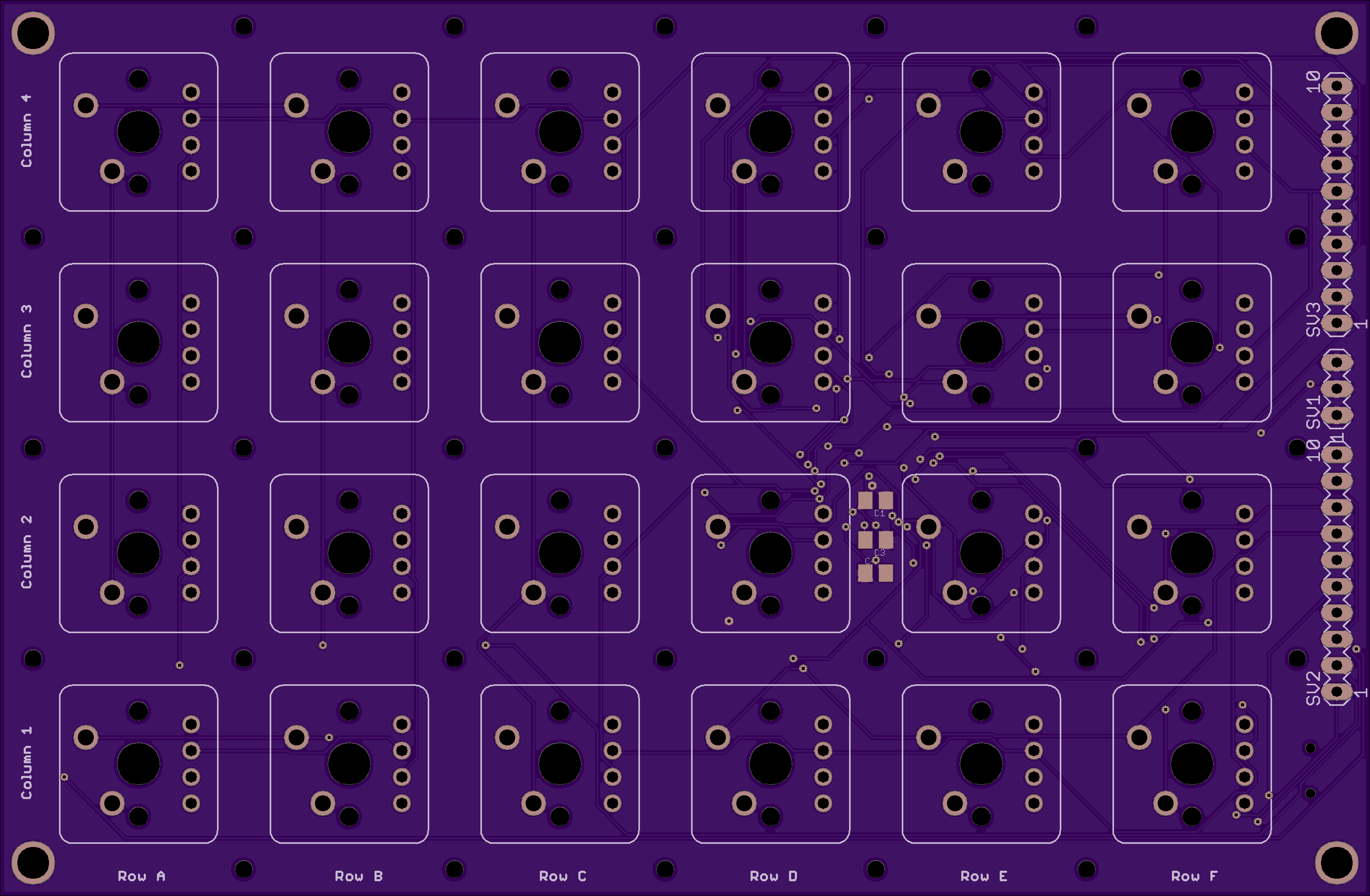

Hi there!
A friend of mine designed this awesome board as a successor to my attempt (https://aaron-fischer.net/pzx). It can be programmed with the TMK firmware and used as a additional keypad for all sorts of things.
Are there some interest in a GB (PCB only)?
I think I can do it for 10 EUR for the PCB + Shipping (which i don't know how much at the moment).

PCB only so no controller whatsoever soldered on? Or am I understanding this wrong?
Anyway probably interested if I don't have to solder the controller on myself

True, I only just saw that. There are solder pads for an Atmel controller there, but if he says PCB only it's probably not soldered yet...?

Just the PCB without the components and without soldering it on the PCB.
If there is any interest, I can calculate the cost for the components. for a small number I can solder the stuff on by hand.
The PCB can be used with or without the Controller. The complete keyboard matrix can also accessed from the pin header at the right to use it with other controllers like an Arduino or a RaspberryPi.

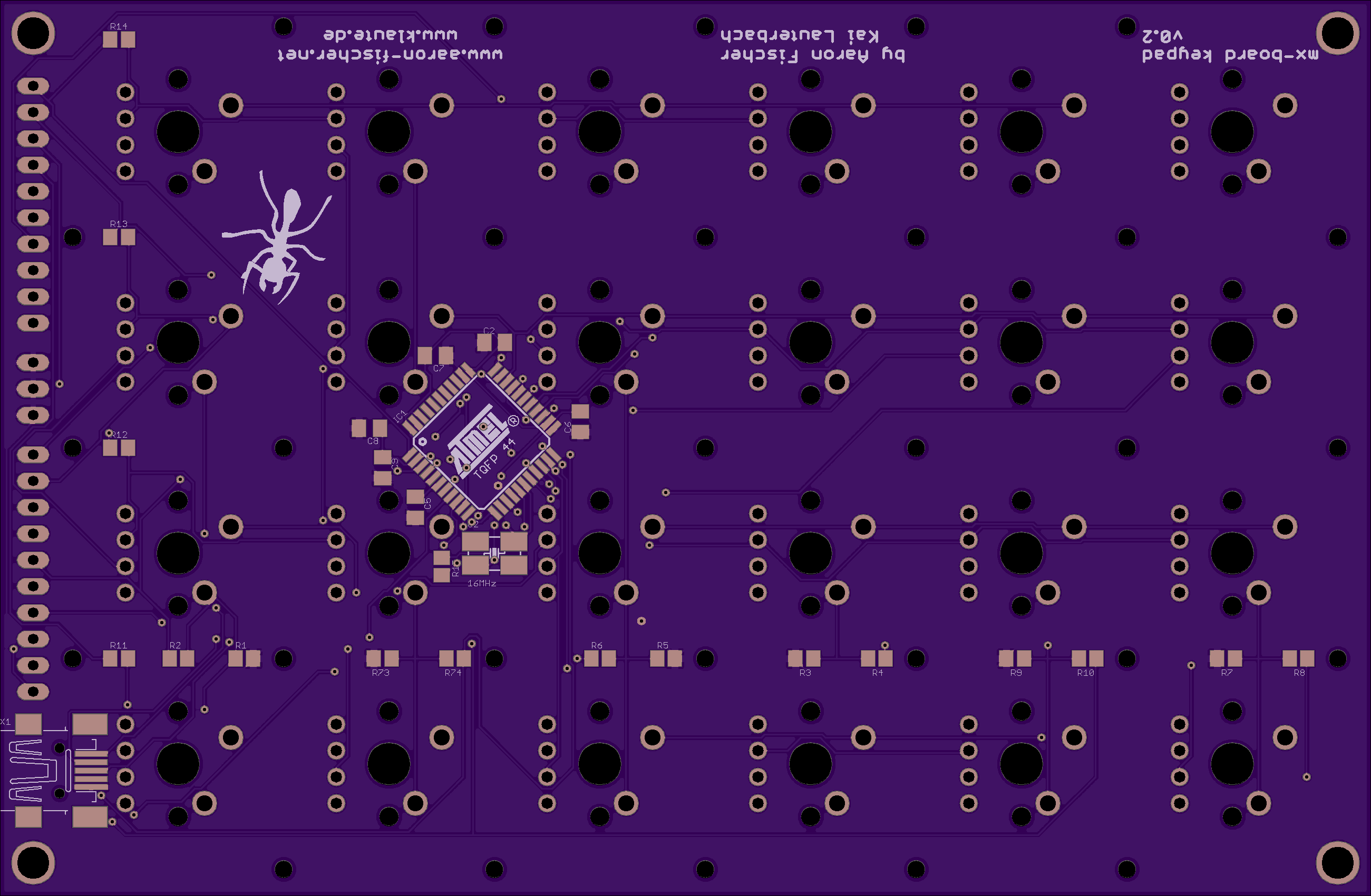

It is a tight fit for a Arduino Nano, but it is possible
With some solder pad switches the PCB can do 3 different "modes"
* Arduino Nano hooked at the bottom
* Soldered ATmega32U4 in place
* Pin header at the bottom/top for external use (you can hook up your door bell

Would it be possible to make the PCB alps and MX compatible like the Duck Eagle PCB? If so I would buy one.

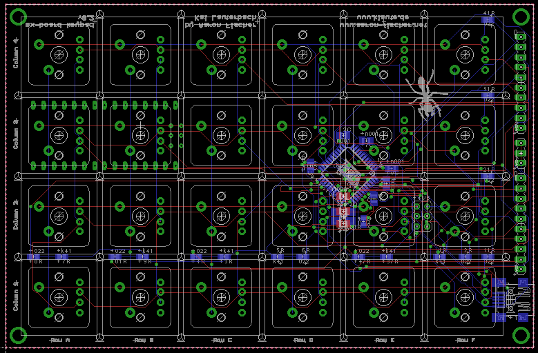

Sure, here is the Alps AND MX compatible board.
I also added some through hole components for the Arduino part, so the soldering will be easier in the arduino-configuration.

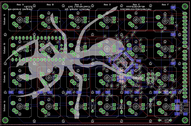

The price is still the same. the dimensions are 5.20x3.40 inches (132.11x86.39 mm)
I've modified the PCB a little, arrange some stuff and add some labels.
You can hook up a Arduino Nano. I can add one to the order for 4 EUR.
Remember: This project is still Work in Progress. the PCB is never tested before, a friend of mine and I will inspect the whole PCB several times to find (hopefully) all the bugs. But there is a risk that there s a minor bug which need to be fixed by hand.
Soldering jobs: Maybe ... I am not sure about that if I want to spend several days soldering SMD components or build a small "assembly line"
Manufacturing the PCB with a PickAndPlace Machine + Reflow is expensive .... :/
