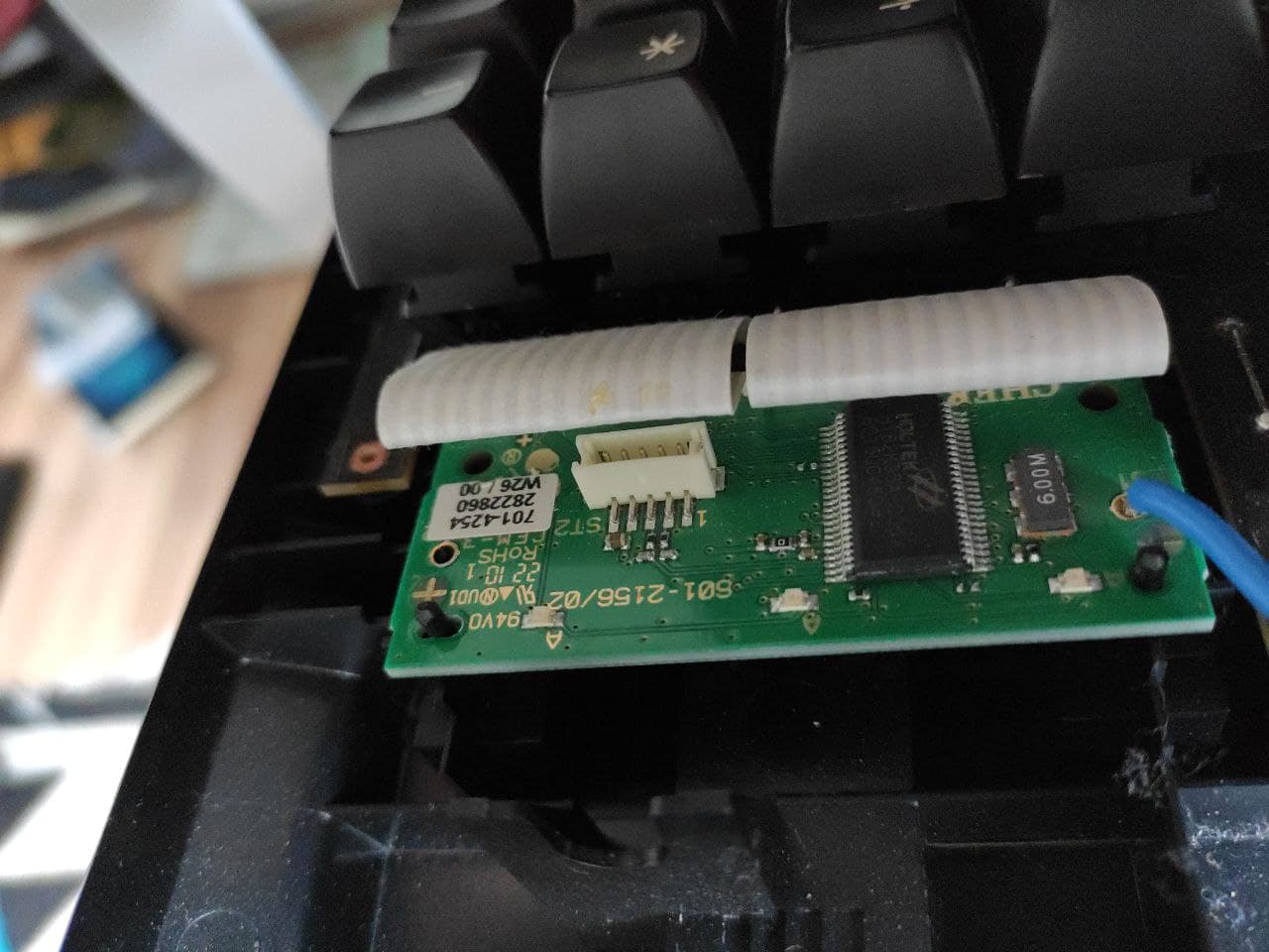

Hi there,
I have several G80 3000 keyboards (USB versions), but without a cable. I am wondering if I can just order these ones and be happy:
https://de.aliexpress.com/item/33021008 ... mainSearch
This is what the board looks like:
5pin g803000.jpg (101.62 KiB) Viewed 7655 times
I am happy for every help!
CeeSA
17 Feb 2022, 23:25
From what I could see, you need JST 1.5 connector. The linked cable uses a JST 2.0 connector.
This should fit:
https://de.aliexpress.com/item/10050027 ... mainSearch
You may have to change the pin arrangement of the wires (sort of colors).
https://www.techpowerup.com/review/cher ... ent/4.html
t!ng
Awake Sheep
17 Feb 2022, 23:37
Perfect! Thanks a lot! Will keep this thread updated.
CeeSA
18 Feb 2022, 10:06
My Raptor K1 is using a JST 1.5 like assumed. The socket looks 100% the same. So 3000 and 1800 are using the same and you could go with an replacement cable for a Logitech G500 mouse.
