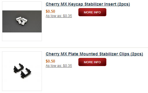

Posted: 08 Oct 2012, 12:31
by Half-Saint
What I mean is that the hole for the switch is much bigger (wider) than the switch itself.
I'm asking about the costar stabilizers because I don't have them here yet and just by looking at the image, it's not at all logical how those two parts fit together.
The white 'things' look like normal Cherry G81-3000 stabilizers which you can pull out of the keys...
Posted: 08 Oct 2012, 12:39
by HzFaq
The black bits clip into the plate and are connected by a bent bit of wire. The white inserts go into the cap and are hooked on to the bent bit of wire. It will all make sense when you have them in hand.
Like this?
I guess it's to allow for different spacebar's to be used (some have odd stem spacings).
Posted: 08 Oct 2012, 12:47
by Half-Saint
OK but am I right about the white inserts being the same as in G81-3xxx boards? :-)
