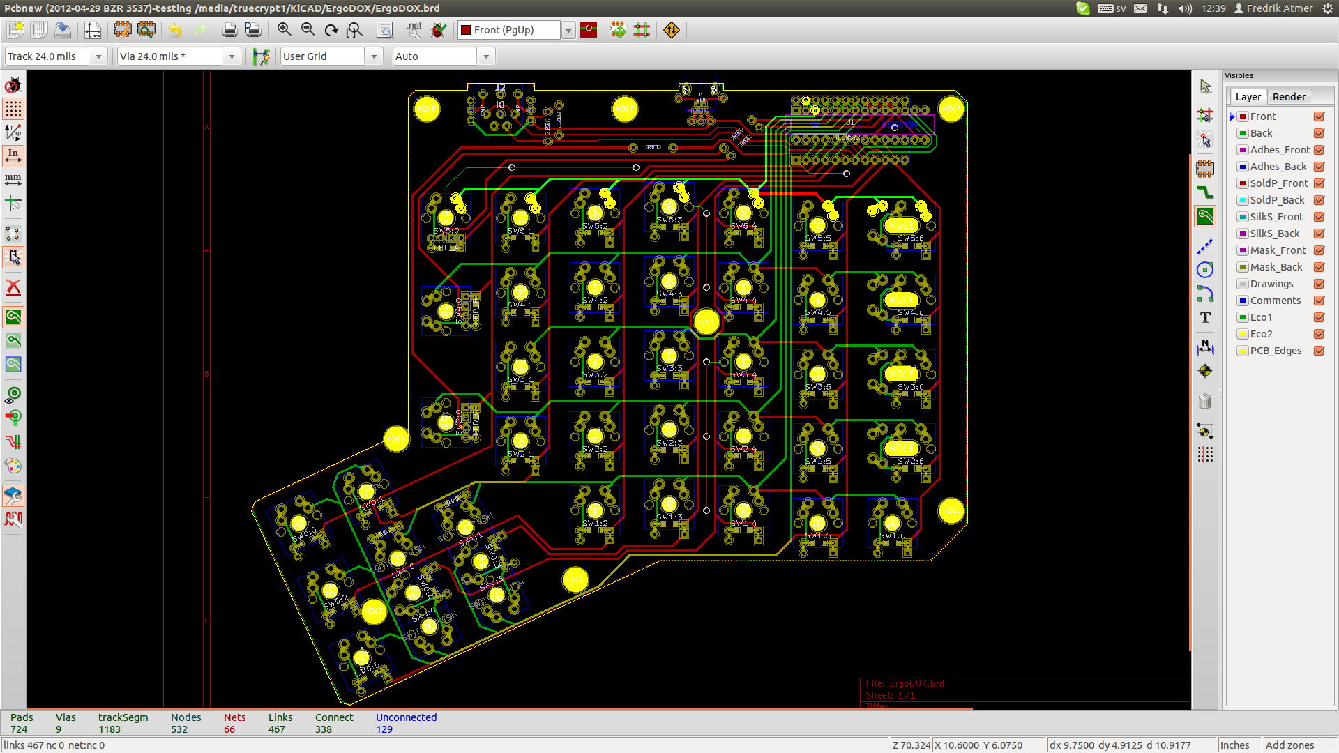

Posted: 15 Jul 2012, 12:45
by bpiphany
I think I'm pretty much done with the layout and routing \o/ Only some cosmetic things left, like silkscreen component references and explanatory text on how to fit components on the different sides of the PCB.
Side note: ASCII file formats are nice. It's hard drawing traces with slopes in anything else than 45° intervals. So I drew the thumb section in a straight layout. Extracted the track info from the KiCAD board file, rotated all their coordinates in a spreadsheet and edited them back into the KiCAD file =D

by Parak
Neat, being able to have gerbers and a single flipable pcb will substantially lower the cost. I'd suggest sitopway for fabbing as I've used them for prototype and small volume pcbs with pretty good results. I think I might still get one even though I've shifted over to buckling spring experiments :D

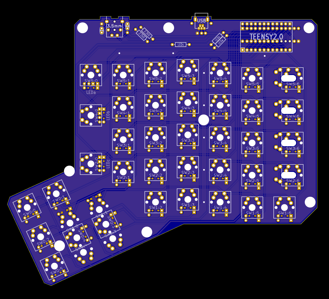

Posted: 17 Jul 2012, 17:33
by bpiphany
There, that should do it I think. Some text and credits printed on that and that is all.
Posted: 17 Jul 2012, 17:57
by Merijn
So... are we almost ready to mass produce the pcb? :D
