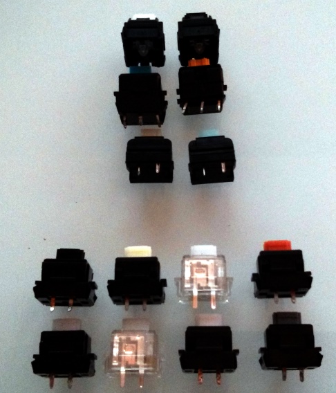

A few people were asking about compatibility with ALPS. I got a bag from Mr Interface a couple of weeks back and as far as I can see:
Bottom two rows show genuine ALPS CM (black, orange, cream, whites and grey) mixed with the two clear Matias switches and match in terms of pins & switch size.
From the top:
Acer white and black wouldn't fit plate (too small) and mine don't have any pins.
KBT blue and Omicron orange look like they'd fit a plate but are three pins more spread out so wouldn't fit PCB.
Unidentified white clone and Montery blue would fit PCB but too small for plate compatibility.
Hope that helps,
[)amien

damieng wrote:Unidentified white clone and Montery blue would fit PCB but too small for plate compatibility.
SMK (Alps-mount) tactile and clicky respectively. (Also "KPT" and "Omron" — too bad the kit doesn't come with a description of what everything is.)
