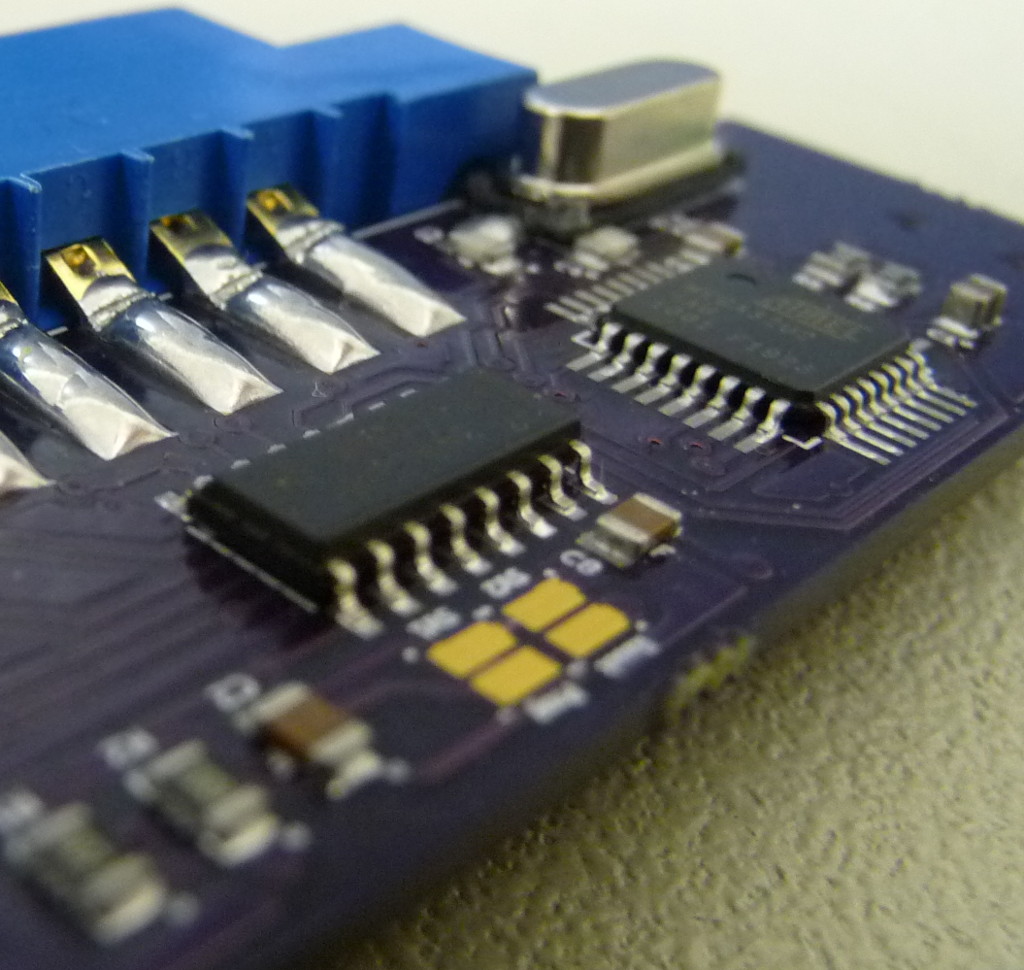

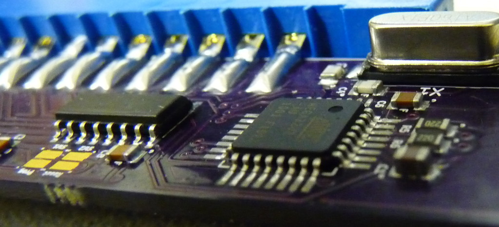

Ah yes and I thought I'd show off my first reflowed board. All the 0805s straight and flat, nice heel and fillet, all the things I wish I could do when soldering by hand! I think on the next redesign I might have to make a move to a board with all the components on one side so I don't have to do double-sided reflow (i.e. reflow one side, then flip it upside down for the other side and hope the surface tension of the molten solder is enough to hold the components on against gravity—this actually works to my amazement!).
Apologies for crap photos, work point-and-shoot has no macro mode and my M3 only focuses down to 1 metre lol (never mind the Tri-X grain being a similar size to the 0805s :) ).

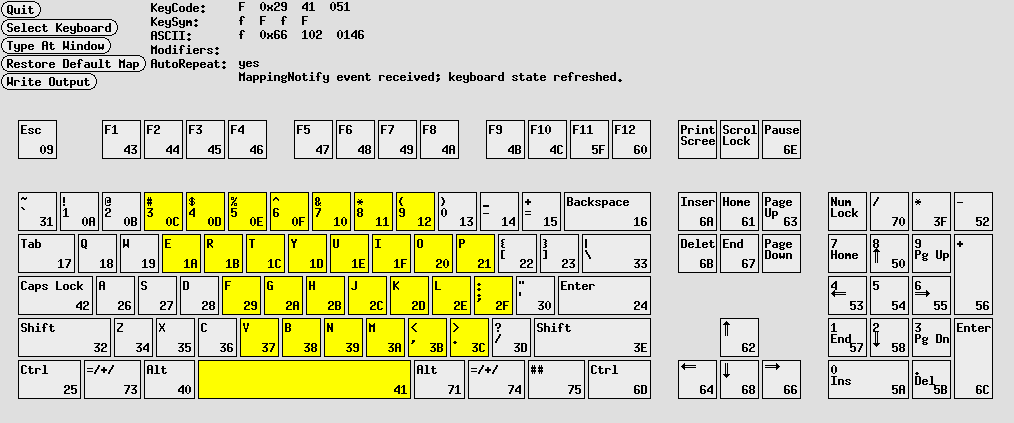

1) Most keys work, but a lot, maybe a third of them, don't work reliably. You either have to press them for a second or more before they react, or the break signal is slow. This probably has to do with calibration of the threshholds, but it also happens after autocalibration in the USB tool.
2) the leftmost column of keys (column 1 in the tool, F1/F3/F5/F7) doesn't work at all. I can sometimes bring the F1 key to register by pressing it really long, but most of the time even that doesn't work, and the other three never work. Can I look up somewhere which pin this column corresponds to on the controller connector? Do the columns and rows on the USB tool correspond to electrical coumns and rows on the board?

The non-working keys are probably down to the autocalibration not really being accurate enough. You can manually adjust the threshold up (I think you'll want to be increasing it) until you get all keys working reliably. However I suspect that as you bring the threshold high enough to get the other keys to work, you will find one or more other keys appearing to be pressed even though they're not. This will be why the autocalibration is failing—it adjusts the threshold until all the keys `settle down'. Likely these keys will have some dirt flaky contamination layer or something on the sense pads that will need cleaning, it's happened with a few people.
Yes the rows/columns in the GUI util correspond to the rows/columns on the keyboard if you were going to strip it down.
