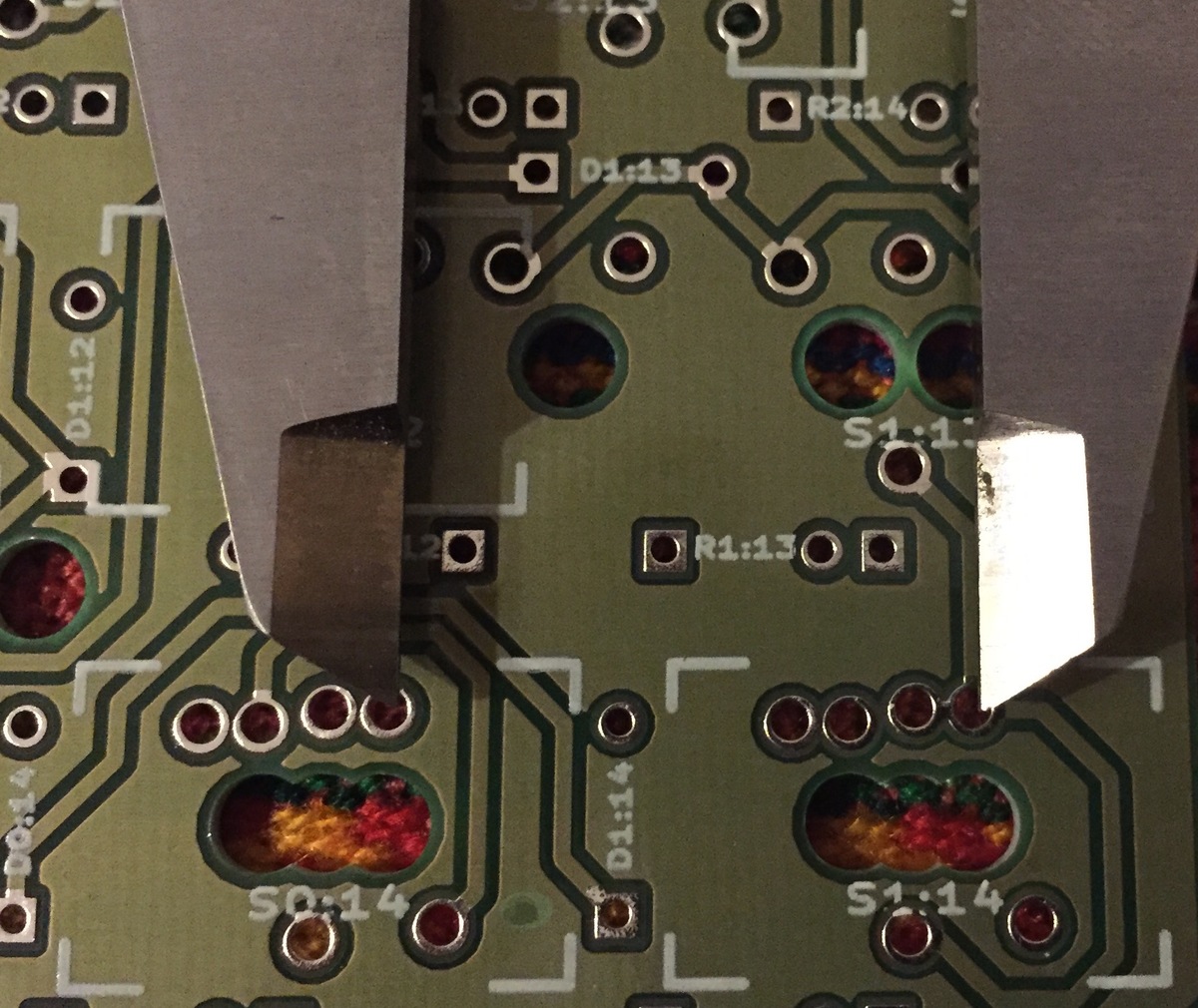

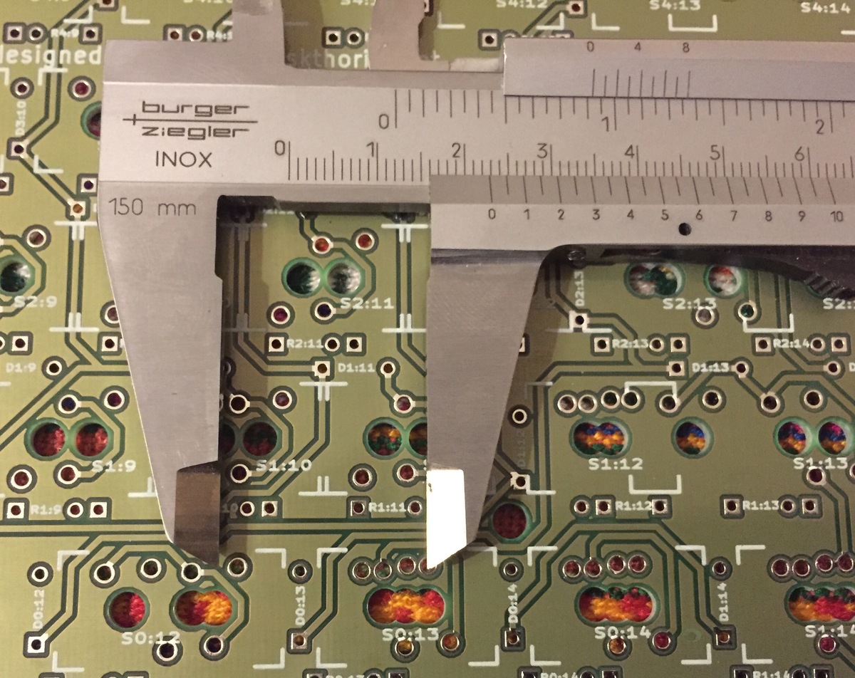

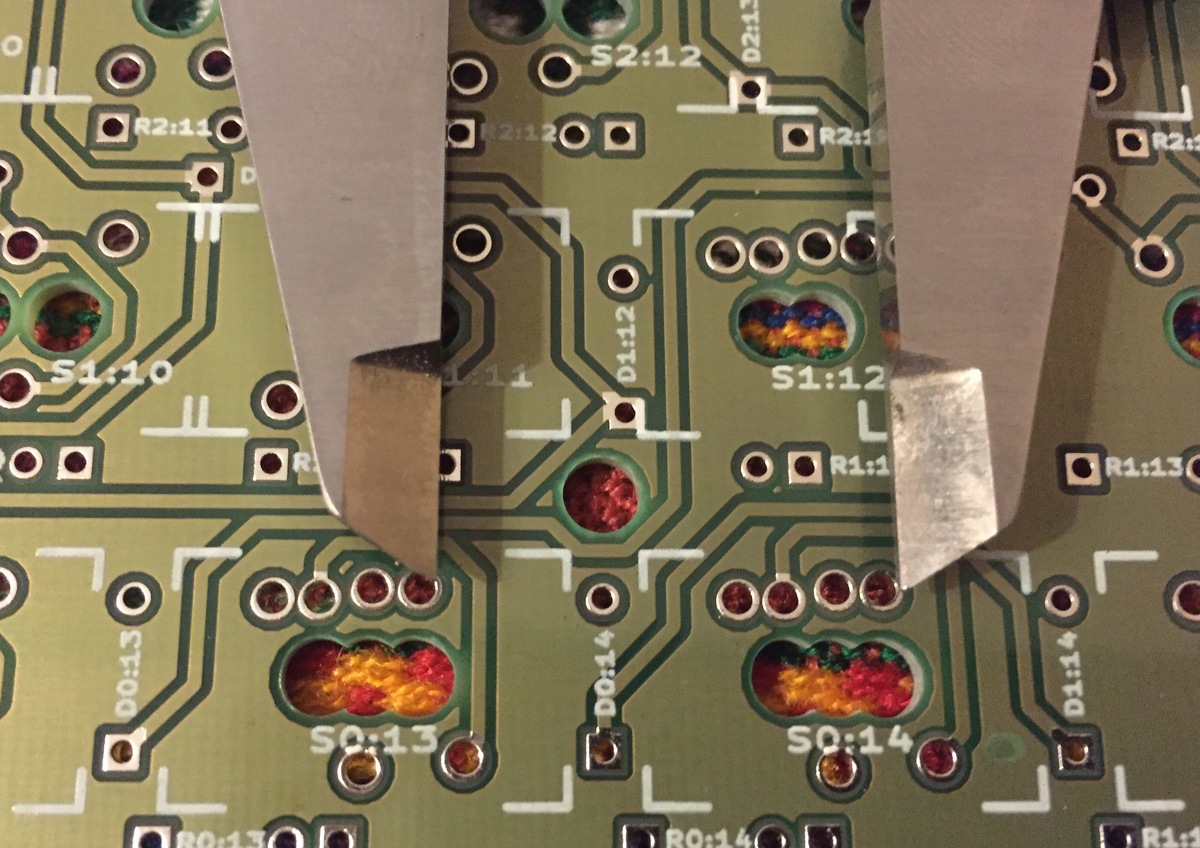

(a) With the cherry board my bottom row setup is 1.5 | 1 | 1.5 | 7 | 1.5 | 1 | 1.5 = 15
(b) In the case of the APSs I was thinking to get an standard 104 keycaps set like this one
https://www.massdrop.com/buy/alps-keyca ... romotional
From the picture I can see that the row would be 1.25 | 1.25 | 1.25 | 6.25 | 1.25 | 1.25 | 1.25 | 1.25 = 15
If I use 19,05mm as 1 unit -> 1.25 = 23.8 mm but I cannot find a way to fit the keycap marked in bold above
Starting from the very left of the bottom row:
- The distance between the keycaps marked in bold here 1.25 | 1.25 | 1.25 | 6.25 | 1.25 | 1.25 | 1.25 | 1.25 works

- The distance between the keycaps marked in bold here 1.25 | 1.25 | 1.25 | 6.25 | 1.25 | 1.25 | 1.25 | 1.25 does not fit
Photo 02-04-16 23 14 24-small.jpg (336.64 KiB) Viewed 4470 times
Here comes the questions:
Q1 ) Am I correct if I say that I will not be able to use this keyset ?
Q2) What is the correct size that I shall use for the bottom row ?
Q3) Where may I get APS keycaps for it ?
Many thanks in advance

For Alps you need a plate. I recommend something made out of steel. Do you have one? If so, it probably already has a layout set out.
I suppose theoretically you could try gluing the switches to the PCB or something, but I wouldn’t advise it.
Your plate should have holes for either Alps stabilizer clips, or Costar-style MX stabilizer clips. Depending on which type of stabilizers you use, you’ll need different keycaps, designed for the appropriate type of stabilizer.
The main source of Alps keycaps is existing keyboards. These mostly use Alps-style stabilizers. On the other hand, I believe the Tai Hao switches available today might be designed for Costar/MX-style stabilizers. If you buy keycaps from signature plastics, those also use MX-style stabilizers.

EDIT: Yes, that cap set supports the "standard" bottom row that you want.
