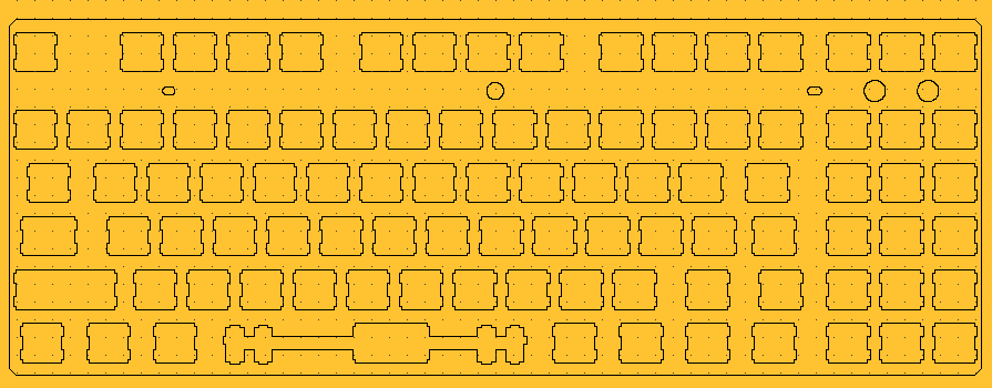

25 Nov 2011, 22:24
Plate layouts are added to the 2nd post of this thread.
25 Nov 2011, 22:33
litster wrote:Plate layouts are added to the 2nd post of this thread.
What about this to make sure that semi-ISO-layout is possible (1.25-1 instead of 1-1.25 in row 4):
edit: I just see there are mistakes in the mount-plate!
:shock:
The 2 additional cut-outs for the keys left and right of the regular space-key are missing!
:shock:
What about the function row?
:shock:
Minskleip
25 Nov 2011, 22:42
What about the bottom row?
bpiphany
26 Nov 2011, 01:48
Look at that now =) I'll have to fix that I suppose. At least it's not the 7bit one that is being processed as the prototype right at the moment.
litster
26 Nov 2011, 03:32
PH7BIT updated in 2nd post.
