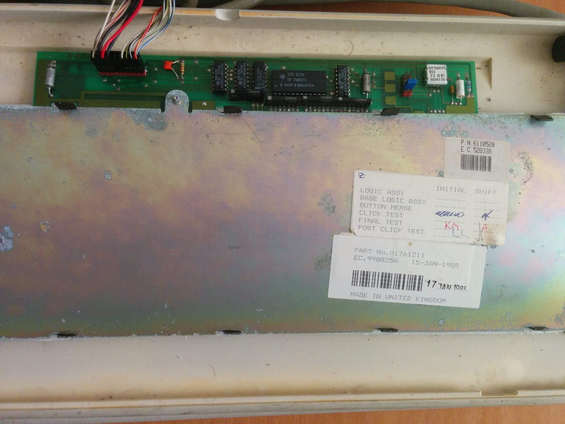

Could you easily work the XTant assembly with a 4176191? As a reminder, it's the one from the 5291 terminal:
wcass
03 Oct 2014, 07:33
REVENGE wrote: Could you easily work the XTant assembly with a 4176191?
I think so. Not 100% sure. Could you post a few pictures with the case open viewing the bottom of the back plate?
The XT back plate has a hole that we use to mount the PCB and controller. The hole is on a tab extending out the "top" edge, just right of center. If the back plate for the 4176191 has a hole in the same spot, I think it should work just fine.

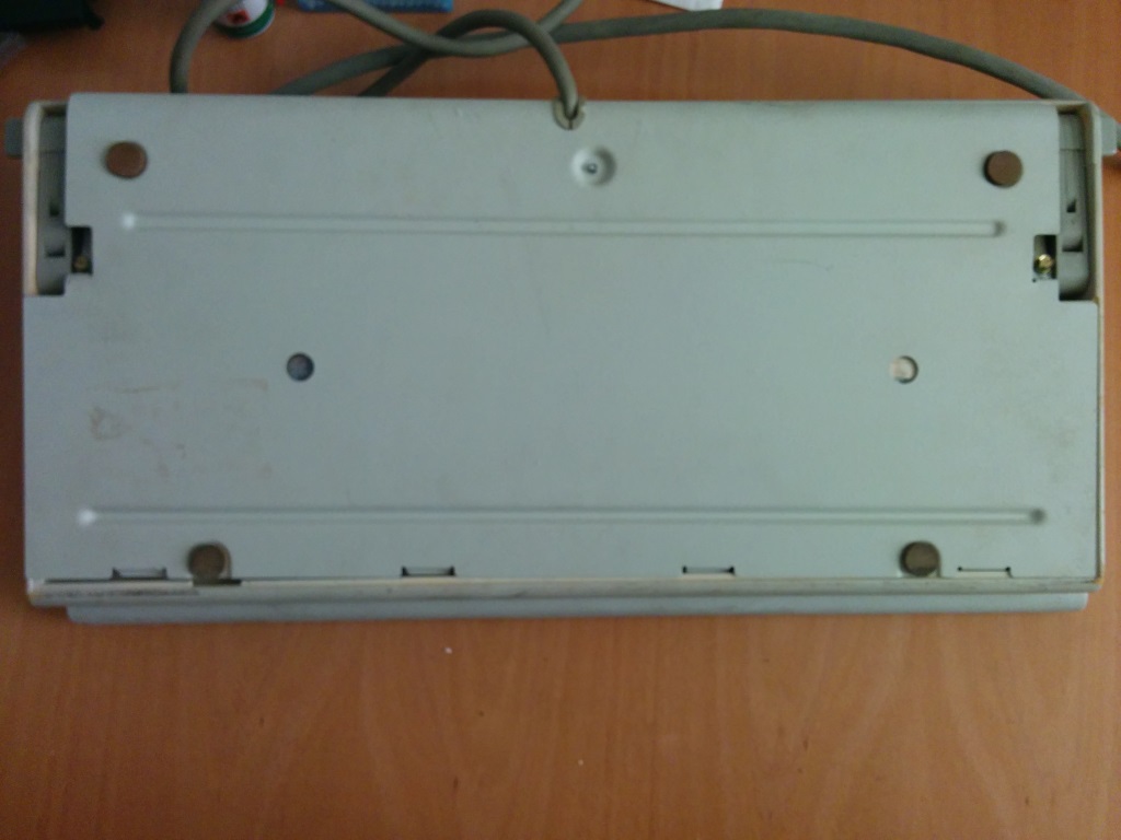

Halvar
03 Oct 2014, 11:26
Bad photo of the battered backplate of mine:
Or do you mean the inner one?
03 Oct 2014, 11:47
the controller will attach to the inner plate so i would say he needs the inner one
03 Oct 2014, 12:29
If I had one of these Bigfoots, I'd be prying it open to spam pictures of its innards. But I don't, so here's some inside pics I found in a search. Can you see what you need here, Wcass?
XTant would be a great upgrade for these guys with their notorious attached controller:
03 Oct 2014, 12:32
That is a totally different controller than an XT the component count is so low and the connector is different
same backplate as far as i can see
Halvar
03 Oct 2014, 12:52
Mind the rust...
wcass
04 Oct 2014, 01:10
That does look a lot like the XT back plate.
The plate that the PCB/controller is attached to, is it 17.5" wide? If you measured from the center of that bolt to the sides is it 9.9" and 7.6"? If so, then the plate is the same and the XTant kit will work.

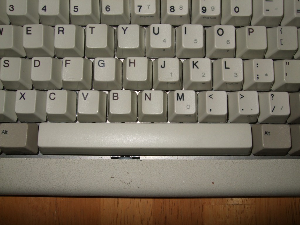

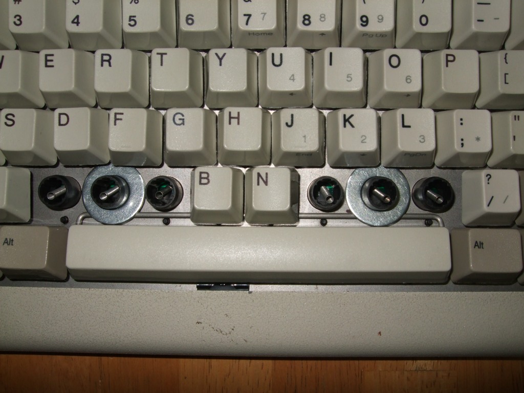

If the reviews go well, look for kits in a month or so.
I’ve been asked a few times (and wondered myself) about how I will do spacebar stabilization. I’ll use Unicomp space bars of course, but how to hold the bar against the barrel frame is the question.
I did a mod a few years back that replaced an AT’s spacebar for two Alt keys and a model M spacebar. For that, I bent a piece of metal and glued this to the barrel frame. It worked, but the metal was not as thick as I would have liked (too bendy) and the connection to the barrel frame was a weak point on a keyboard famous for being almost indestructible. I wanted to try out some other options.
My first idea was to 3D print a copy of the retention clips used for the spacebar on the 122 key Model F, but there are two reasons why this is not ideal. First, mounting the clips to the barrel frame would require glue again. Second, the barrels on an XT have a alignment stud different from the alignment notch on the barrels of an AT or 122. The stud sticks up through the barrel frame slightly and would block the stabilizer from sliding easily into a clip as the spacebar is mounted. This second issue would also affect stamped or welded on clips too.
So my next idea was to use the geometry of the keyboard to hold the clips on - cantilevered off of a barrel. I would need a piece of metal with a hole in it; the hole must be close to the diameter of the barrels and the outer edge must extend over the stabilizer bar. I picked up two 7/16” SAE washers from my neighborhood hardware store for less than a dollar, dropped them over the C and < keys and they work perfectly with nothing but the washer's weight and rigidity keeping the washer edge from tilting up – and this keeps the spacebar stabilizer tight against the barrel frame. The spacebar registers properly and reliably even when I press at the extreme left and right of the key.
Hypersphere
04 Oct 2014, 23:15
@wcass:
Brilliant!!!
Thanks for sharing your washer stabilizer invention for putting Model M spacebars into Model F keyboards. It is an elegant solution.
You probably should have filed for a patent.
Edit: What keeps the stabilizer wire and spacebar from shifting laterally? What about sliding too far toward the front of the keyboard?
mr_a500
05 Oct 2014, 00:29
wcass wrote: So my next idea was to use the geometry of the keyboard to hold the clips on - cantilevered off of a barrel. I would need a piece of metal with a hole in it; the hole must be close to the diameter of the barrels and the outer edge must extend over the stabilizer bar. I picked up two 7/16” SAE washers from my neighborhood hardware store for less than a dollar, dropped them over the C and < keys and they work perfectly with nothing but the washer's weight and rigidity keeping the washer edge from tilting up – and this keeps the spacebar stabilizer tight against the barrel frame. The spacebar registers properly and reliably even when I press at the extreme left and right of the key.
That's pretty clever. It's very satisfying when there's a simple solution to a complex problem.
wcass
05 Oct 2014, 03:10
Hypersphere wrote: What keeps the stabilizer wire and spacebar from shifting laterally? What about sliding too far toward the front of the keyboard?
The key cap plunger keeps the cap in the right spot north/south/east/west. The stabilizer wire is fixed to the cap but free to rotate. It acts exactly like an anti-roll bar does on a car. The last direction of unwanted movement is twist; this is where the barrel alignment studs help. The length of the Model M wire is such that it reaches just past this - effectively preventing rotation. The picture with the caps off shows it.
