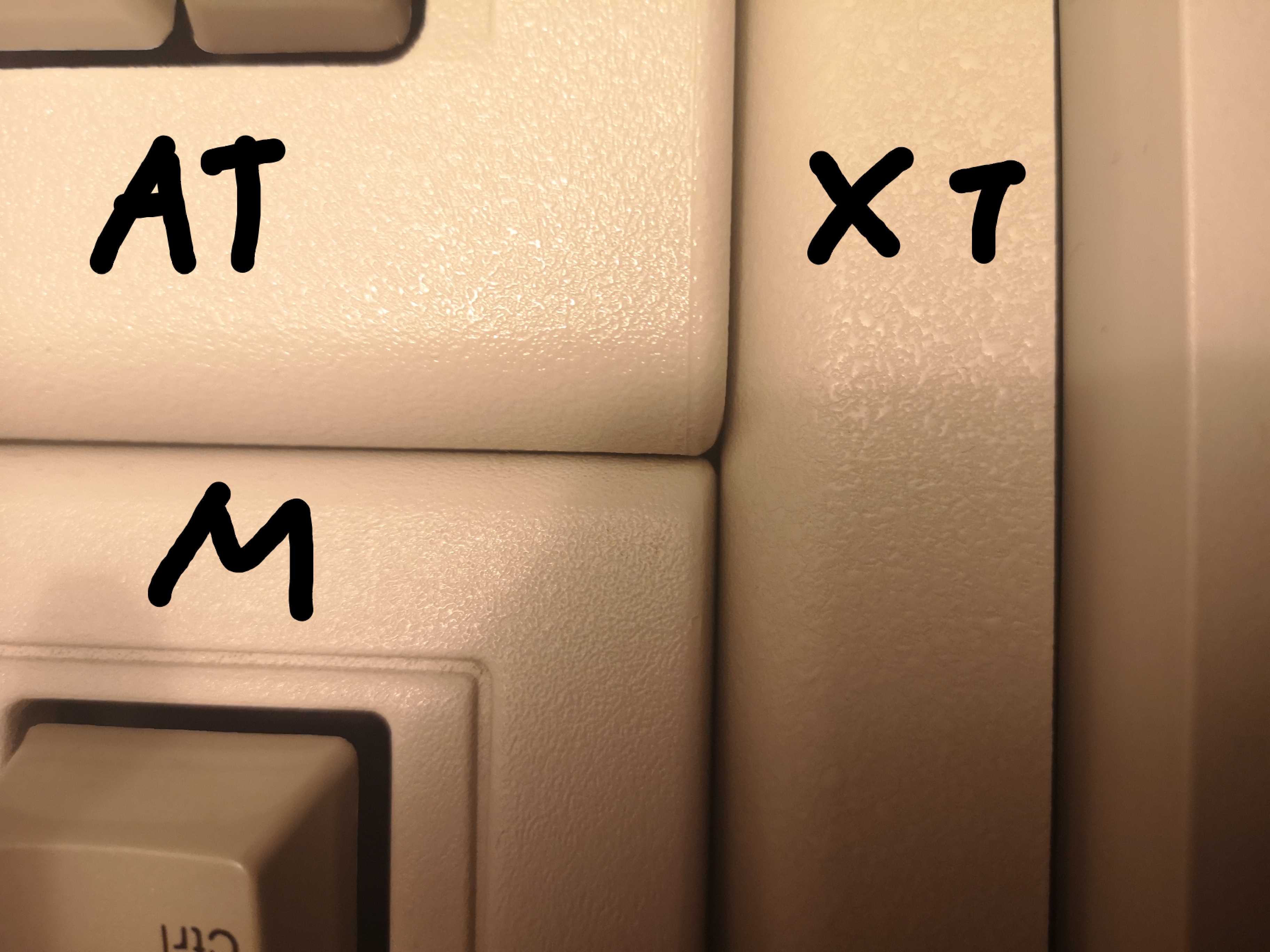

My AT is made from the exact same plastic as my Model M's 1st gen's and 2nd gen's plastic for sure. Also the plastic on my F122 is the same painted plastic as on my XT
So this is how all the keyboards are in my experience
IBM Model M- Thin flexible PVC Plastic
IBM Model F AT- Thin Flexible PVC Plastic
IBM Model F XT- Thick Dense Painted Brittle Plastic
IBM Model F122- Thick Dense Painted Brittle Plastic
Attached below is an example how the Thick dense painted brittle plastic can crack. The keyboard in the picture 1 is an F122 and the keyboard in picture 2 is an XT. The whole seperation between the F keys and the Alpha numeric keys

Well, I had a look, and yes, the plastic seems more flexible than I remembered it to be. It's also not yellowed in the slightest. The texture is also injection-moulded, not painted. And, as Jordan noted, it's from 1989, well into the era where they made the PVC Model M.
Of course, none of this is proof that it's PVC, but it's definitely a possibility

Here's a comparison of all the different models plastic types hope that helps. As you can probably tell the Model M's and the AT's plastic look pretty much identical both in colour and texture. The XT Texture is much more subtle and more of a cream colour than the white colour like the Model M and the AT. Let me know your thoughts of course other Model F AT's could be made of a different types of plastic but the keyboards I am going by manufacture dates are as follows
IBM Model F X: 1984
IBM Model F AT: 1984
IBM Model M 1st gen square metal badge: 1987
All of the keyboards in the image were made in Greenock scotland United Kingdom.
IBM Model F X: 1984
- IMG_20190704_215003.jpg (2.13 MiB) Viewed 7146 times

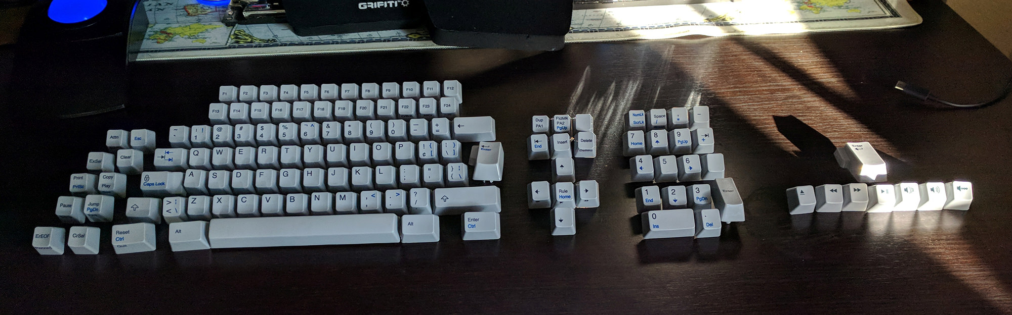

If anyone has the 122-key terminal keyboards, here's something you can do to really improve the sound - at least in my opinion.
Pad the bottom metal pan with foam (I used 2mm PVC craft foam) and don't screw in the assembly. This brings out the thock quite considerably, but makes it sound dense at the same time. Of course, a thick or firm foam mat replacement will help as well. It is really beneficial to drill holes through clear parts of the assembly and add bolts
I do like the dense, metallic sound of the spacebar before the keyboard has been messed with. Unfortunately, the bottom out sound seems to turn hollow and sharp after a foam replacement. I rectified this by putting 1mm self-adhesive neoprene under the little posts at either side of the spacebar. This does make it feel slightly mushier, but it sounds a lot more pleasant. The thock is cushioned, leaving a deep-sounding upstroke rattle which I really like.

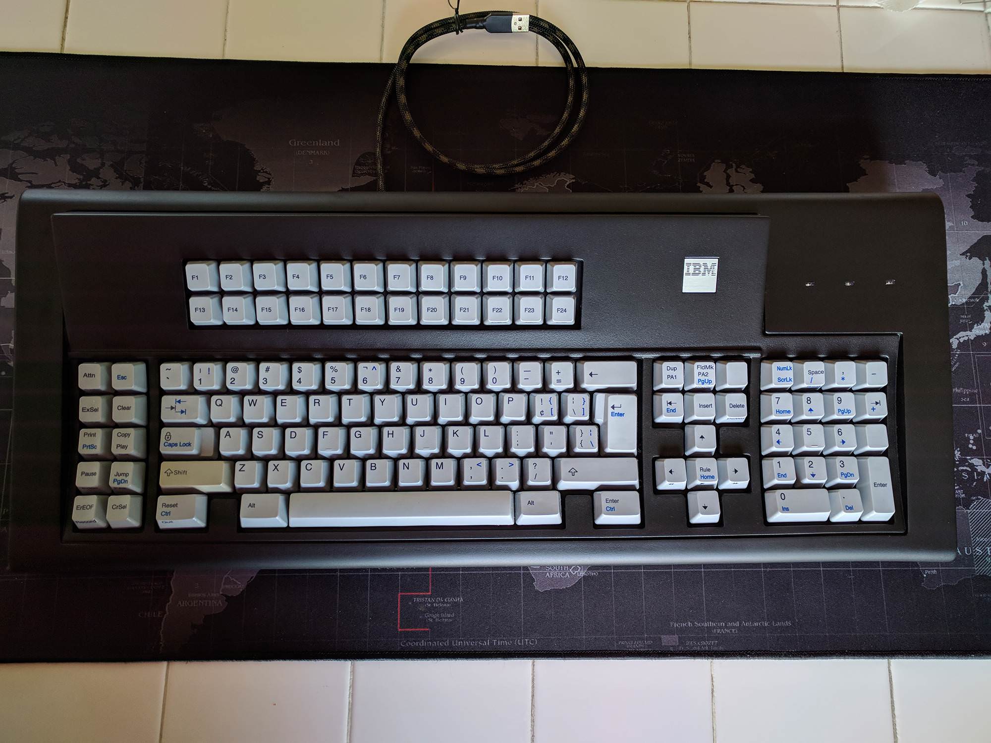

I previously thought I couldn't do anything right, but I think this lovely 4980 Model F sounds wonderful now. It sounds extremely thocky and metallic. Unfortunately it does not ping much. That is something I would like to experiment with more. Maybe I need to replace the 2mm PVC foam with 3mm neoprene. Maybe it would be fun to lube the springs and barrels as well. Not enough documentation on the effects of lubing buckling springs keyboards - would be great to hear from someone who has.
I would absolutely kill for an F107. I'd love to do a similar mod with it and see how it turns out.

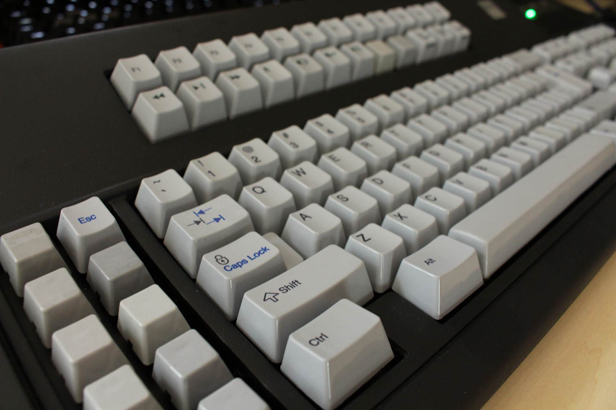

I have never had the opportunity to try an F122, so I can't comment on how well I like that model. And Kishsavers are absolute unobtanium, unless you're talking about the new reissues that everyone is anxiously waiting for. But I'm not sure that comparing the new reissues with the vintage models would be appropriate for this discussion anyway.
But I do own both a Model F XT and a Model F AT. I have to say that I love them both, but I prefer the XT by a slight margin.
I like the layout on the AT a little better, and the feel and sound of the switches is so close I don't really think that makes a big enough difference to mention.
But the XT is definitely built better, the metal back plate just makes it feel a lot more sturdy. They both weigh a ton, but the XT is simply an absolute unit, hands down the best constructed keyboard I've ever encountered in my admittedly limited experience. Better than the AT, and way better than my Model M.
But I'm also sure I like my XT a bit better since I was luckily able to acquire an NOS keyboard, Still, the AT I got was really clean.
I solved the lack of homing keys by substituting a couple of Model M keys. The legends are slightly different, but not enough to notice unless you look closely. They can be easily obtained from ClickyKeyboards.com, and they are authentic vintage caps, so at least a little better than ones you could get from Unicomp.
If you look closely you can see that the F and J keys have homing bumps, but the legends are just slightly different...

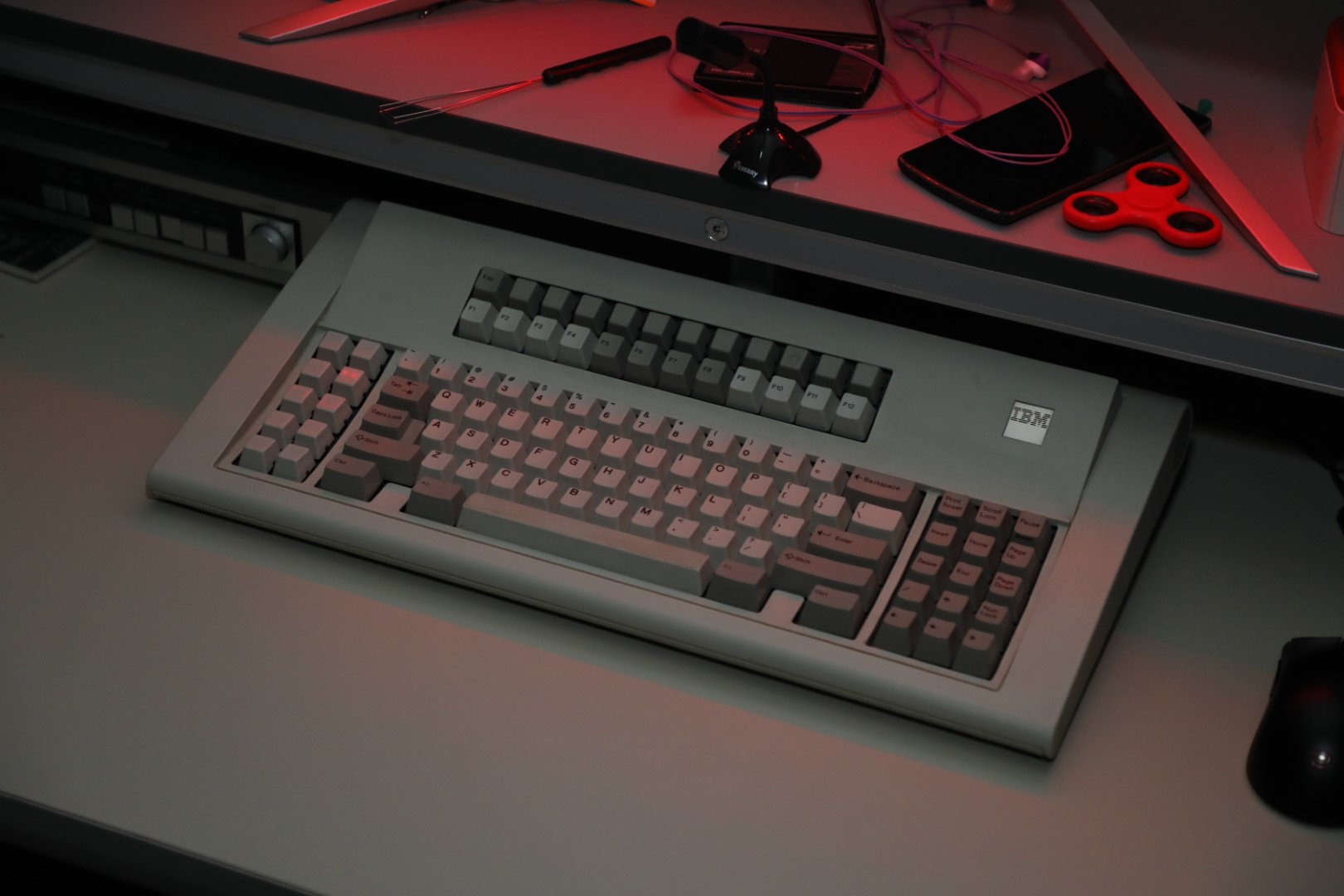

- karlmartin95
- Main keyboard: IBM 4704 F77
- Favorite switch: Model F Capacitive Switch
And what about the terminal model F's? Like the 4704 keyboards?

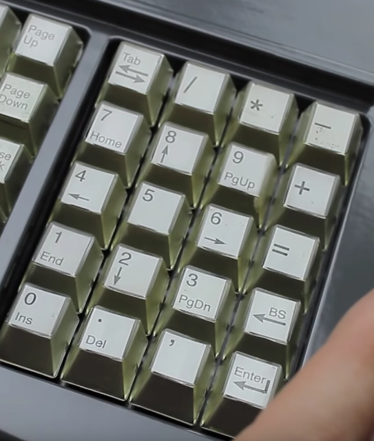

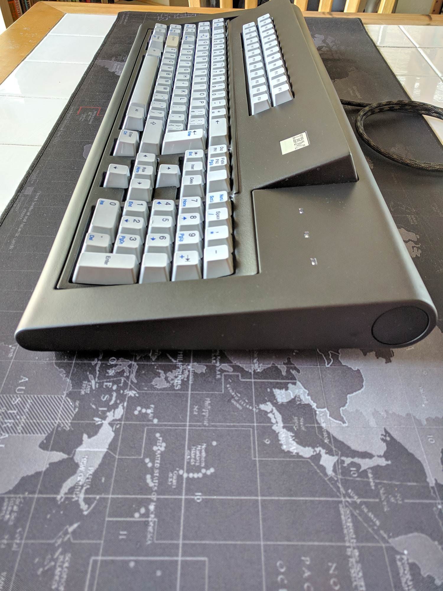

I'm currently trying to mod my 4980 Model F to look like Iggy's black F122 that just_add_coffee restored. I really like the sleek, black case and grey keycaps. In the process of asking Unicomp what they can and can't do. I want grey 3270 terminal keycaps with blue sublegends, with sublegends in the F keys like on other terminal boards. I also asked if I could have more on the 10 keys at the left.
Going for a similar layout, with a large ANSI left shift and ISO enter key. I want a 20 key numpad with Chyros' F107 layout mapped to it.
I need to find somewhere that will paint my plastic case for me, but I don't know any places.
Pictures included are Iggy's F122 and the numpad I am trying to replicate.
- numpad.PNG (626.94 KiB) Viewed 6626 times

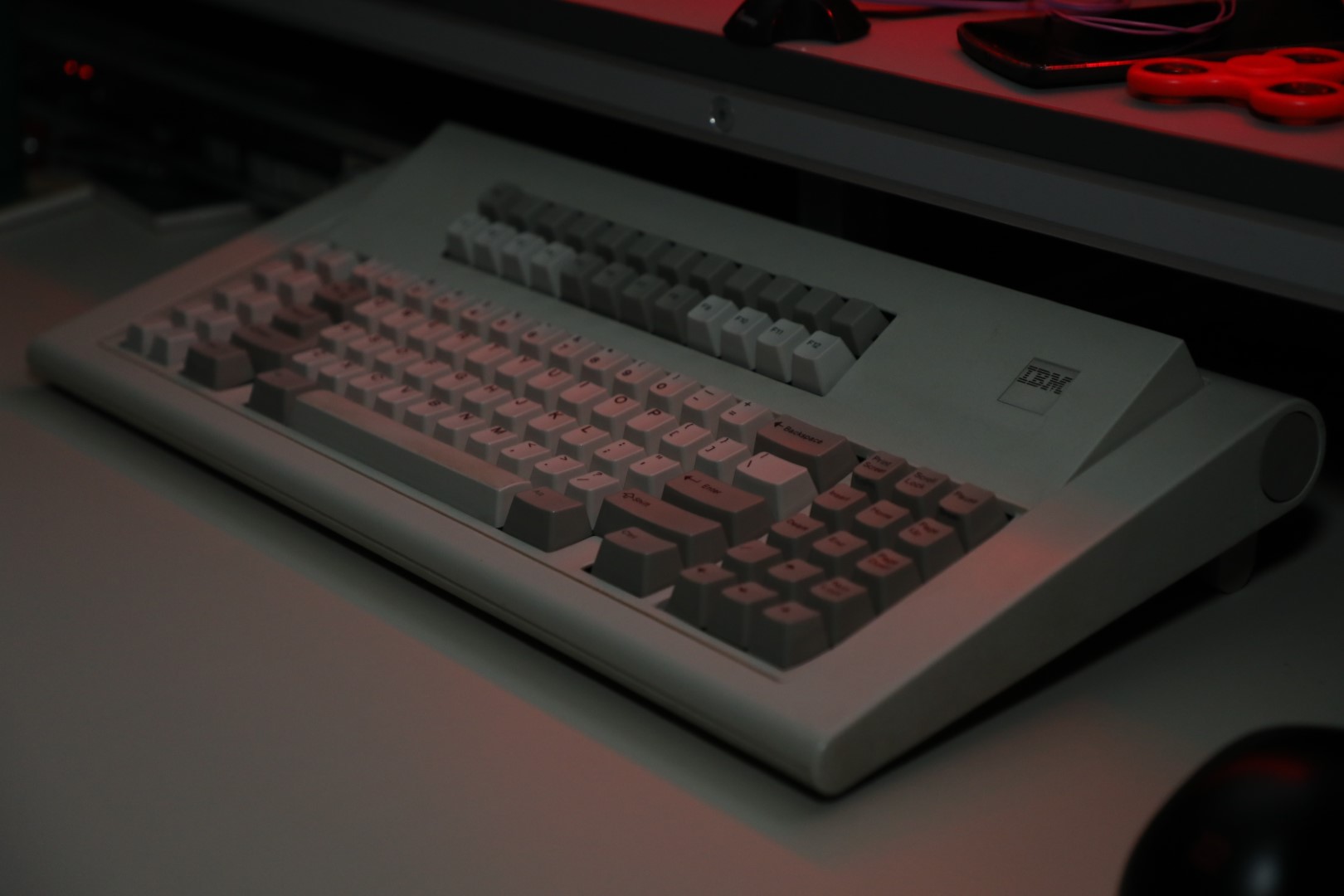

As the proud owner of an F XT, a 5155, and an F122, the battleship wins out as my favorite. It has the layout I prefer; I need Ctrl and Alt by my left hand as I use those keys extensively for 3ds Max. I also love the function cluster on the left. It's extremely versatile and a great place for macros and hotkeys. Also great are the 24 PF keys at the top. I still haven't mapped them all. I only wish the feel was as snappy as my 5155. That, as well as the enormous footprint, is the only thing I would change about it.

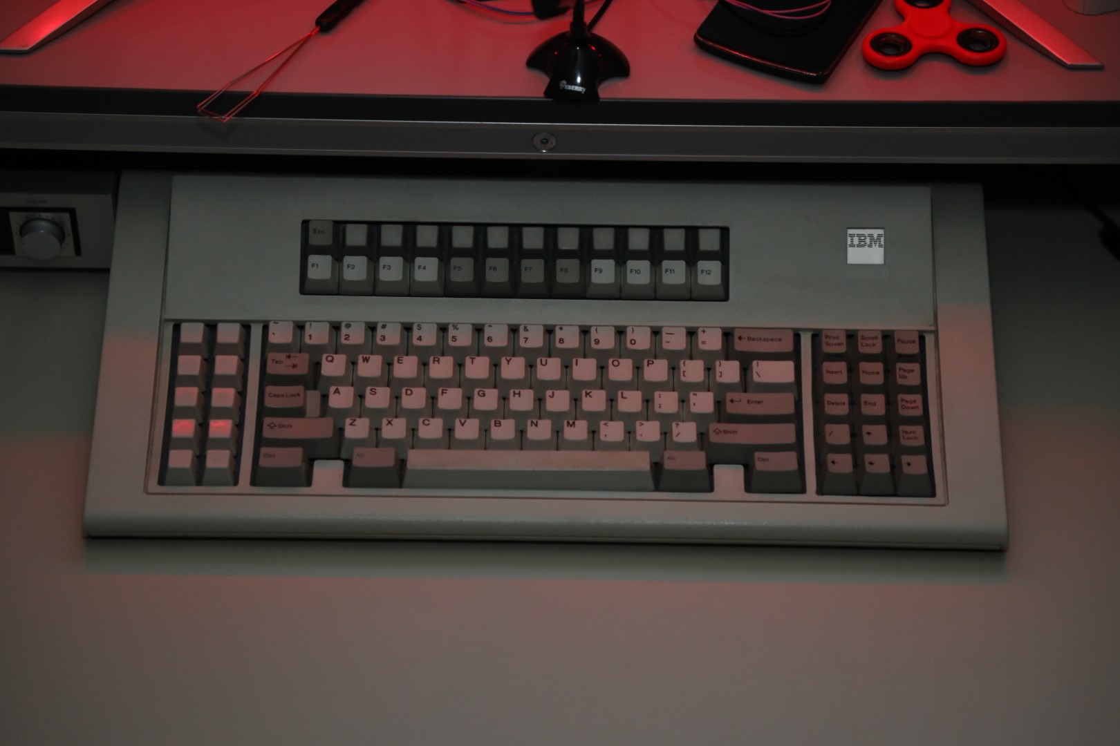

I kept 2 sets of Function keys, on the left I made the old F9 into F11 (full screen) and the old F10 into Windows.
Above, I use the bottom row as straight F1-F12, and the upper row has, left-to-right, F13=Escape, F14=calculator, F15=NumLock (only to turn NumLock back on again if it gets reset when I have temporarily swapped in another keyboard), F16-F19 not yet assigned, F20=PrintScreen, F21=Pause, F22=Volume Down, F23=Volume Up, and F24=Mute
