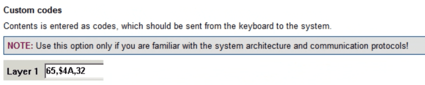

Then try entering this in "text mode input" (selected under "Scanline" in the key specific menu):
- for ' enter /34 34\
- for ` enter /35 35\
- for " I don't know atm (as it is a shifted character)

does not work too.
I have a workaround, that is not working in anny application.
Programming a 'space' after the 'quote' generates "direct" the 'quote'.
But as I said, this is a workaround that is not usefull for all my needs.
Any idea's left?
Any idea's left?

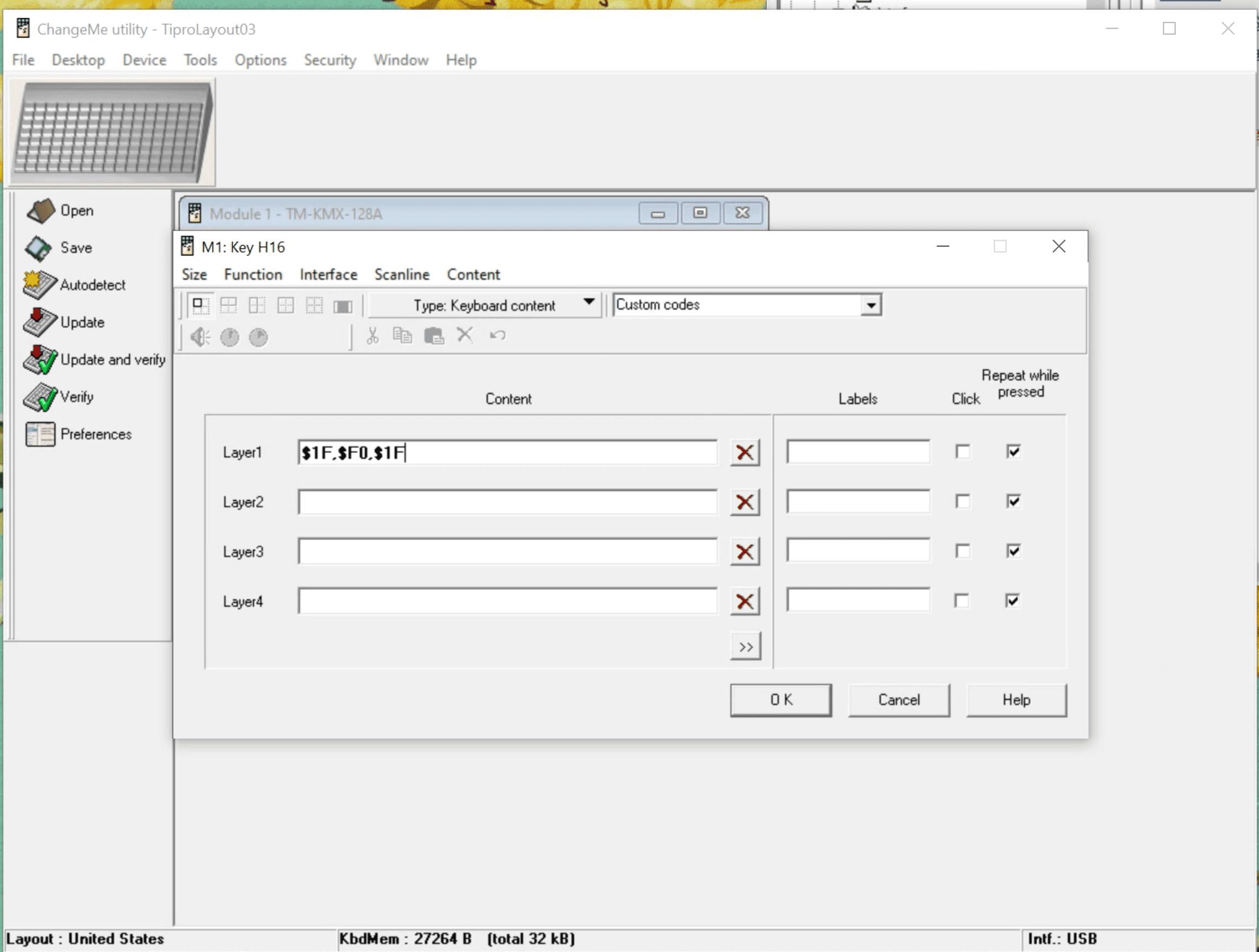

I hope you don't mind me bringing this thread back to life. I've got a Tipro TM-KMX-128A and I am having a difficult time understanding how to program custom codes. My goal is to implement as many unique individual keys as possible onto the board.
For a clear demonstration of my issue, I will use an example which has already been demonstrated to work earlier in the thread. Following that guidance, this is what I am doing (also see attached screenshot):
Changed interface to "custom codes"
Entered $1F,$F0,$1F into Layer1
Updated keyboard.
But now pressing that key returns no keystroke, where F13 would be expected.
I can confirm setting other non-custom keys works fine. I feel like I must just be missing something here and would love a bit of advice if anyone has a spare moment to get me on the right track?
Thanks, Nathan
Hey Tipro people
Updated keyboard.
Thanks, Nathan

Of course not, it's not even been 5 yearsFloating.Point wrote: 23 Sep 2021, 08:24 Hey Tipro people
I hope you don't mind me bringing this thread back to life.[…]
But I think 7bit's solution for F13 never worked, and I have neither a keyboard with a F13 key to check the code it sends nor an application to check whether it works.
I'll have a look a the issue later today, but I hope there are other users more proficient than me who can help you in the meantime.

I got curious and here’s what I found:
Press the key you want to program as F13
Right-click in the scanline field of the layer you want to program as F13
Select "Special content"
Select "F13"
Confirm with "OK"
And then upload to your keyboard, test whether it works and please tell us.
(By the way, choosing "Help" in the Tipro ChangeMe menu and searching for F13 is how I found that
Select "F13"
Confirm with "OK"

Hi kbdfr and Muirium, thanks for helping out
(Just quickly, Muirium – yep I'm using a USB model.)
So using the right click "Special content" is only available when the key's interface is set to the PS/2 and USB mode. I can successfully program F13 using this method, just as I can also successfully assign F14 through F24 (etc) with text mode input (referencing the USB codes on the wiki - here). The thing I cant seem to work out is how to deal with programming custom codes, like I had assumed (possibly incorrectly) user 7-bit seemed to manage successfully. Sadly Tipro's documentation on the topic is rather limited: . What I'm hoping to achieve is being able to utilise the precious few remaining single keys that are compatible with MacOS - such as power, eject, volume etc. I am actually remapping every single key in software and having individual unmodified keys is much more flexible as a base layer.

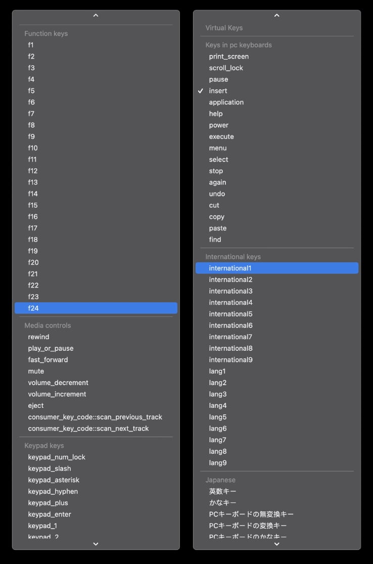

Aren't there? Karabiner can map from and to quite a few. The pulldown menu's much too long for a screenshot, so here's just a couple of promising bits: If it's in the USB HID keyboard standard, I bet Karabiner can handle it.Floating.Point wrote: 24 Sep 2021, 09:51 Sadly there's not quite enough unique key strokes supported on MacOS for all 128 keys
Additionally, Karabiner can also handle most all those fiddly keys that aren't in spec, like the Mac's own Fn key—now available by pressing Insert on my mechs—and the non-standard media keys for controlling keyboard backlight brightness and such. The only one I know Karabiner doesn't support yet—and not for want of trying!—is Apple's own Do Not Disturb key (the crescent moon on the MacBook Air's F6). All the rest are right here: I work around that missing key by remapping the function to F6, anyway. Because Karabiner also works on my laptop's built in keyboard, everything can be seamless.

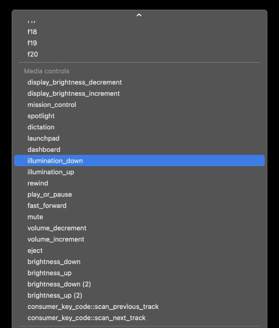

Muirium you're my hero! It turns out while I couldn't get the "media controls" or "international keys" to work, the "keys in pc keyboards" all worked fine, along with F20 - F24. So now every key on the board is a unique single key and I am happy about it.
- Muirium
- µ
- DT Pro Member: µ
Result!
Now put those obscure keys to some real purpose. You got full access to shell script with Karabiner, and it can macro, too. It’s all yours to play with now!
Something you’ll find very helpful: keyboard specific rules via device_if. You find those handy values in Karabiner’s event viewer.
