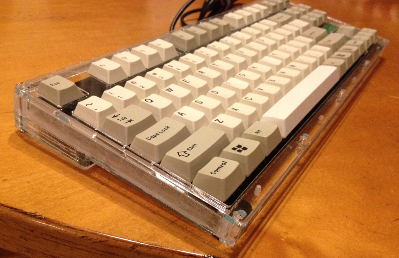

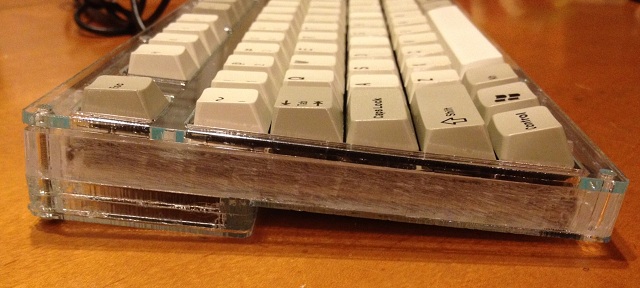

I might have solved the thickness problem. If you can't make a slope, make steps instead. This case is going to be junked and I will have to make a new one. This one has so many test holes in it, but it is a worthy prototype.

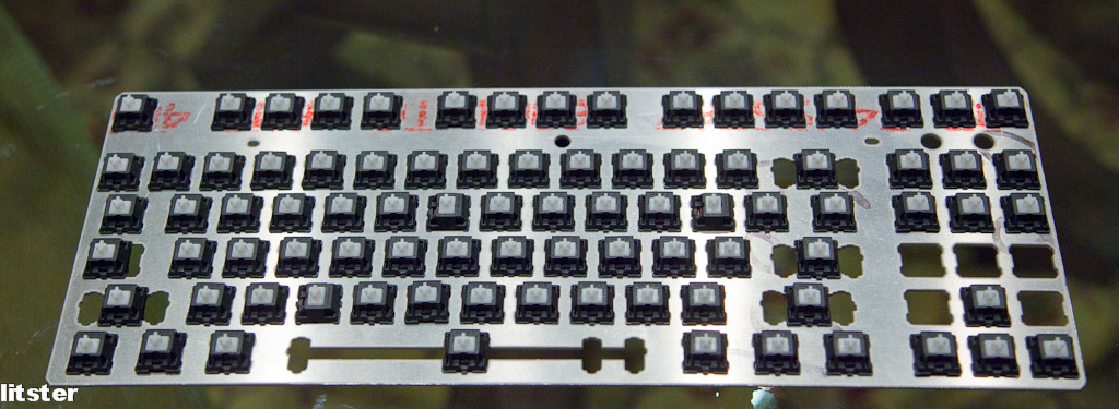

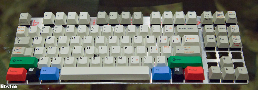

First test plate is in. Notice I use a Cherry off-center capslock. I don't have any plate-mount stabilizer. I may need to butcher a Wyse keyboard to get a couple of plate-mounted Cherry stabilizers. To late tonight (this morning?). I will put it inside my acrylic case or a Filco case tomorrow.
