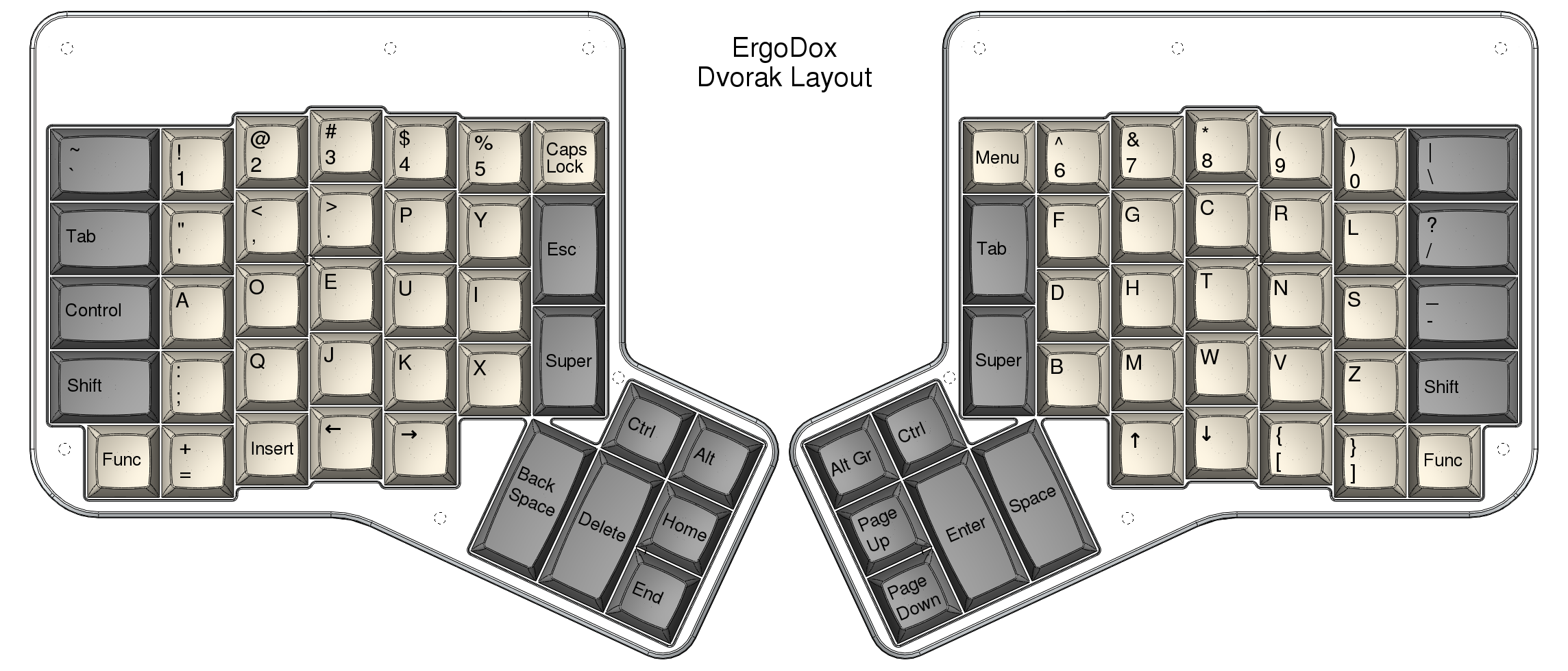

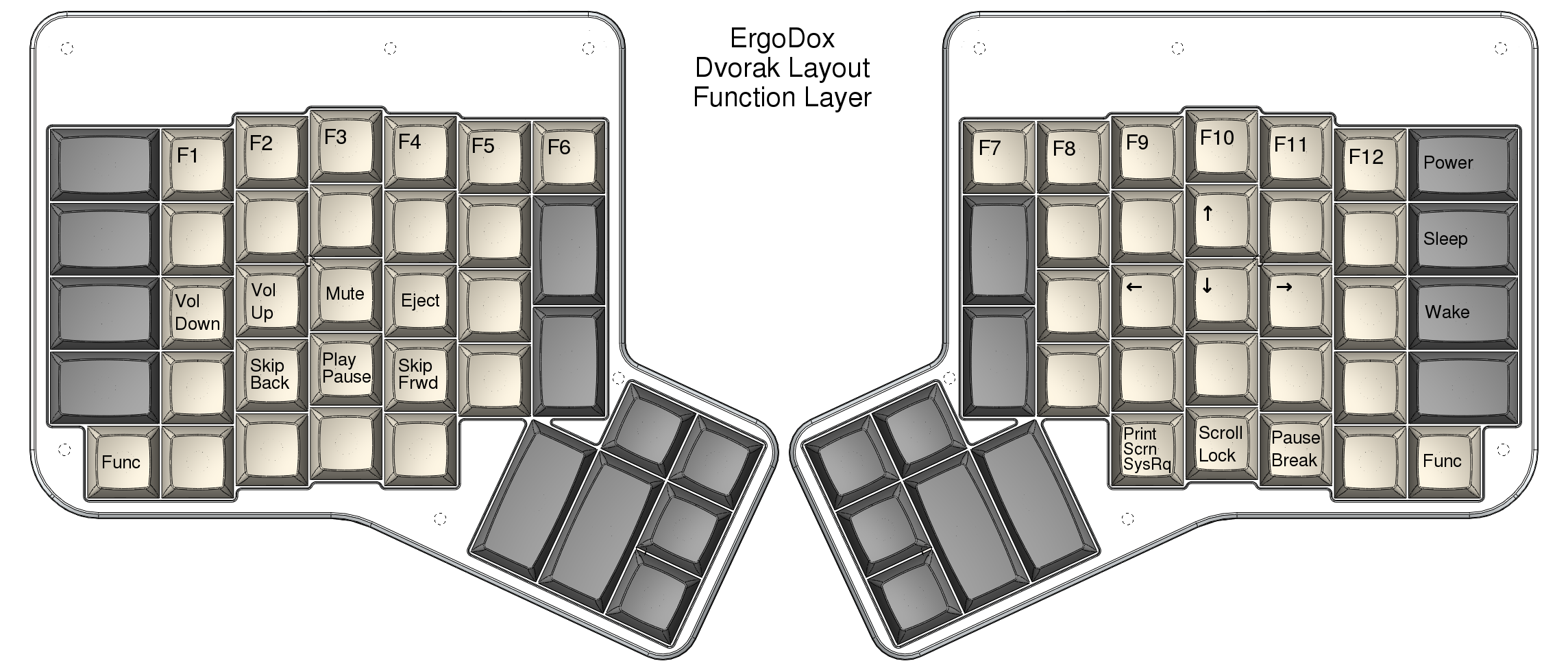

by Tafryn
I took a stab at a dvorak layout, and here it is. It's mostly inspired by the Kinesis Advantage with some HHKB and TE accents. I'm not sure if the firmware supports layers or not, but I drew up a function layer just in case it does. The capability to lock one or both sides of the board to the function layer (perhaps with a double tap of the Func key) would be pretty great. However, I'm not sure if that's possible while still maintaining modifier-like behavior on a single press of the Func key. Either way, the main layout has pretty much everything you'd need without the function layer (except for the F-keys).
Posted: 10 Aug 2012, 18:28
by justcallmecrash
Tafryn wrote:I took a stab at a dvorak layout, and here it is. It's mostly inspired by the Kinesis Advantage with some HHKB and TE accents. I'm not sure if the firmware supports layers or not, but I drew up a function layer just in case it does. The capability to lock one or both sides of the board to the function layer (perhaps with a double tap of the Func key) would be pretty great. However, I'm not sure if that's possible while still maintaining modifier-like behavior on a single press of the Func key. Either way, the main layout has pretty much everything you'd need without the function layer (except for the F-keys).
I LOVE it! Awesome layout.
Posted: 10 Aug 2012, 20:24
by ic07
Thanks! :) . There's a few things I'm working on first, but I'll get it in there. I also posted it on the github page.
The firmware does support layers, and layer locking, and it'd be possible to implement locking just one side. Locking based on double tap though would take enabling the timer, and I don't think I'll have time to play with that part of the Teensy for a little while.
Posted: 10 Aug 2012, 22:20
by Tafryn
ic07 wrote:Thanks! :) . There's a few things I'm working on first, but I'll get it in there. I also posted it on the github page.
How about having <Left Func> and <Right Func>. Both could act as modifiers when holding them and pressing any other normal key. Locking a side to the function layer could be accomplished by holding one function key and pressing the other (e.g. Holding down <Left Func> and pressing <Right Func> would lock the right side to the function layer and vice versa). Unlocking could be accomplished by repeating the locking key-combination. That way the behavior of the function keys stays consistent regardless of which layer either side is in.
The behavior of a <*Func> + <Normal Key> keypress on a function locked side is still somewhat unclear. It could act like a keypress on the default layer, or it could act like a keypress on the function layer. For example, lock the right side to the function layer with <Left Func>+<Right Func> then press <Right Func>+<F10>. Should the resulting keypress be "8" or "F10"?
