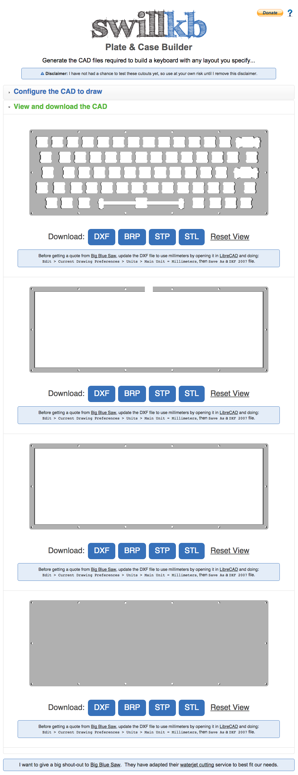

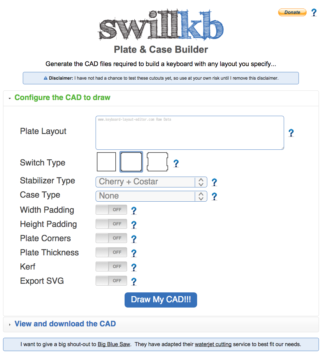

I just saw this. My plate building tool (builder.swillkb.com) has been updated since you last used it and it now supports the export of a DXF file. The DXF file format I am using is R12 though, so it does not include the units of measure (UOM). The plate is built in millimeters, so if you open it in a CAD program and you default UOM is inches, you will have to change the UOM to 'mm' and then resave it. I have added help text to on how to do this when you download the file. I have added a bunch of features recently including all the layers for a sandwich case. Maybe check it out again. Cheers and I am glad it was helpful. :)
Here are some screenshots for reference...
The UI for building a CAD
The CAD results
The CAD results
