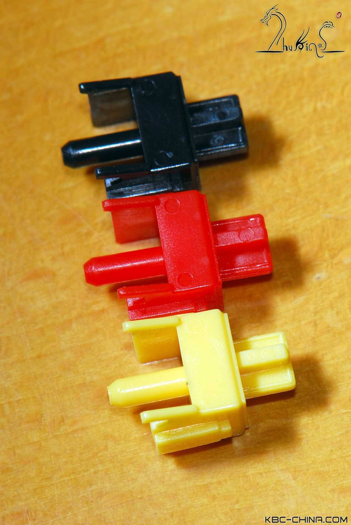

08 Sep 2011, 23:14

Looks like sorbet :slurp:
08 Sep 2011, 23:18
Those KBC trolls and their hoaxes!
08 Sep 2011, 23:25

ripster
09 Sep 2011, 01:13
Well - it LOOKS like a 50g spring!
Too bad the photographer blew out the highlights in the yellow stem - I was trying to see if the molding marks matched. Probably some disgruntled manager stole the molds from Cherry Corp and went across the street with them under his coat.
sordna
09 Sep 2011, 05:03
I run my monitor a little dark, and can see all 3 mold marks on the yellow stem. Seems identical!

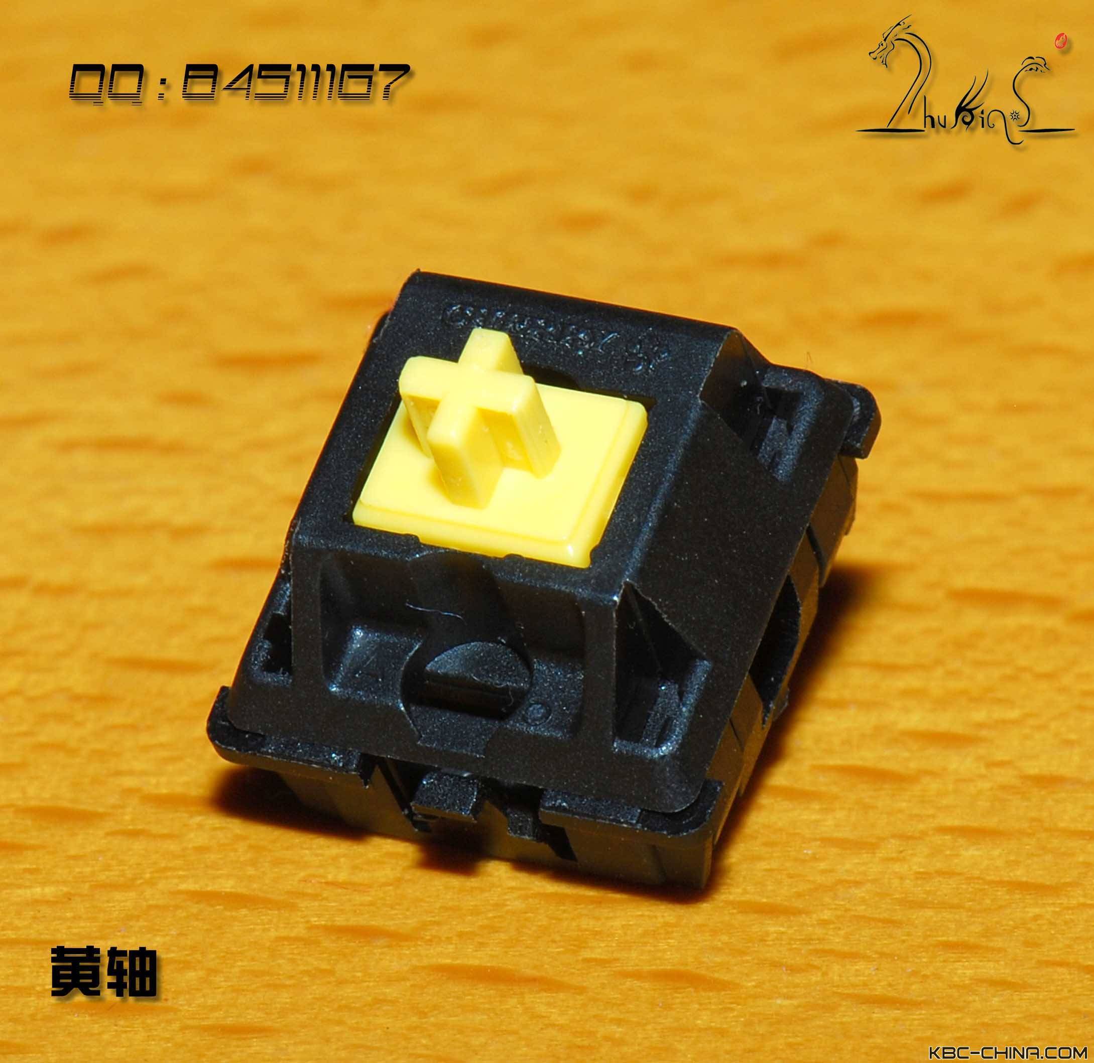

sordna
09 Sep 2011, 05:45
Not sure what these cherry yellows are about, but the Rapoo yellow switch is different:
Source with more pics:
Cherry vs Rapoo thread

Wibox
14 Sep 2011, 21:17
Cherry yellows are inbetween blacks and reds. Not sure what the Rapoo yellows are all about though.
