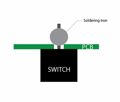

mass, one step is not described in your excellent guide. Perhaps you considered it obvious, but still. Those new holes you drilled lack copper pads to solder the switch to. So, what actually holds the switch in its place on the PCB, and prevents it from wiggling?
mass
06 Jun 2011, 18:47
Sorry for the late reply.
The switch is placed by 4 wires, soldered as above figure. They are not soldered onto the PCB but it seems firm enough to hold it with the PCB. Don't forget to put extra amount of soldering iron and also never use switches without two plastic pins.
(Tip: Always drill the holes little smaller than they need to be. Specially the centre one. 'little tight' is just right)
