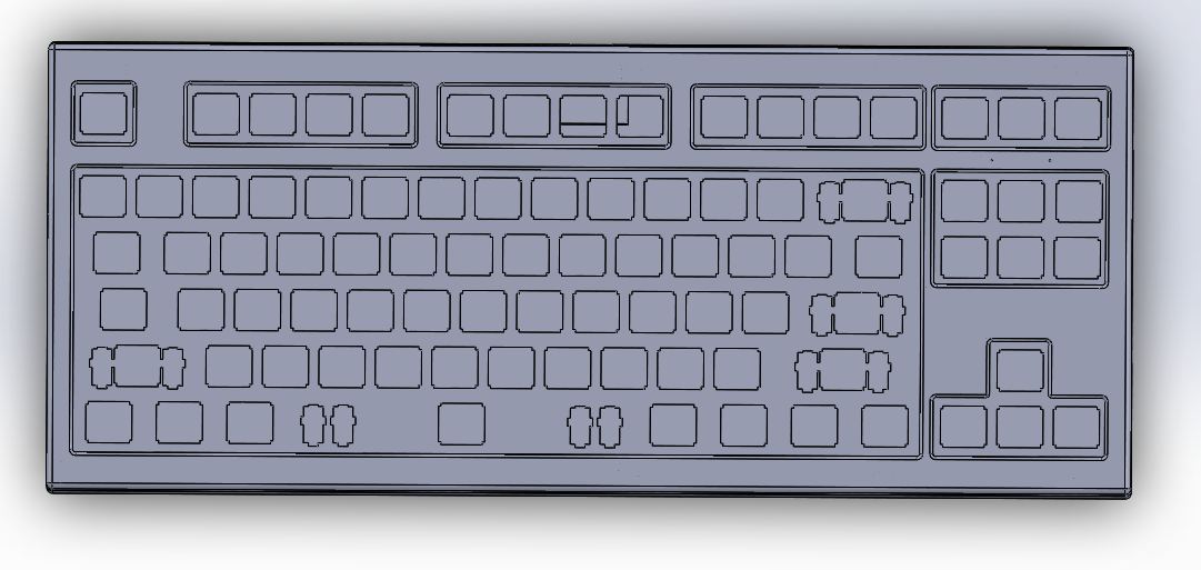

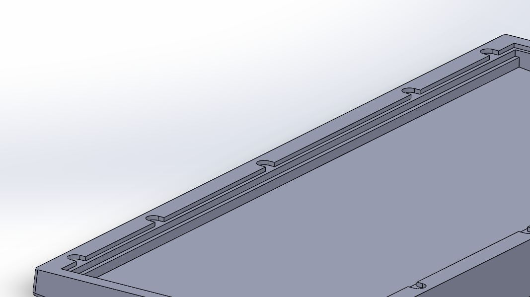

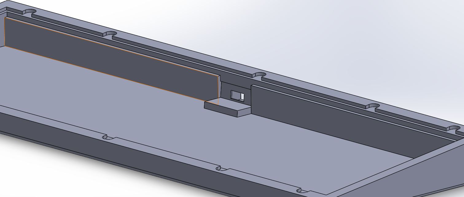

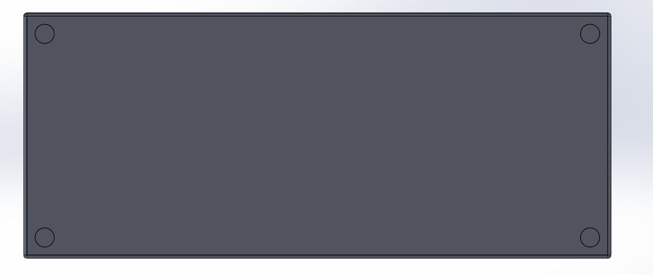

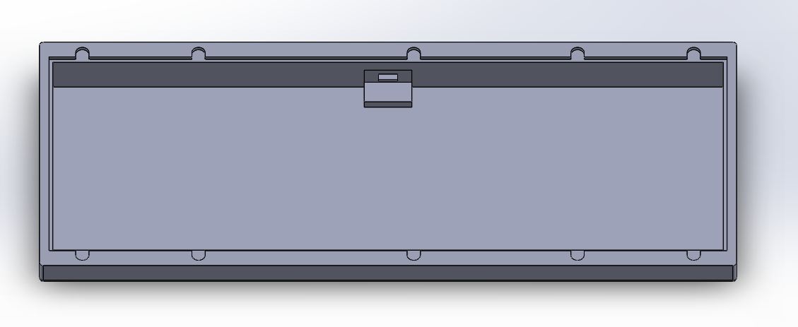

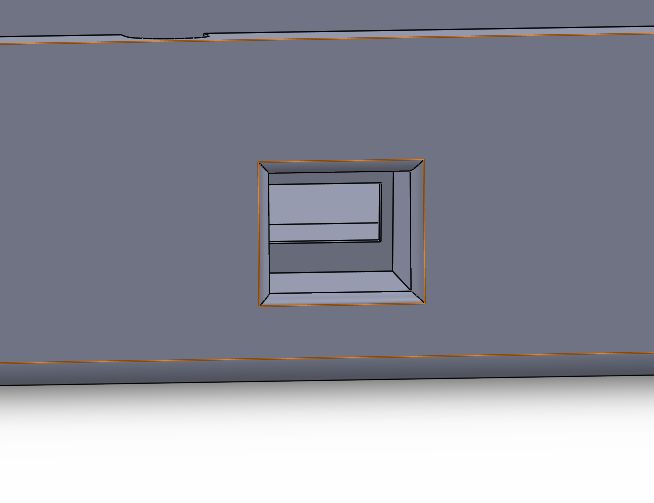

I can confidently say that the case is 99% finalised. The 1% is only tiny details.
I have :
-Made the side walls 5mm thick instead of 9mm thick
-Centered the switch holes on the plate
-Changed plate mounting arrangement
-Change mount slightly - hole is no longer usb-shaped
-Added holes for rubber feet (I have also ordered said feet)
I should be able to get a rough quote for the milling tomorrow. Hopefully it'll be nice and low.
EDIT : calavera over at geekhack has got me thinking.. it MIGHT be possible to make the case compatible with the custom plate mounting, as well as a clamping method for the stock filco plate like the vortex case. I highly doubt this, but I'll look into it.
I have :

photekq wrote:I can confidently say that the case is 99% finalised. The 1% is only tiny details.
I have :

Hey looks good so far. Don't you think the space for the feet is a little small? I thought for some bit bigger rectangular ones. But if you can provide matching fwet I have no problem with the round ones.
Have you thought about colour options yet? Will we be able to choose a colour for ourselves from a wider range or will there only be a few options?

The holes are the right size for the feet I've ordered. If it gets past prototyping then I'll provide all the feet etc.rindorbrot wrote:Hey looks good so far. Don't you think the space for the feet is a little small? I thought for some bit bigger rectangular ones. But if you can provide matching fwet I have no problem with the round ones.
I want to be able to offer as many colours as possible but it all depends on where I get the anodising done.

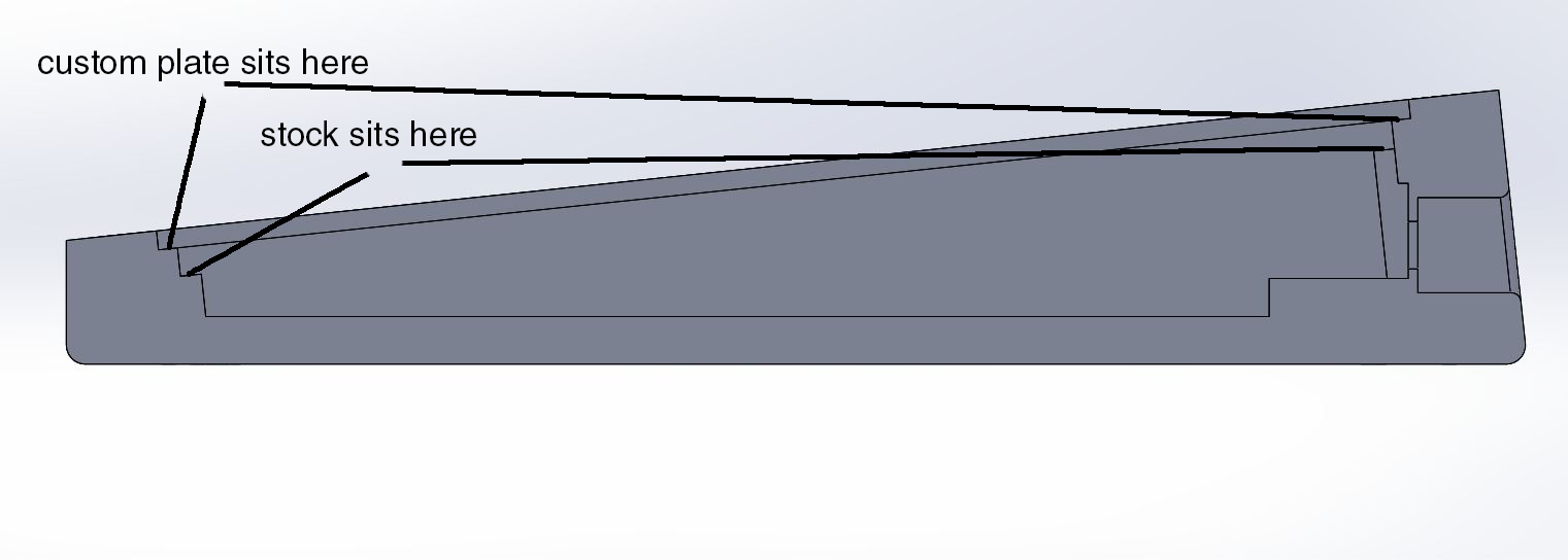

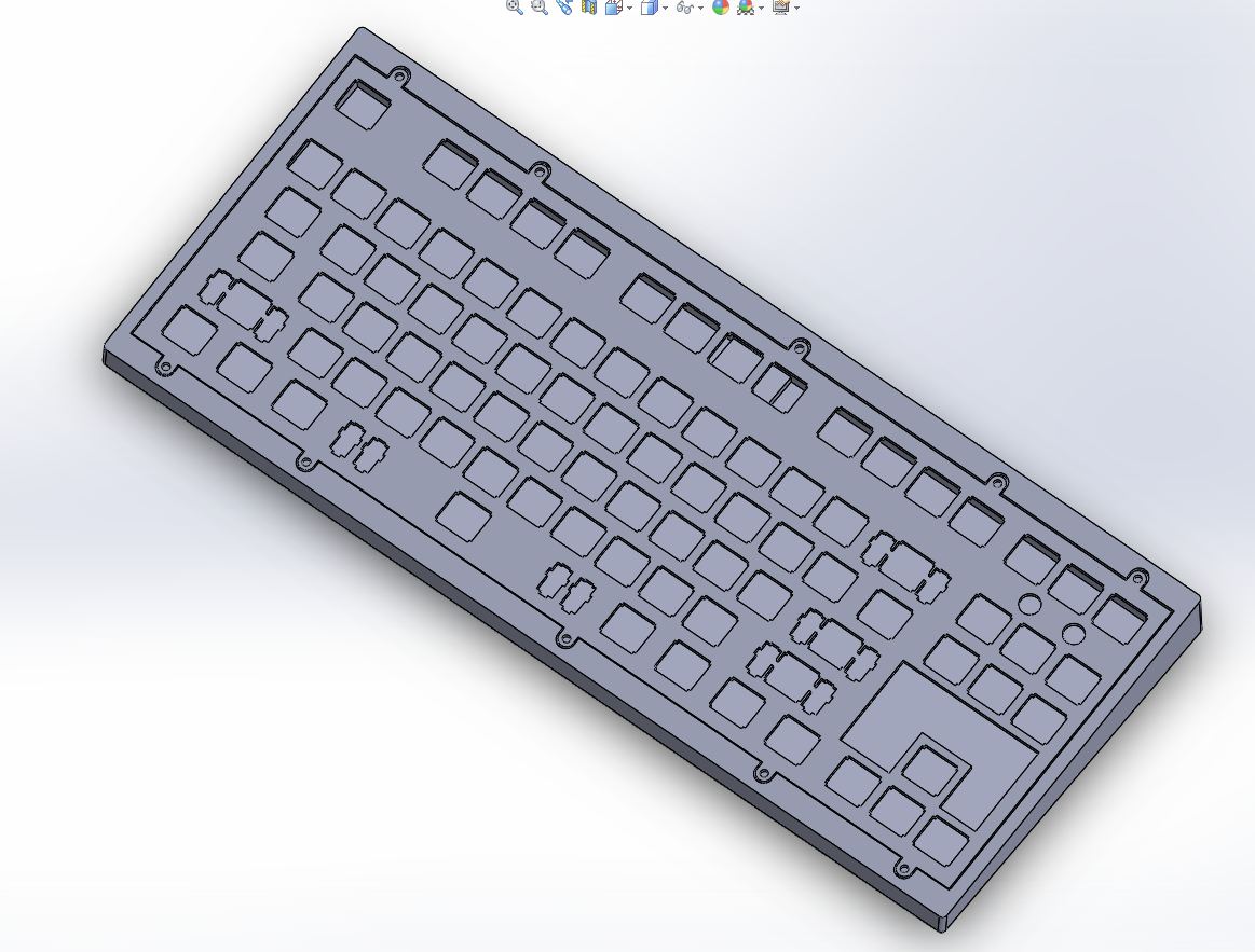

Added platforms for the stock filco plate. The case will now work with the stock filco (maybe the QFR too - the plates look identical) plate as well as the custom one that i'll be making.
Thanks calavera@geekhack for reminding me about the stock plate and for explaining a few things.

Will that impact the stability when using the custom plate?
Because now the plate has less contact area with the case to rest on.
I guess the plate will probably be aluminium too and that is fairly flexible.
Is this just me being paranoid or could that really be an issue?

I haven't changed the mounting of the custom plate whatsoever, I have simply added some platforms for the stock filco plate. The existing platforms remain the same, although I did have to make the plate slightly smaller. That won't impact stability though.rindorbrot wrote:Will that impact the stability when using the custom plate?

Ok then I can calm down

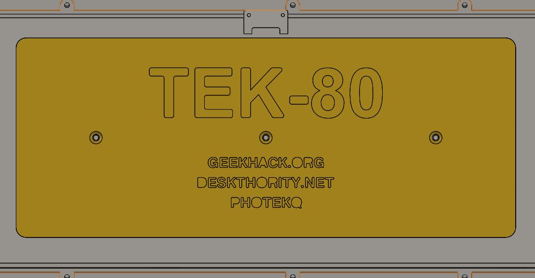

A few updates for those who are interested :
1. Core design is 100% done.
2. I have found a place to get the prototype made.
3. I've been quoted between £300 and £450 for the prototype (not including the plate). This is just about affordable for me at the moment.
4. I can't get the prototype made until early July due to my GCSE exams.
5. Platforms for stock Filco plate may not be in the final design. Please post here if you would genuinely use the stock plate over a custom plate that mounts better and allows you to remove the top half of switches without desoldering. I don't have quotes on the plates yet but I doubt they would be too pricey.
6. There is a possibility of the object in the picture below making an appearance in the prototype. All depends on how much it will add to the costs - I would personally love to have it in the design so if it's within my budget I will put it in. Any guesses what it is?
- tease.JPG (55.75 KiB) Viewed 6735 times

Maybe.. My only worry would be that something might not function correctly. I guess I'll do an IC about that when it comes closer to July. Thanks for the idea.dirge wrote:Brass plate like the 356cl, enquire into volume discount mate. You may get others wanting prototypes and get the price down.
Another possibility would be making the prototype, then doing an 'LE' run that includes the brass plate for a higher price and then doing a normal run without the brass.
