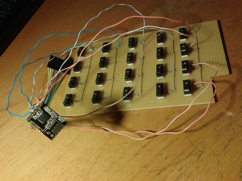

I started writing the code for the nRF24LE1 controller. These are much different beasts than AVRs are and I will probably not be able to use much of the code I wrote for the AVR based controller. The way sleep modes work is much different that on the AVR and I don't think I will be able to achieve the same battery life as with the ATmega169PV. But it should still be good enough and should work for weeks on a CR2032. At least that's the plan.
I'll use a keyboard matrix with diodes and Omrons switches I build a while ago for developing the firmware and testing. It looks scary, doesn't it? :D
believe it or not, this is a wireless keyboard :D
