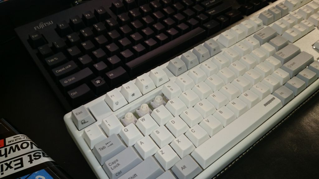

wow, even the legeds are a rip-off... interesting choice of costar stabilizers (novatouch is a bit smarter in that regard).
on the other hand I see no electronics on the PCB, interesting...

I like that they've chosen 35g silenced Topre as their first target. Not the one many of us may have guessed! And, like the NovaTouch, this board has much less footprint waste around the edges. I really hope Topre will respond with a nice tight redesign of the Realforce, preferably with Bluetooth etc.…
As for copying the trade dress, well, insert Apple and Samsung comparisons here. Cloning is the most irritating form of flattery. Actually, the bare brown cardboard and black ink look of Topre's packaging does remind me of 1980s-1990s Apple.
Naturally, the build quality and feel of this Noppoo will be what really matters. Oh, and price, for slider harvesters!

matt3o wrote:wow, even the legeds are a rip-off...
I especially love that they even copied the mistakes! (e.g. Backspace is surely the way it is because of the JIS tiny backspace and Topre haven't always corrected it for their US/EU boards)

I love how they copy everything even the legend on the keycaps :lol:
Btw, the keycaps look really nice, I like it.
Posted: 29 Apr 2014, 11:45
by Grond
Are those actually dye-subs?
Anyway if the keyboard costed one third of a Realforce and was half as good, it may still be a interesting deal!

look like lasered to me

Aren't the bottom modifiers different?
I thought Topre used 1u or 1,5u, these ones seem to be 1,25u.
Posted: 29 Apr 2014, 23:04
by Muirium
An improvement! And one shared by the similarly MX compatible CM NovaTouch:
But this one is Topre approved.

Look what I got today :)
First impressions are that it's a pretty decent effort. Quoted as being uniform 35g and I'd say that's pretty close as it does feel somewhere in-between my 30g and 45g Topre boards. Can definitely feel some more friction on the sliders compared to the Realforce but nothing that some lube couldn't address. The keycaps, while pretty thick, look and feel cheap. There's something rattling around inside the case so will be interesting to see if that's a clip that has snapped off or a screw that has come loose.

The board sucks. The caps are rubbish, the case is flimsy, they have literally put a rectangular peg through a round hole with the LEDs. I actually had to de-solder them just to get the board apart.
It feels *OK*. Sliders were a bit scratchy, but overall not too bad. It's advertised as 35g but feels a bit heavier than that -- I'd guess around 40-45g mark. The modifiers all sat higher than the alphas. The thing that was rattling inside was just a loose screw. The plastic used for the switch housing feels much thinner than Topre. The springs are almost identical to Topre. I wouldn't be able to tell the difference. The ?silicone? dome sheet is actually not as bad as I expected it to be but doesn't snap as crisply as Topre...Not much else to say really other than the fact that this is an "engineering sample" so I'm not sure if they had plans to change/address any of these problems before release.

65 USD is a pretty good price for this board, I think. Like I said, I haven't seen the final version yet so they may have polished some of the issues. Even if the board is still mediocre compared to Topre, it'll be a whole lot cheaper and you'd be able to use the sliders (but not stabilisers!) in a RealRealforce :)
If you want true MX compatibility on your Realforce/HHKB you'd have to go for the Novatouch though which is surely going to be a lot more expensive (and better quality) than the 65 dollar Noppoo.
