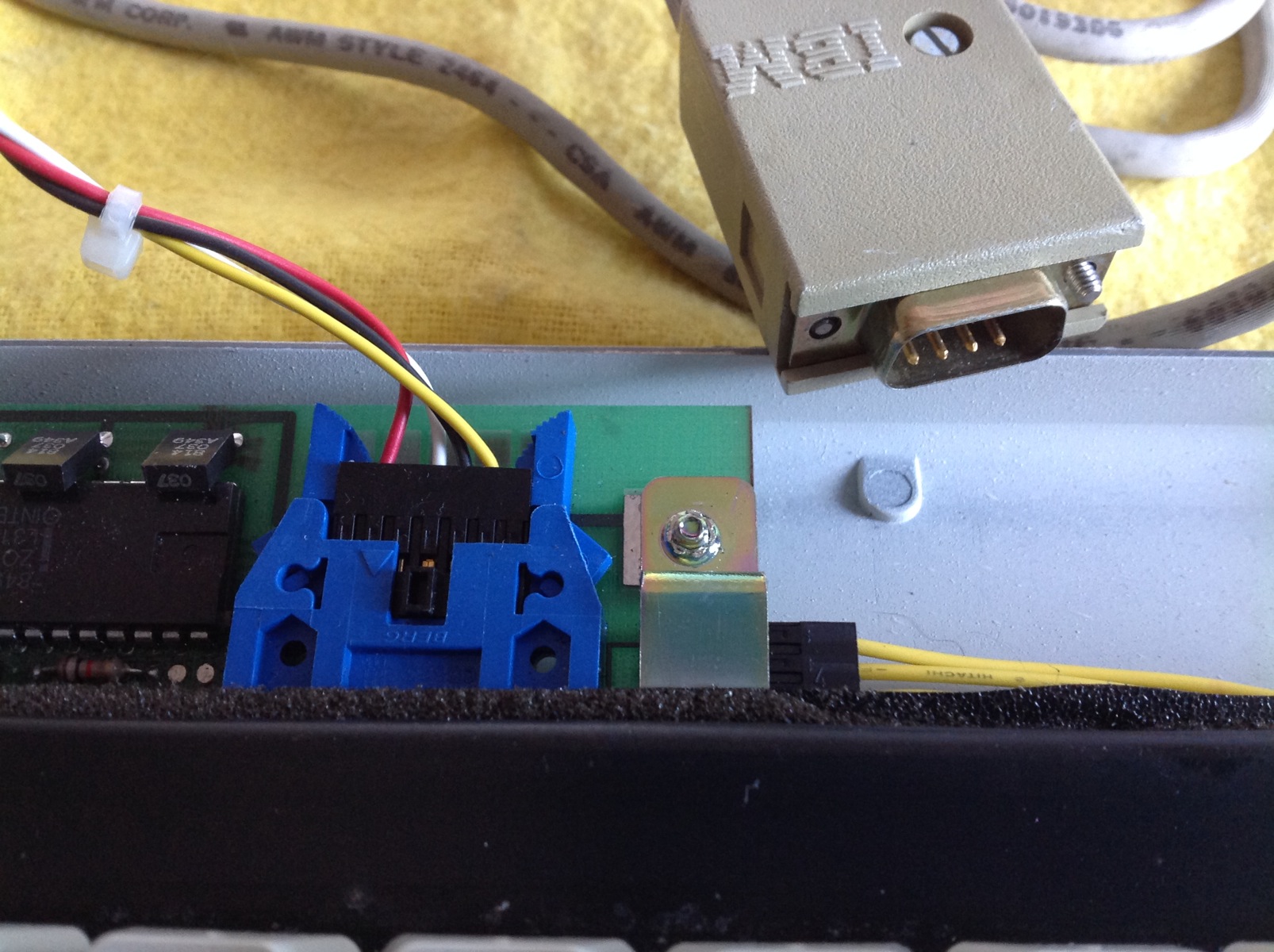

Okay, just taken the case off my Kishsaver, and what do I see? Different cable colours!
Something's Kishy.JPG (429.58 KiB) Viewed 13587 times
Mine is a late dated one (1986) with some differences to the other three Kishsavers I've seen (I proxied for Tinnie, and I took photos when I had them, which I need to wiki…) so I expected there could be interesting times ahead.
I've tested the pins on the cable, and 2 goes to white; 3 goes to red; 4 goes to black, and 5 goes to yellow. Reckon I'm safe following your pinout above? I wonder if they monkeyed around with the controller as well as the cable!
Soarer
16 Feb 2014, 15:41
Yeah, along the top row of pins, from left to right in that pic it's: nc, +5V, nc, GND, Data, Clock, nc.
16 Feb 2014, 15:44
Cool, that's my interpretation too. Let's try this out…
rindorbrot
16 Feb 2014, 15:50
Mine ('82) has the same cable colours as snoopy's.
Also what Soarer says is my observation, too.

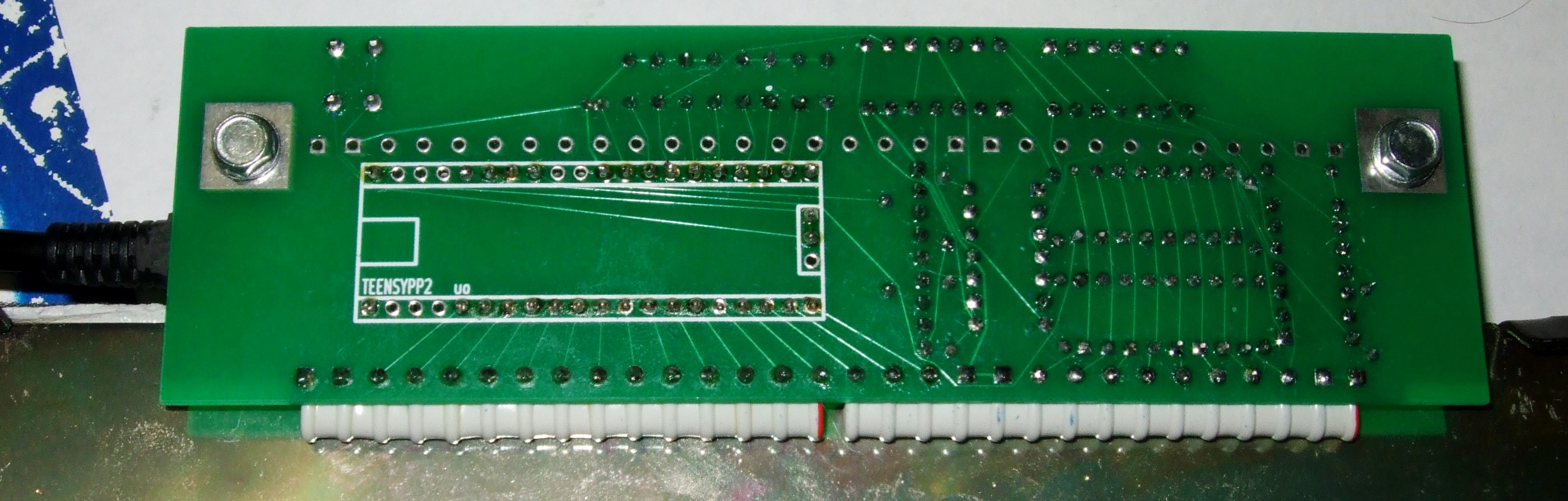

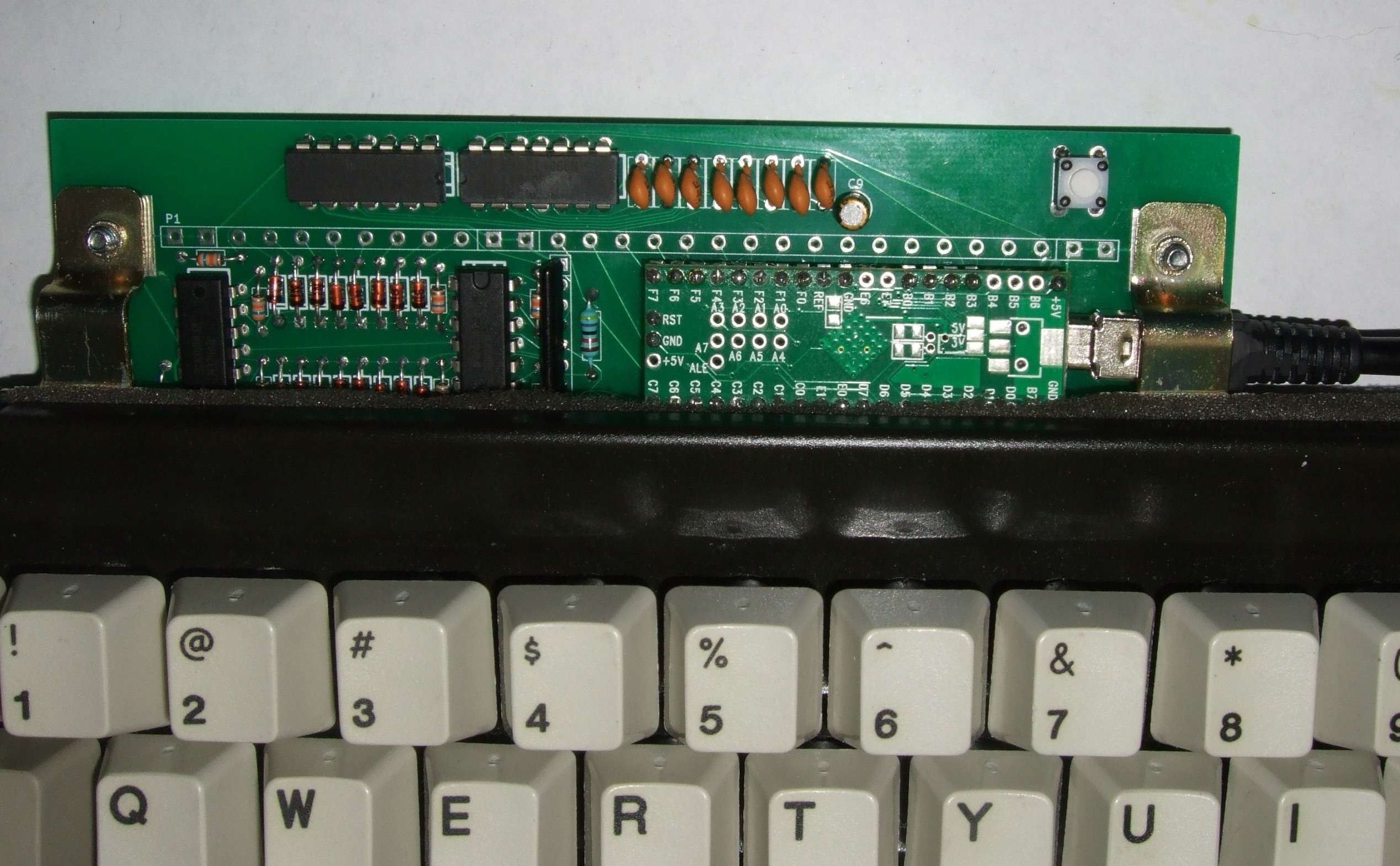

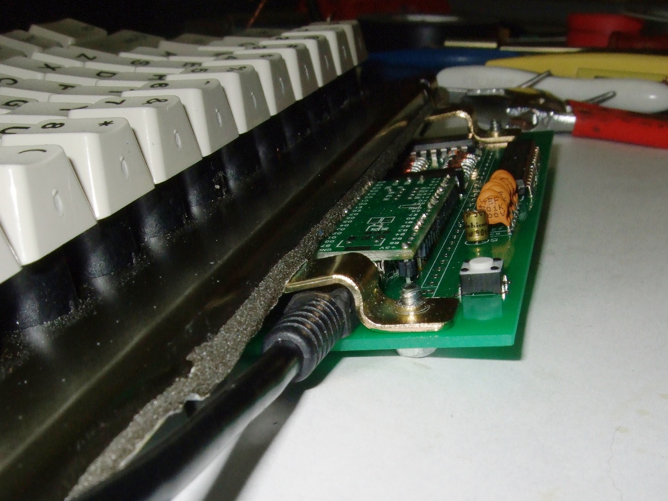

02 Jun 2014, 05:05
I built mine and and am here to report.
The toughest part was getting the ribbon cable off of the old controller. After spending about a half hour on that and getting nowhere, i gave up and just cut it as close to the controller as i could. It worked out just fine. More on that in a minute.
Take what I advise here with a grain of salt. I am not an expert with a soldering iron - in fact, i suck.
My assembly order was from shortest component to tallest. I started with the diodes, then standard resistors, the chips, switch, resistor array, then capacitors. The diodes, chips, resistor array, and that one odd capacitor have to go in one specific direction; don't put these in backwards or it will not work. This is where i stopped to take the picture in my last post.
Parak used diode leg trimmings to mount his Teensy; I chose to use standard header pins. I only had 32 instead of the 43 that there are holes for, but this turned out OK - the controller only uses 31 pins. I soldered the pins onto the Teensy first and then checked the fit on the PCB. It looked really tight, so i mounted the controller in the keyboard to get a better idea. The Teensy comes very close to the barrel plate, but does not touch. But the opening for the USB cable was too small for my cable to fit inside. It turns out that this is a known issue - some mini USB connectors have larger heads than others. The smallest ones will fit with no problem; average size and larger need to have the the casing trimmed off. I kept the controller mounted and with USB cable connected while I soldered the Teensy onto the controller PCB so that i was sure that they would fit properly.
The final step was to connect the ribbon cable. I cut the old controller off, so i now had to strip some insulation from the cable. I used a razor knife to cut a line about 5mm back, flip the cable to the other side and cut on top of the first cut; use tweezers to grab a spot of insulation between the wires and pull. I tinned the wires to prevent the strands from splitting as i fed all 30 through the holes on the controller PCB (the second toughest part of building this).
And pictures.
DPH side.JPG (423.62 KiB) Viewed 12828 times
DPH bottom.JPG (532.21 KiB) Viewed 12828 times
DPH top.JPG (789.33 KiB) Viewed 12828 times
