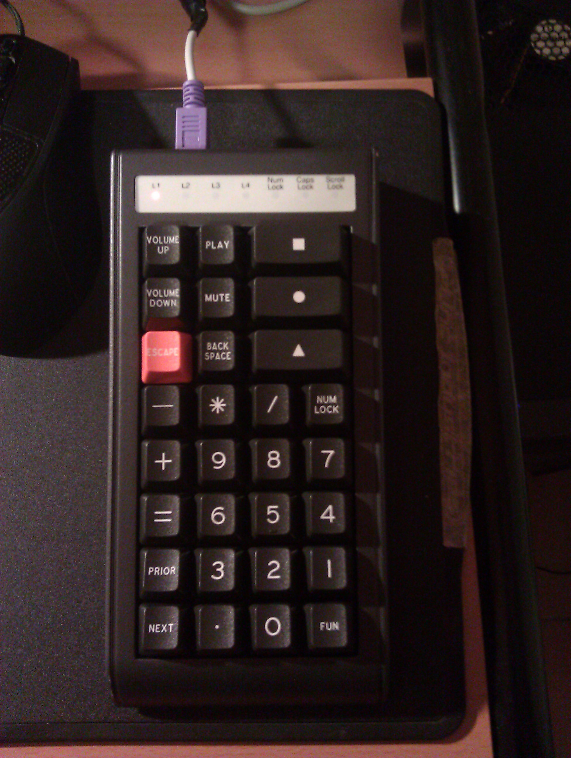

- tipro_mid_001.jpg (284.51 KiB) Viewed 9222 times
- Main keyboard: Tipro split
GAH! Haven't gotten mine yet. You guys aren't making the wait any easier!
To wire them together, I think you need to open the side of the unit or something and connect the 6-pin connector directly in to the slave module of the other unit? Haven't really understood it completely. This document might be of help : http://www.perimatic.fr/documentations/ ... ew.pdf.pdf

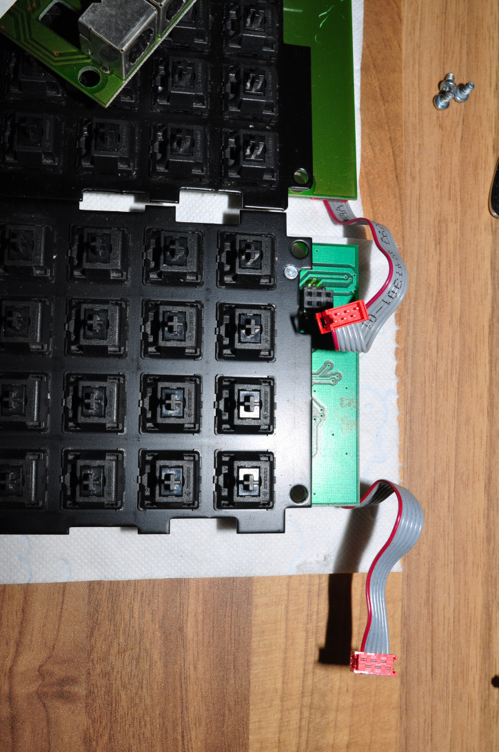

The cables with the red connectors do the trick!intealls wrote:kbdfr, do you know if you have to use the small internal 6-pin connector to chain these modules together?? Or is it possible to connect them some other way?
- tipro_202.jpg (280.43 KiB) Viewed 9208 times

You can chain Tipro keyboards by plugging the first one into the computer (Tipro 8-pin to PS/2), the second one into the first one (Tipro 8-pin to PS/2), the third one into the second one (Tipro 8-pin to PS/2) - I did not try more yetintealls wrote:kbdfr, do you know if you have to use the small internal 6-pin connector to chain these modules together?? Or is it possible to connect them some other way?
This way you can operate the keyboards, but only the first one will be recognised and can of course be programmed by the ChangeMe software.
You can connect several keyboards using the Tipro bus (a small, short flat cable plugged onto the PCB of both boards). Obviously only one of them is connected to the computer.
The ChangeMe software recognises and of course programs all keyboards connected this way (I had up to four modules).
Every Tipro keyboard I had so far contained (at least) one Tipro bus.
Edit: good picture showing a Tipro bus, thanks

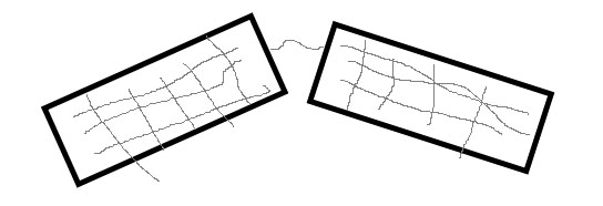

I plan on using two of them to make one complete keyboard, as depicted by the attached picture, so I think I'm going to have to come up with a way to make the connection external, perhaps jack the existing PS/2 connectors??

intealls, I'm planning the same, and I was going to connect them with the "tipro-cable" -> ps2 approach. Can't program the second module on the fly, but they'd be maneuverable.
Cool, it's a great idea
I *think* the problem with that setup would be that the modules are not able to share the same layer configuration, so if you shift to layer 2 on device one, device two will not shift to that layer. I need them to share the layer config :/

- modules do not share Shift, module 2 will affect module 1 but not the other way round. In other words, the command works towards the computer but not inversely. So Shift+a on any module will deliver A, Shift(module2)+a(module1) will deliver A, but Shift(module1)+a(module2) will have the effect of blocking output as long as Shift is pressed and then delivering a. - "intern" connection (module 1and module 2 connected via Tipro bus):
- all modules are recognised by the programming software and can be programmed;
- all modules share everything. Shift(any module)+a(any module) will always deliver A. In fact, all modules together act as one keyboard.
In my opininon the best solution would be to install a socket on the small removable cover at the rear of the keyboard (which obviously is prepared for adding such a socket, PS/2 size) and connect it to the Tipro bus. The Tipro connector itself could be used for units up to 8x8, bigger units would require a somewhat longer internal cable. This solution would have the advantage of leaving the keyboard itself completely unaffected otherwise and of allowing swapping between any Tipro keyboards.
If anyone has the necessary skills, I'd be interested in six units, please
