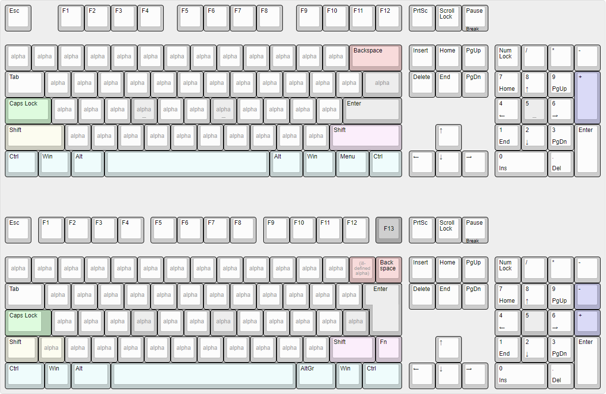

When it comes to typical MX-mount keycap sets, as they pertain to the full-size and tenkeyless form factors, very much all of the sets that are being produced nowadays fully support (with one exception, see below) the following variations in physical layout:
Universally or nigh-universally supported physical layout variations on modern MX-mount keycap sets.
In no particular order:
  1. Non-stepped Caps Lock OR stepped Caps Lock (the switch position underneath changes, so this needs to be taken into account!)
  2. 2.25U left Shift (ANSI, ANSISO) OR 1.25U left shift and 1.0U alpha (ISO, ISANSI).
  3. 2.75U right Shift OR 1.75U right Shift and 1.0U Fn ("HHKB-style" or "right-side Split"; "left-side split", as used in ABNT and JIS keyboards, is almost entirely unsupported).
  4. 2.25U horizontal Enter and 1.5U alpha above (ANSI, ISANSI) OR vertical 1.25/1.5U Enter and 1.0U to its left (ISO, ANSISO).
  5. "Modern" (1.25U×3 / 6.25U / 1.25U×4) OR "tsangan" or "winkeyless" (1.5/1.0/1.5U / 7U / 1.5/1.0/1.5U) bottom row.
  6. 2.0U Backspace OR two 1.0U keys (the right side one should be Backspace in this case).
  7. Homing OR non-homing F, J and numpad-5 keys (this does NOT affect the switch underneath).
  8. 2.0U numpad+ OR two 1.0U keys in its place.
  9. Normal function row OR the same plus an "F13" key crammed in (this one has decent support, but hasn't become "universal" yet).
Quite few sets will provide for one or two extra "macro" columns to the left of the main alpha block (typically M1..M5 or M1..M10, instead of the proper and good EF1..EF10). Exceedingly few sets will provide the F13..F24 keys (okay, F14..F24). BAE (not pictured) is barely supported, and if it's present, it's for plain BAE instead of Focus-BAE. TIE Enter (not pictured) is very poorly supported.
I'm skipping over 60%, 65%, 75% and other form factors, for the obvious reason.
So, given that Ellipse's stated objective is to mount MX-style keycaps on the beamspring switches, the known limitations in current custom sets should be taken into account.
What would I want? Within the given restrictions, for me ISO support is a must; "tsangan" bottom row is highly desirable, right-split Shift and split numpad+ are desirable; F13 and split Backspace I don't care for; stepped or non-stepped Caps Lock... can be decided by flipping a coin.

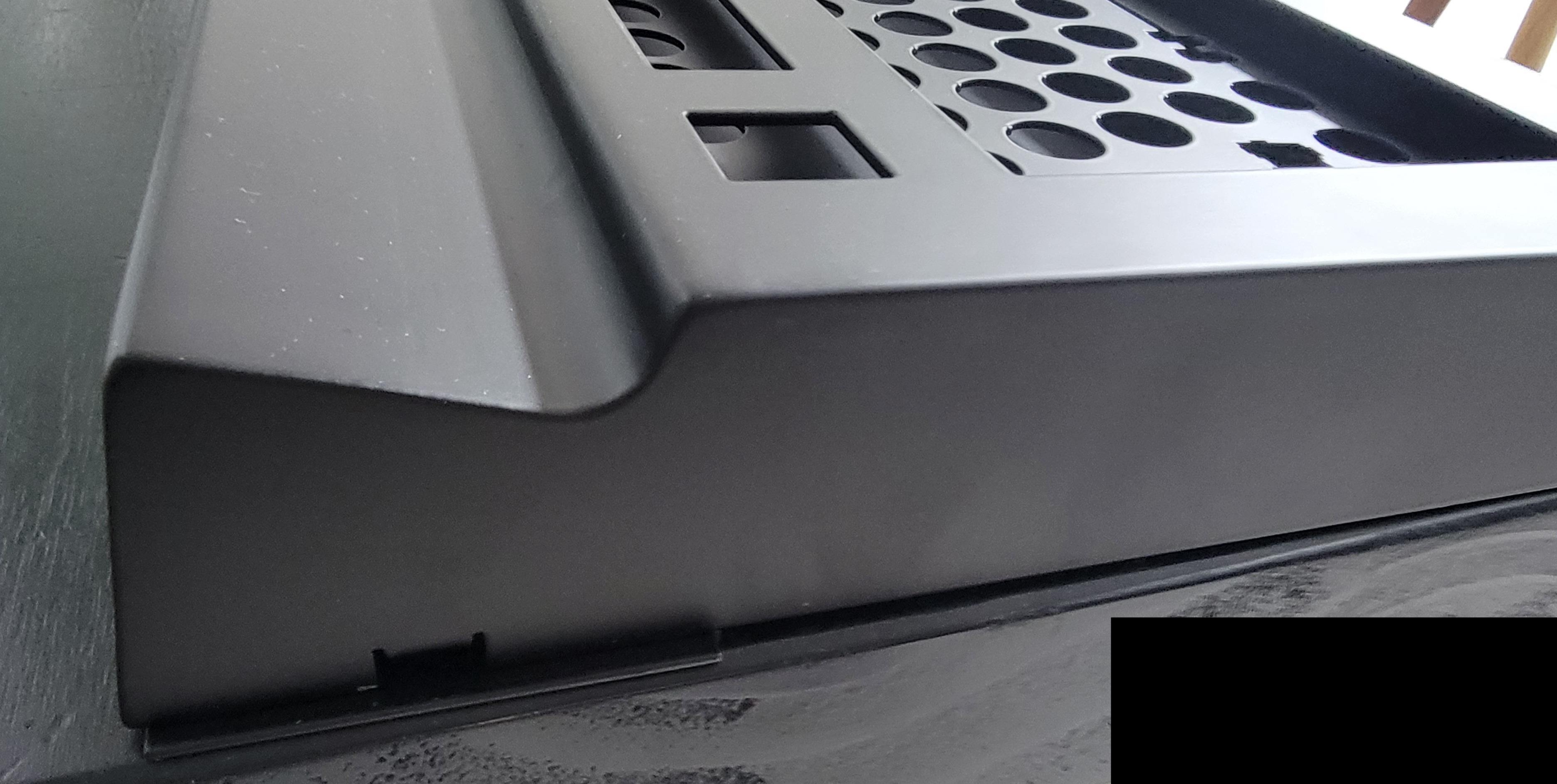

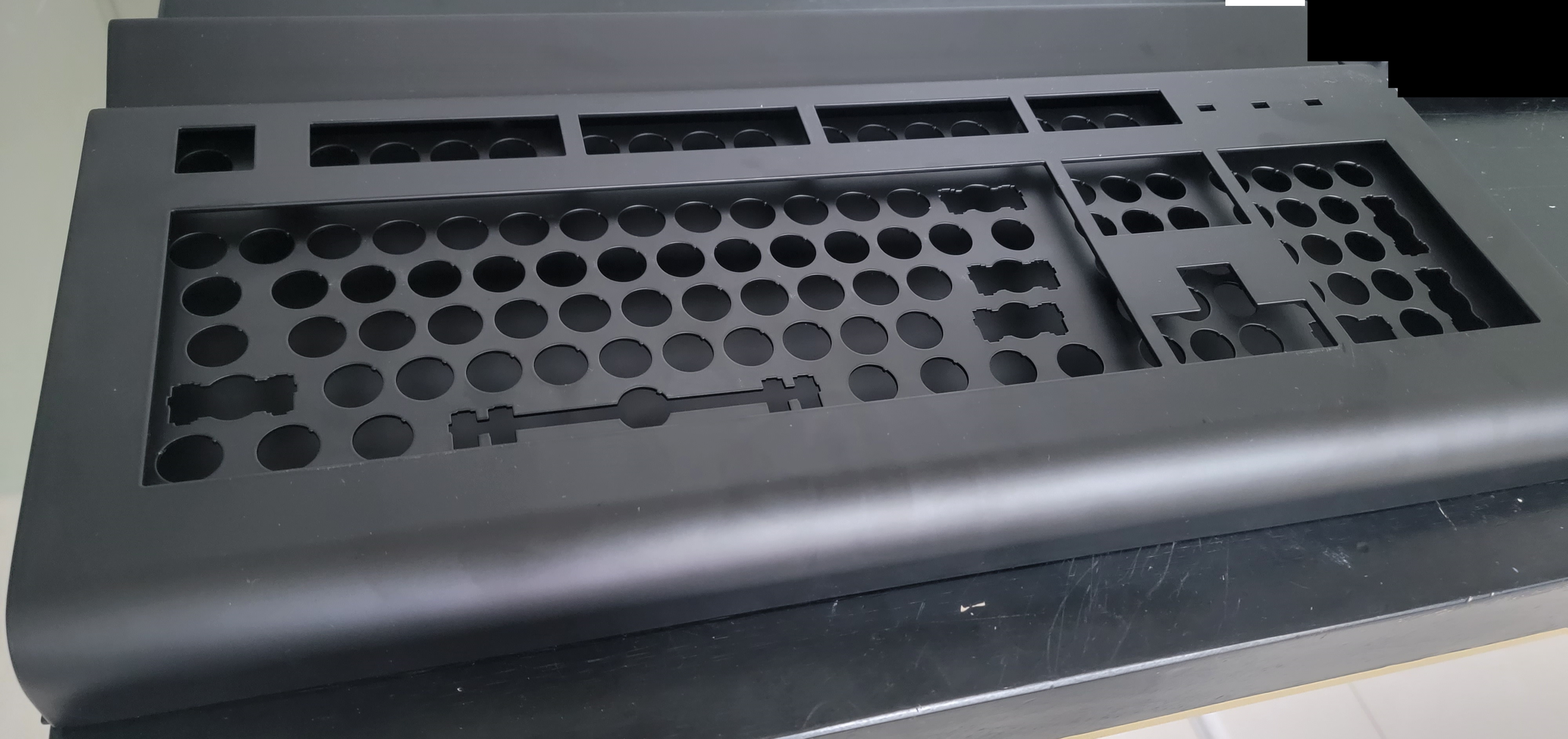

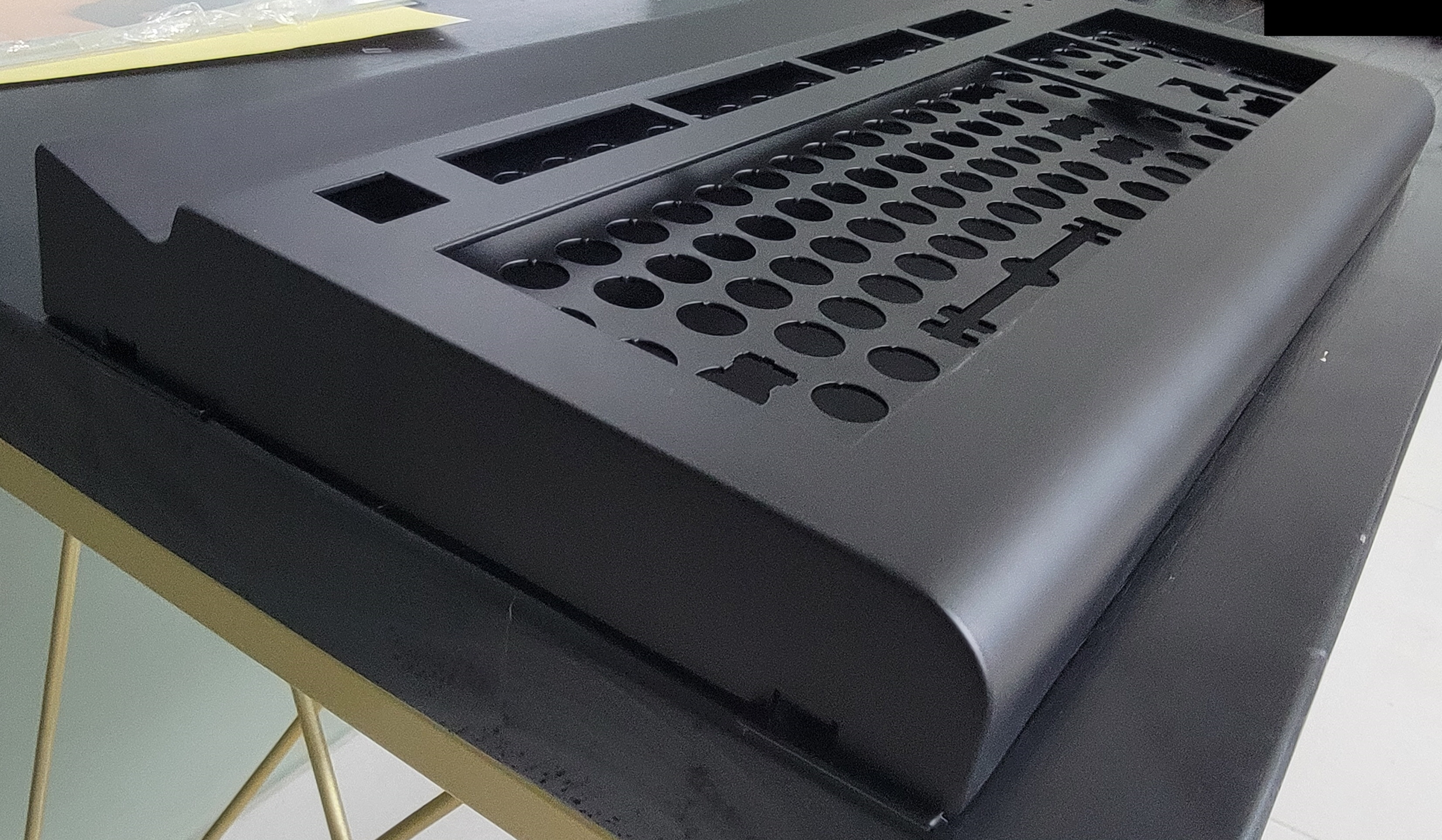

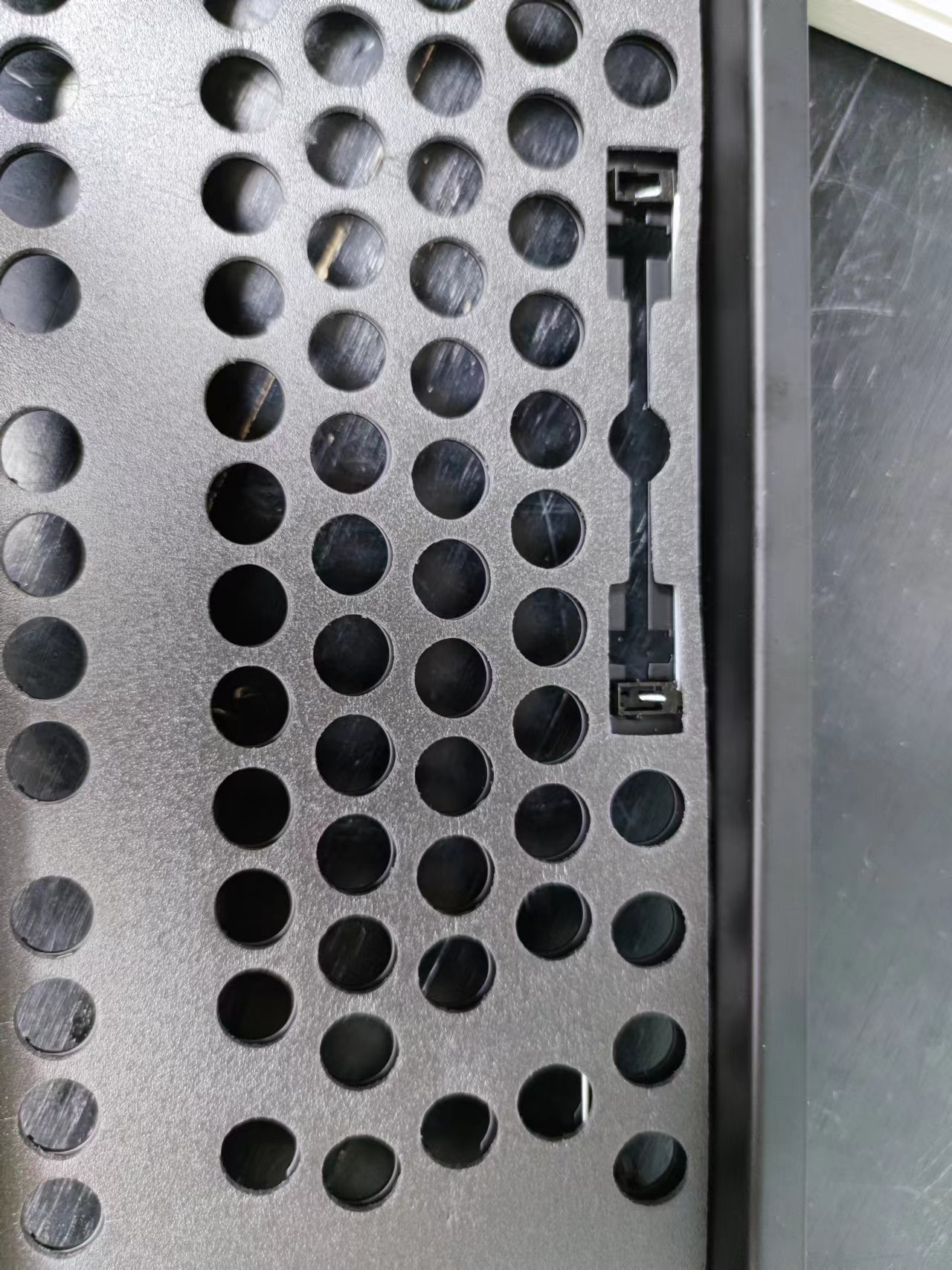

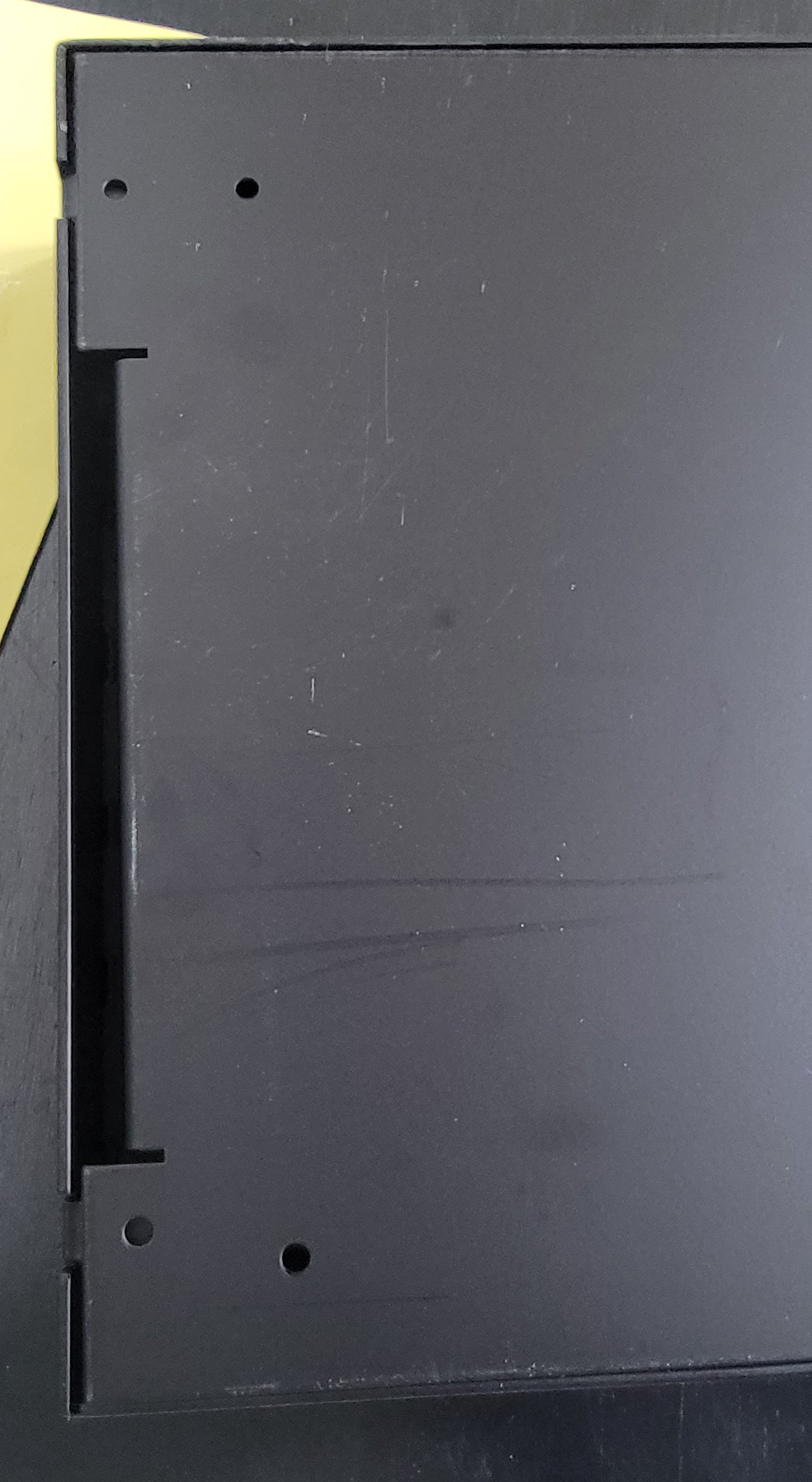

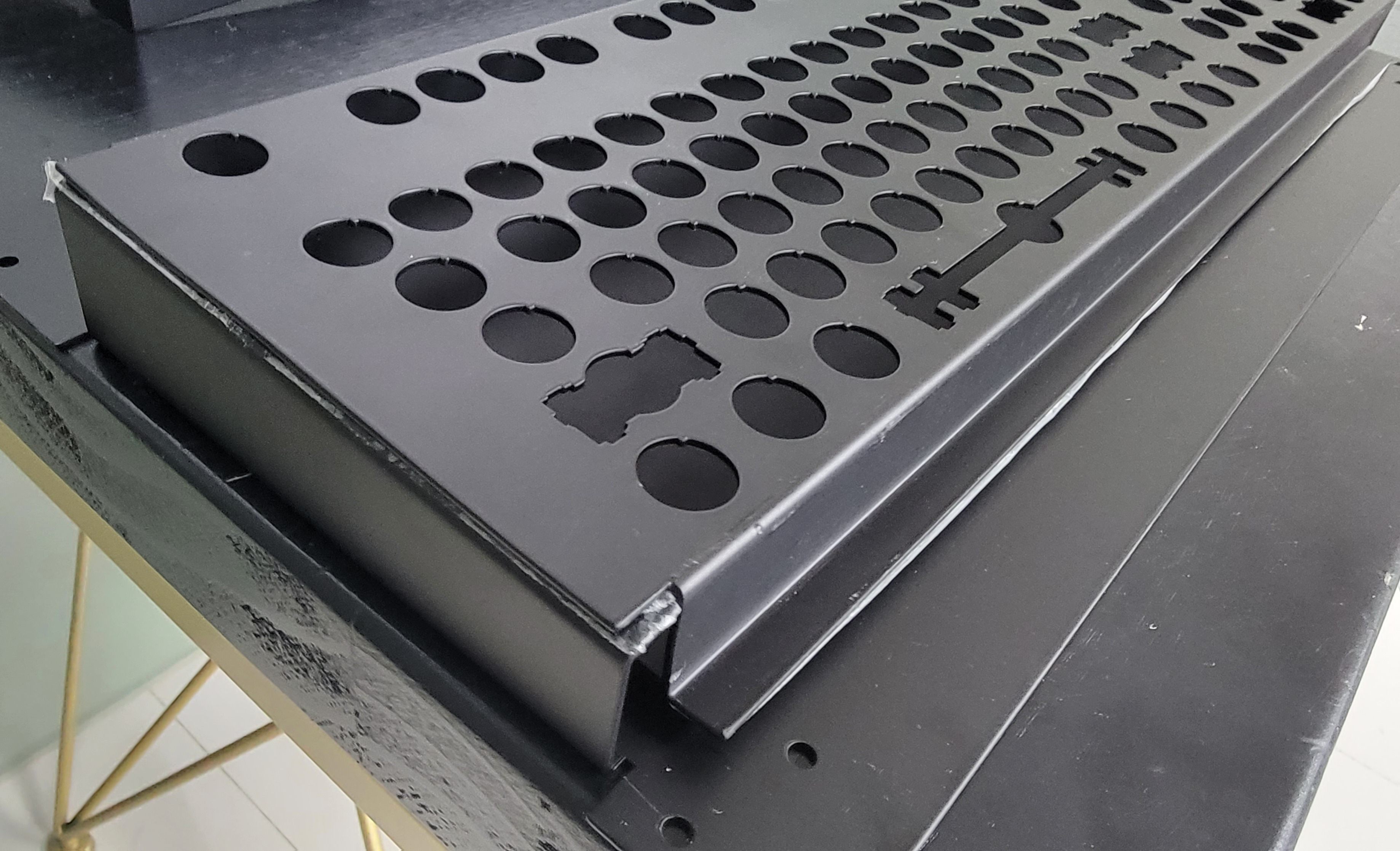

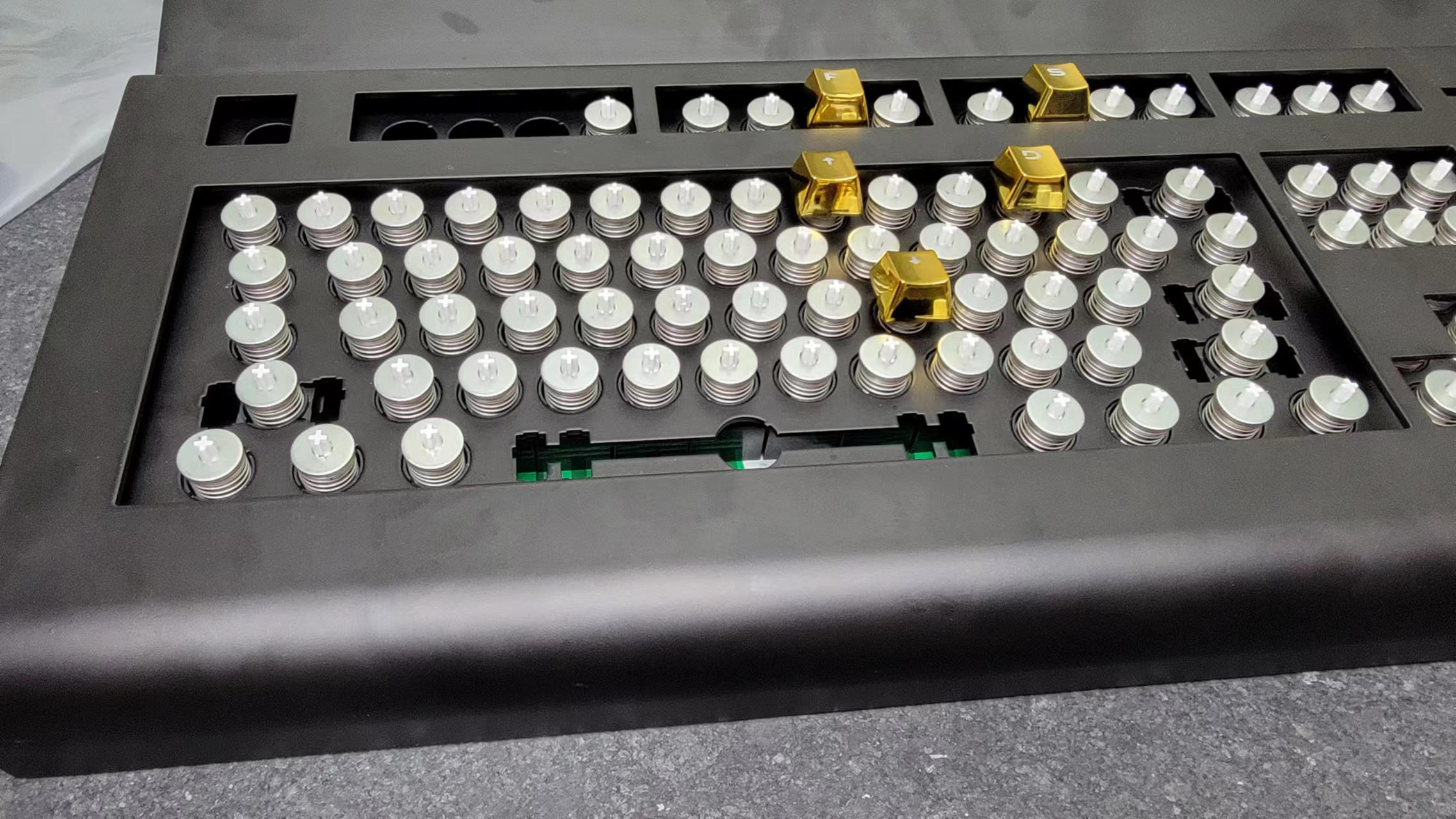

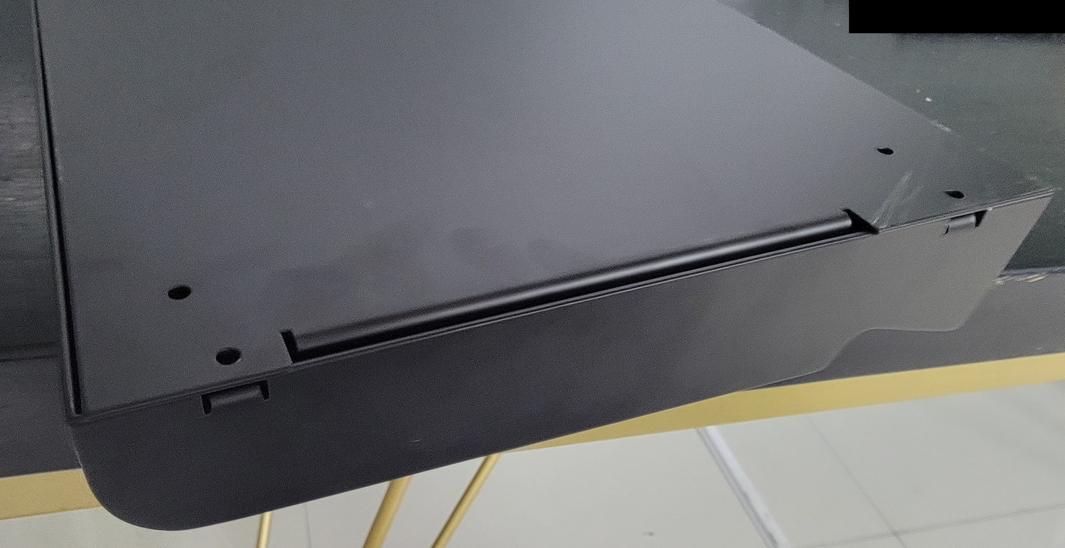

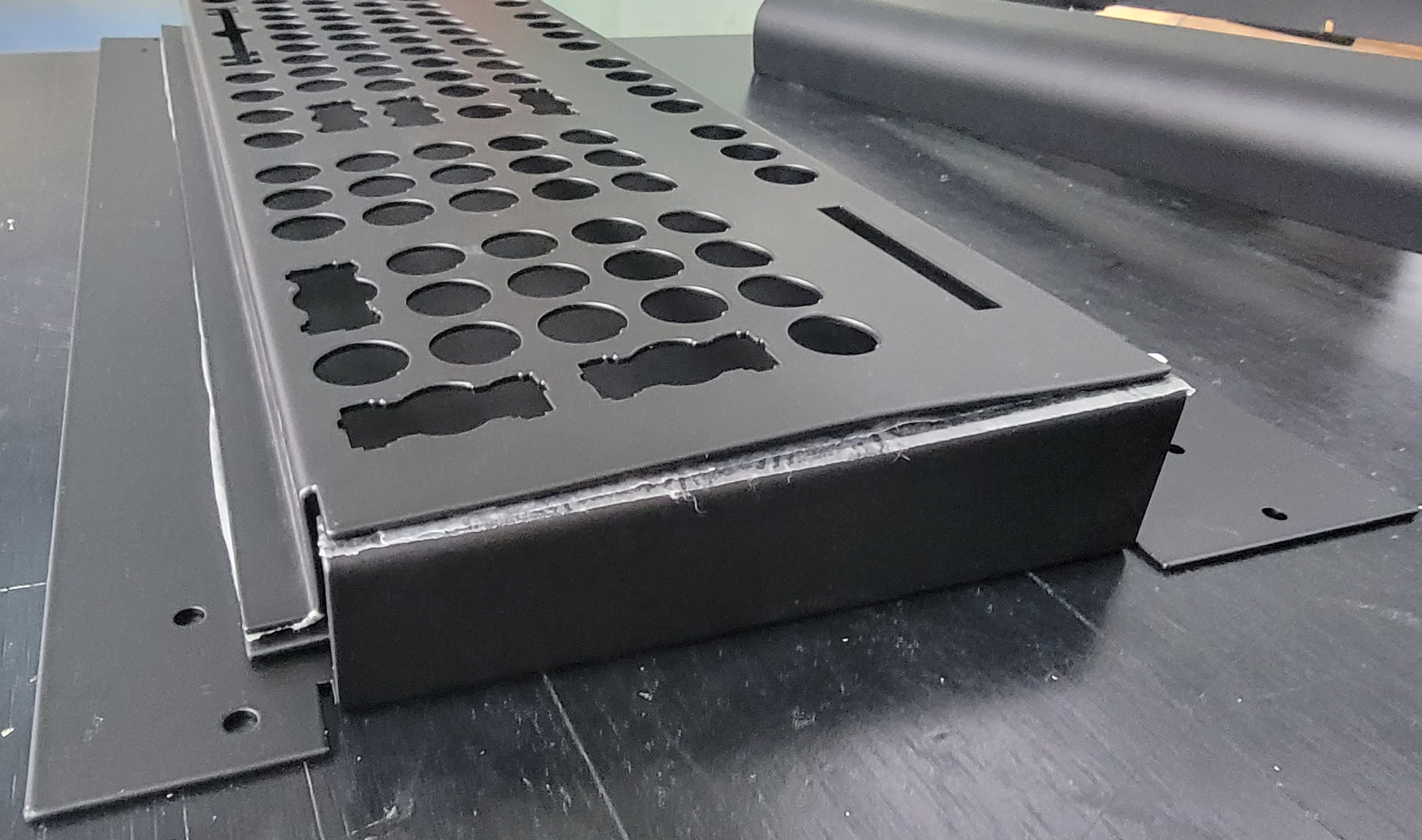

We are about 4-8 weeks away from me mailing out the remaining Model F keyboards in the backlog! A little over 500 keyboards plus many non-keyboard orders.
Here are the first photos of the prototype beam case and the top and bottom inner assembly plates. They will be making a full prototype with these parts before we proceed. As noted before this is just a test to make sure everything will fit together and work together. The design is likely to change (an angle to the case was added but not for this sample, etc.) and I'm not sure yet if I'm making molds for a few beam cases so you can pick a 3278 style beam spring for yourself or a 3101, etc. Each case style will also have different layout options ideally so there may be a 104 style and a less wide SSK style case.
These are just powdercoated smooth black for the tests as opposed to the bumpy original style texture expected on the finished products.

Ellipse wrote: 12 Jul 2022, 05:30 Here are the first photos of the prototype beam case and the top and bottom inner assembly plates. They will be making a full prototype with these parts before we proceed. As noted before this is just a test to make sure everything will fit together and work together. The design is likely to change (an angle to the case was added but not for this sample, etc.) and I'm not sure yet if I'm making molds for a few beam cases so you can pick a 3278 style beam spring for yourself or a 3101, etc. Each case style will also have different layout options ideally so there may be a 104 style and a less wide SSK style case.
Excited to see this coming along! (don't forget ISO support, though) Also, I can't wait to hear this with the solenoid on. :mrgreen:
With that said, I'll be that guy and mention that this posterior section:
That section.
That section.
Strikes me as gratuituous, and would drive up the cost/price (plus footprint) for no real good reason. I understand the desire to evoke the beamsprings of yore, but a functional case would be better, and the desired looks would be better evoked with the proper case color (something I have no doubt Ellipse can pull off, as we've seen with the Model F repros) and a good choice of MT3 keycaps. IMNAAHO.
tiltowait
15 Jul 2022, 00:12
Very much in the eyes of the beholder. I, for one, am far more likely to buy it with that "posterior section" :)
thefarside
15 Jul 2022, 05:32
I like it and wouldn’t mind a large back section to hold stuff like pens, stickies and an iPhone. A low profile case would be great but I imagine this must be the lowest you can go with beam springs.
xxhellfirexx
15 Jul 2022, 11:10
thefarside wrote: 15 Jul 2022, 05:32 I like it and wouldn’t mind a large back section to hold stuff like pens, stickies and an iPhone.
It can also be a place to put a battery pack to enable Bluetooth mode and also a USB hub.
15 Jul 2022, 12:49
Even an HHKB Pro 2 has enough space for a Bluetooth battery *or* a USB hub, Okay, not both, but this entire keyboard is about that same volume, and it's a whole working keyboard! :D
All that extra metal/work will be pricey. I'd keep it compact if I were running this thing, instead of burdening everyone with the added cost. Plenty of room inside the main chassis for user mods like USB hubs. I know from my little 3278.

I think the case looks fantastic!

The prototype case is looking really nice! Looking forward to seeing it with some switches and keycaps as well.
I know that it isn't finalized but is it possible to list the overall dimensions of the prototype case with the keycaps in place?

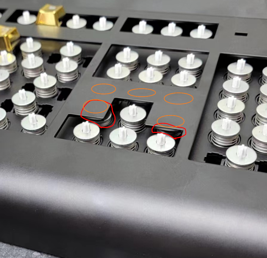

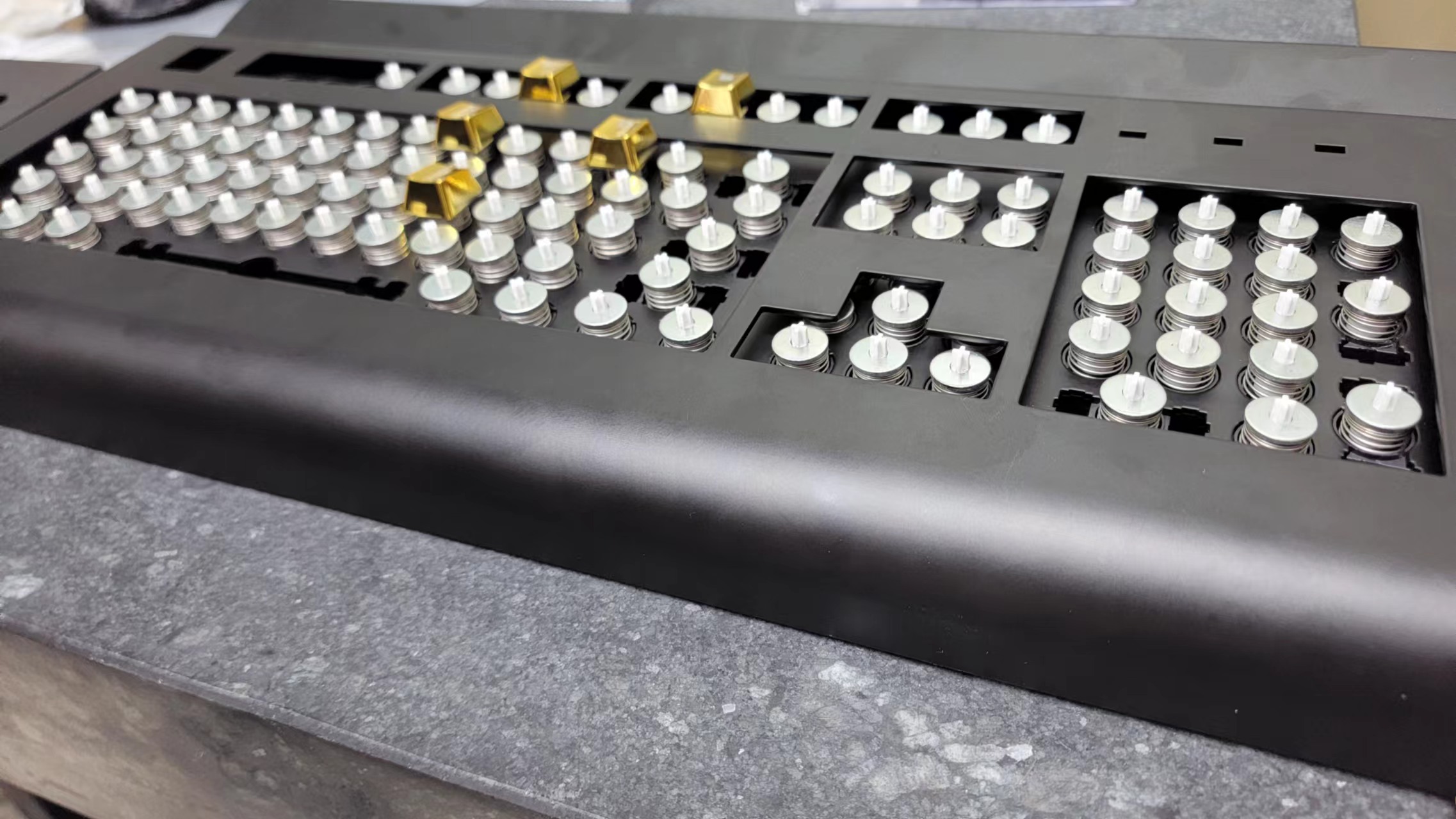

And here is the sample beam case populated with beam modules. As noted before this is likely not the final design as I expect to go with separate cases, one based on each of the most well-known beam case designs (3278, 3101, 66-key, etc.) if feasible.
The first two photos show the keyboard installed without the new top inner foam that goes between the top of the beam modules and below the top inner assembly plate. This was more like my first beam round design.
The third photo shows the new prototype foam installed inside the top inner assembly. The purpose of the foam is to reduce the reverberation sound and make it sound closer to the originals.

Those look absolutely gorgeous!

Does this mean that we'll be able to fill up the nave cluster area instead of just having dead space there?

Yes those keys will have pads and cutouts for the beam 104 and smaller keyboards to drop in the beam modules, so you can cut away the aluminum case if desired and add some modules (looks like they installed some modules underneath those spots in that photo by mistake). Same as with the F77/F62 having the black tape covering the hole to use the smaller space bar on all of the keyboards except scumnc which uses the smaller space bar exclusively.
Of course they cannot be populated with the beam 122-style keyboards which will likely have 128 keys already used (104 keys for standard ANSI + 2 additional for ISO short shift < > and ~ # key to the left of ISO enter + 12 F13-F24 keys + 10 keys for the left side block), as 128 is the maximum allowed on a 16x8 matrix. I am open to someone submitting an updated controller design to allow for an additional optional column - maybe Rico's new RP2040-based controller will allow for this - though it might be tricky with maintaining backwards compatibility (maybe a solder pad to switch it from being an extra column to being a ground column?). Compromises will possibly be needed for those wanting to order custom layout 122-style beam spring keyboards, especially if they want additional keys like splitting the backspace, etc.
