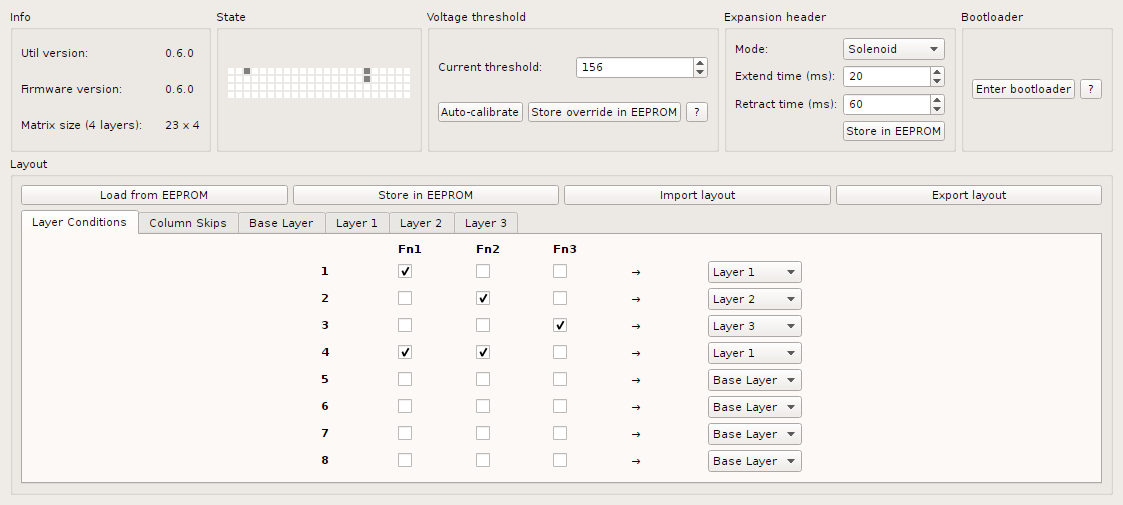

Here's version 0.6 of source and schematics.
New stuff is mostly concerned with supporting the Model Fs and Beamspring Displaywriters in the same codebase, and of course the schematics and PCB layouts for those new controllers.
Concerning the standard beamspring specifically:
- Rev4 controller (schematics/PCB/firmware support)
- Revamped GUI layout to be less horrendous
- Support for solenoid driver (you will need the solenoid driver board, and a Rev4 controller, with the expansion port, unless you want to do some crazy ninja soldering directly to the ATmega32U2)
- Support for LEDs through that same expansion port
- Allows column skipping if (like with the 5251) you don't have any keys on that column—would speed up scanrate marginally
- Slightly slower overall scanrate for more noise robustness (solenoid can make scary stuff happen)
- Tweaked autocalibration, result will probably end up a bit higher
- util_0.6.png (53.23 KiB) Viewed 13896 times

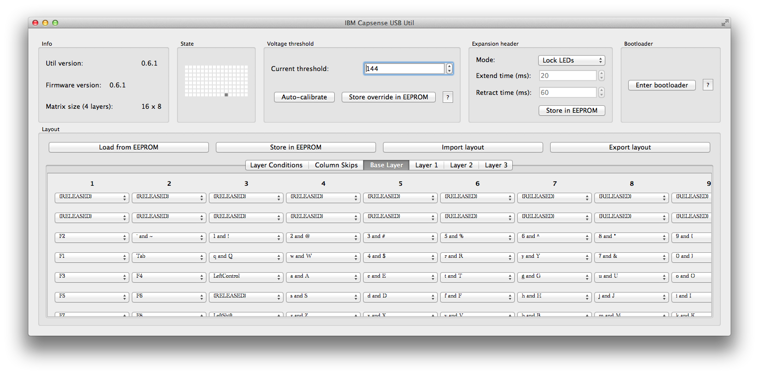

And here is v0.6.1.
This fixes a reasonably major issue on Windows 7 64bit (I think?) which had major issues with the two keyboard descriptors (the fake padding of the boot-mode 6-key only interface was freaking it out and causing the NKRO descriptor to get sent STALLs).
There was also a major bug in the GUI util which prevented 8-row keyboards (Model Fs and Beamspring Displaywriters) from displaying their top four rows of scancodes on layers 1–3.
There was also a minor padding bug in the descriptor for the NKRO interface with the addition of the LEDs; neither Linux or Mac OS X cared, but it really annoyed Windows.
I've also got binaries compiled on Windows and Mac OS X, along with pre-compiled hex files for all the variants so far.
As always, use the old version of the util to put the keyboard into the bootloader first, then flash the keyboard. Afterwards, use the new version of the util to talk to it. Make sure you pick the right hex file to match your board type and revision!
You can download them all here: http://linode.cornall.co/ibm-capsense-usb/0.6.1/
- Screen Shot 2014-05-09 at 2.04.43 pm.png (153.02 KiB) Viewed 13876 times

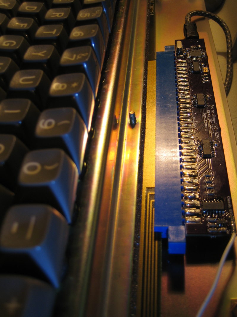

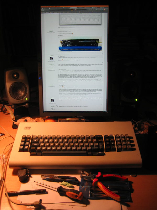

And another one:xwhatsit wrote: Well done! One more beamspring dinosaur clunking away
It being a rainy saturday afternoon, I finally got around to soldering the other two rev 3 boards I had the parts for, and putting one in my 3727. This time it was pretty painless; the soldering and uploading and configuring just worked ! The 3727 is even better to type on; it feels much more solid and high-quality, even though the 5251 doesn't exactly feel sloppy at all. I only have one key that sticks down once in a while (physically, that is), so that will be a good excuse to open it up (again).
Which leaves me one Rev 3 board, but am I right to think that I might be able to use that controller in my Kishsaver, using the new firmware and some creativity to connect the leads ?
I would be willing to try to solder a lead to that processor pin, and perhaps I'm overconfident now, but I'd think that soldering two leads should be doable too ?xwhatsit wrote:Yes I've been mulling that over, the best way to handle that—with the Rev3 board, there's four pins on the right-hand-side of the microcontroller that are completely unused. If I set up the pins in such a way that one of the middle ones was an output and the other three were set as floating inputs, then you wouldn't need to be particularly careful with the soldering at all. You still need Vcc and GND of course though, which maybe would be easiest to steal off one of the bypass caps?quantalume wrote:I have an extra Rev3 controller for anyone who doesn't need the solenoid capability. Actually, it wouldn't be that hard to solder a lead onto the processor pin to drive the solenoid board, which I intend to do at some point.
Technically the solenoid driver board requires two signals, `enable SMPS' and `fire solenoid', but you might be able to get away with bridging the enable SMPS signal just to Vcc (just technically not to USB spec, as will draw more than 100mA before it's enumerated).

Nice job! I see you have a 5251 and a 3727—the 3727 is my favourite too, it just feels smoother and tighter somehow. I wonder if they're all like that?
Unfortunately it won't work in your Kishsaver—I had to start design a new board etc. for Model Fs (and also beamspring displaywriters). This is because the Model Fs and Displaywriters have a 16x8 matrix instead of a 23x4. So you need double the analogue stuff (so an extra LM339 and all the associated stuff).
If you want a Model F board I'm about to put up all the details regarding that today hopefully (well, once the lawns are mowed and I've fitted a new clutch cable and....), with links to the board on OSHPark and a proper BOM.

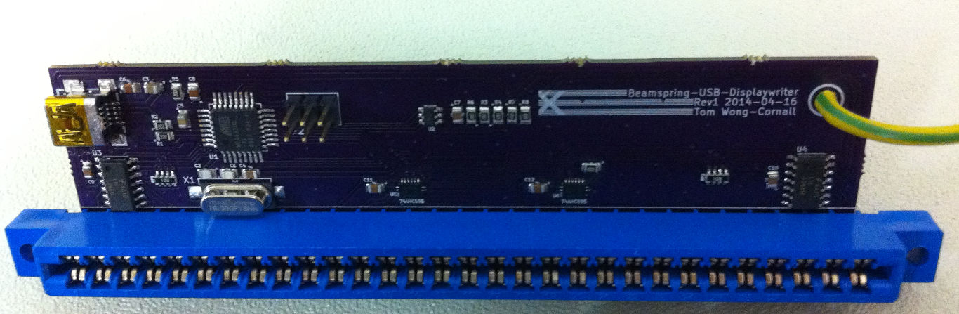

Yes I'm intrigued by these. I'm going to send off the first Rev1 Displaywriter controller of to Dorkvader tomorrow, so hopefully these will be USB fair game shortly too
