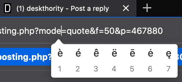

swedishpiehole wrote: 09 Jul 2020, 14:02 I tested key repeating after flashing QMK and got some interesting results. Delete, backspace, enter, tab, and all punctuation keys repeat infinitely when held down. The number keys do not, unless I hold down shift before pressing, in which case I can get, for example, $$$$$$$$$$$$$$$$$$$$ or ^^^^^^^^^^^^^^. The alpha keys don't seem to repeat regardless of what I do. Is this the intended result? Can someone else check if they get the same repeating with QMK? I mean, I'm not complaining—I actually want repeat on the backspace and delete keys. I'm just curious.
In macOS that's the intended behaviour. When you hold down certain keys, you should get a popup allowing you to pick a variant of the selected key.
If you want to force the auto-repeat on all keys, you can enter the following command in the terminal:
defaults write -g ApplePressAndHoldEnabled -bool false

Ah awesome, good to know! I should probably have realized that myself....
So that being resolved, that leaves me with a delete key that registers too slowly and goes straight into autorepeat, and a major problem with QMK when momentarily switching to a layer strands me in that layer...
