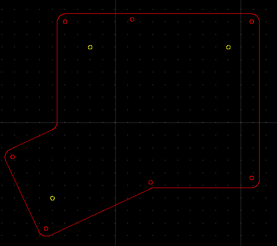

Posted: 12 Oct 2012, 02:02
by litster
I am thinking potentially use the same aluminum feet I have from my KMAC and MX Mini, 3 on each side at (top left, top right, and lower left - for the right hand). These feet are about 2cm tall with rubber feet. And then I would use a small rubber feet for the lower right corner. So the 3 yellow circles would be the high points and slope down to the lower right corner.

Posted: 12 Oct 2012, 02:12
by dox
One of the 3 feet (upper left) from the KMAC need to be taller then the other 2 to have the slope that you want. This is the slope I'm using at work with my 2nd shapeways case (I need to post pics of that) and it's very comfortable.

by litster
You are right. I can make that one taller by adding a thick aluminum disc to it.

by dox
With alu plates, you can drill/tap some holes in the bottom plate and get any slope by fitting different screws in those holes.
I tried a lot of different configurations and the best for me is a slope from the inner top to the outer bottom.

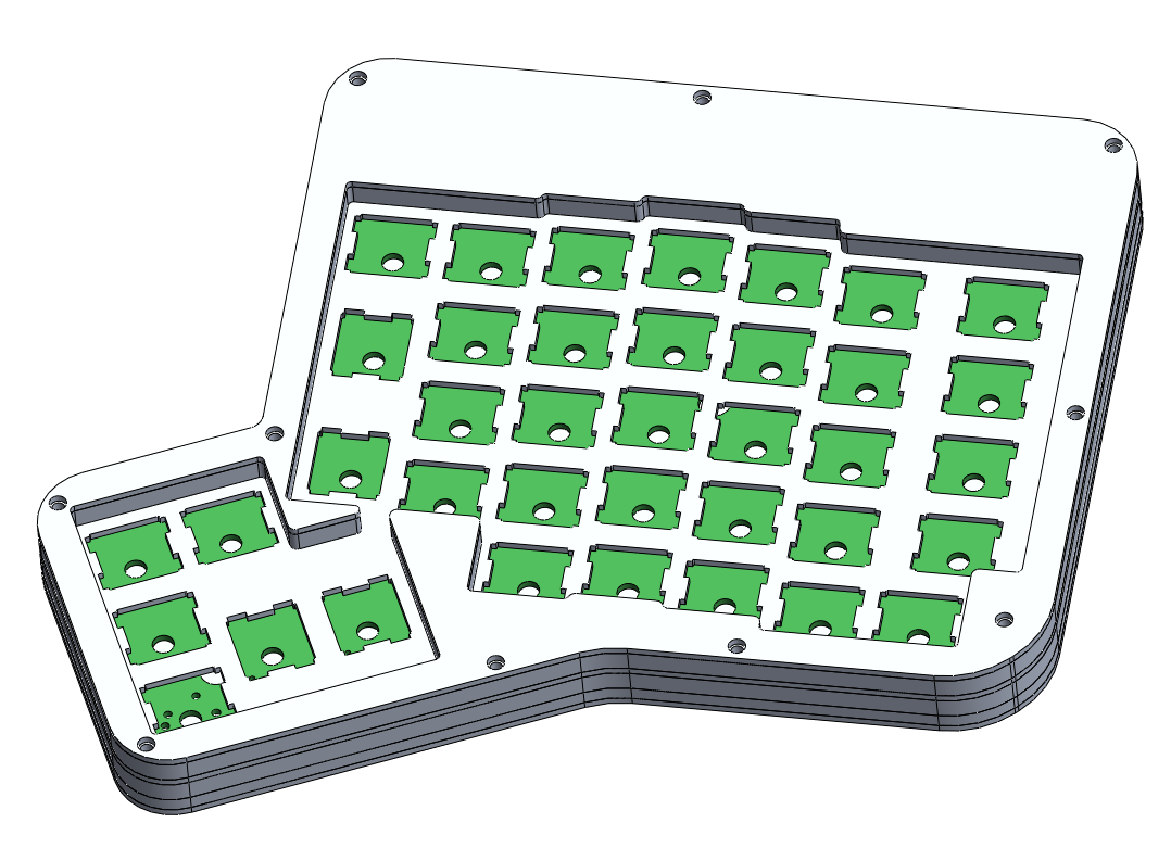

Posted: 12 Oct 2012, 05:22
by litster
Here it is. A couple of mistakes like the 3.5mm opening is too narrow, forgot the make room for the USB connector on the layers that sandwich the acrylic plate. I want to have a built-in wrist rest to the case as well. I will have to make all those changes for the next prototype.
Top view:
BTW, to use this case, you will need to solder SMD diodes or through-hole diodes on the bottom of the PCB. SMD diodes on the bottom is better as you would not need to worry about the diode legs sticking up from the bottom.
Posted: 12 Oct 2012, 05:54
by planet36
litster wrote:Here it is. A couple of mistakes like the 3.5mm opening is too narrow, forgot the make room for the USB connector on the layers that sandwich the acrylic plate. I want to have a built-in wrist rest to the case as well. I will have to make all those changes for the next prototype.
Top view:
Looks beautiful! I'm really stoked about this keyboard.
Posted: 12 Oct 2012, 06:06
by Vierax
wow ! that's great
I like this transparency case, everything should be like this (except clothes and walls : I'm strangely attached to privacy and intimacy :D)

Posted: 16 Oct 2012, 05:05
by litster
I have added a built-in wrist rest. Also now I have a proper top layer thanks to DOX.
click the picture to see the larger version that is not weird :-)
