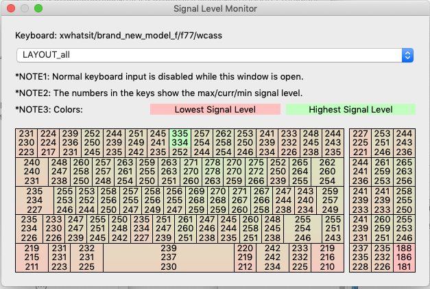

warty wrote: 29 Aug 2020, 07:33 My F77 came today! Yea! Some of the keys don't work... bummer.
The keys that don't respond... it's not the springs, and I don't think it's the hammers, as I can see that they move up/down with the springs.
I tried to run ibm_capsense_usb_util.app v0.9.0 (latest on the xwhatsit site). I'm familiar with this program because it's what I use in my beam spring. But it just freezes if I select either of the 2 devices (that aren't the beam spring). Disconnecting the beam spring didn't help either.
I PM'ed for an invite to the QMK beta. There's probably nothing I can do in the meantime?
dead keys: z, (but not x), c, v, b, n, m, ",", . , right shift , keypad '.' (for me; so row 4, col 3); every key on the bottom row, including spacebar.
Yeah, that definitely sounds like a physical problem somewhere. It is most likely the wires that are soldered between the controller PCB and sense PCB, like darkcruix said, however it could also be on the controller itself.
Looks like two of the rows are dead, I have highlighted all of the traces on the controller PCB related to those two rows. Since they are next to eachother I think it's most likely that they are shorted together somewhere.
Please see the attachments, and inspect those areas, and the attached wires visually. (If you have a multimeter, you might even try to beep it out to see if they are shorted)

I didn't see any obvious shorts on visual inspection, for the 2 wires you highlighted. I checked between them with the multimeter at various points in the circuit, and they didn't show a short. the far 2 on the left, and the far 2 on the right do show shorts (don't know the circuit, assume that's ok). I can upload pics of front and back of board if that would be helpful. I did check that those 2 wires have continuity between the xwhatsit and the main board (at least to the pads on the main board).
But... after I put it back together and plugged it in... the keys that work and don't work changed. Current situation:
not working:
  • esc, 1,
    tab,
    capslock/ctrl,
    left shift, right shift,
    left control (bottom row, far left), spacebar, right ctrl (far right)
not working on numpad:
  • top row,
    cols 2 and 3 of 2nd row
    col 2 of 3rd row
    col 1-2 of 4th row
    all of 5th row, but col 3 is kind of intermittent (looks like sense threshold issue to me)

warty wrote: 29 Aug 2020, 16:35 the far 2 on the left, and the far 2 on the right do show shorts (don't know the circuit, assume that's ok).
Yes, that's expected, those are all ground pins
warty wrote: 29 Aug 2020, 16:35But... after I put it back together and plugged it in... the keys that work and don't work changed. Current situation:
Hmm, strange, the list of keys you gave now make it look like you have maybe 3 columns going wrong. Except there are a few keys that you haven't listed that are on those columns, (like left windows key), and a few that are not on those columns (like space, and the bottom right keys that you said was intermittent).
Have you tried reducing the threshold?

My compact F62 had a similar problem when delivered. It turned out to be the soldered contacts of the ribbon cable on the PCB piercing the tape over them and shorting on the inside of the case.
Re: F62+F77 orders now open! New Kishsaver+Industrial Model F Keyboards
Posted: 29 Aug 2020, 18:09
by warty
oooh. That was it. If I take the back cover off, all the keys work as expected.

I put a strip of electrical tape over the yellow tape, it seems to be enough for now. I can imagine one of those pins is going to make it's way through the electrical tape and short again though.
Ok, now I'm typing with the F77. Sound and feel are quite nice. I haven't used my Model F AT in a year or so, since the soarer kind of went south. But this is a great feel. Somehow, I didn't really grok how heavy this thing was going to be. I have a Model F 122, it's not light. And a DisplayWriter, which is even heavier. But this is ridiculous! Are you sure these cases aren't made of Uranium?

I thought I'd share instructions someone sent me on using the xwhatsit utility and compiling the xwhatsit hex firmware files - someone was asking me about this recently. As always, this would be done at your own risk.
Compiling/running the xwhatsit capsense utility on Linux:
For Ubuntu:
1. Open the Software & Updates program and select Community-maintained free and open-source software (universe)
2. Extract the precompiled file into a directory
3. Open a terminal and cd into that directory
4. In a terminal run: sudo apt update && sudo apt install gcc gcc-avr avrdude
5. sudo apt install build-essential
6. sudo apt install qtcreator
7. Run sudo ./ibm_capsense_usb_util
How to compile the firmware hex file on Linux (easier to do than on Windows):
For Ubuntu:
In a terminal, run: sudo apt update && sudo apt install make gcc gcc-avr avrdude avr-libc build-essential
To get patch files from GitHub, click on the commit and in the URL, append .patch and then save that as a .patch file. pandrew's work to create 0.9.2 firmware can be found here: https://github.com/purdeaandrei/ibm_cap ... its/master
Move the patch files into the src directory
In the terminal cd into the src directory
To change the files based on a patch file, run patch < filename.patch
Run patch files in order from oldest to newest (start with debounce patch, then patch 1, then patch 2, then patch 3 (the latter three patches from pandrew).
Run make and copy the ibm_capsense_usb.hex file that was created
The default debounce is 11. To create the debounce 6 version, edit the scan.h file and change the line with #define SCAN_DB_THRESH_TOP 11 - change to a 6 (I used to use the debounce 6 version when sending out the Brand New Model F keyboards)

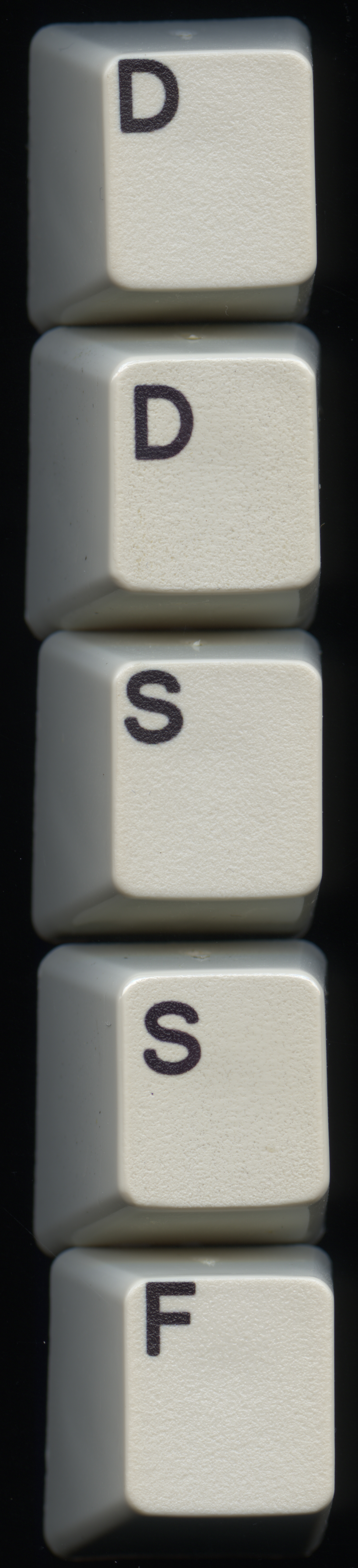

Dye sub update: Attached is a high res scan of the latest sublimated keys of excellent quality (same as what was posted a few weeks ago with my phone camera) vs. the exact originals they were based off of.
The new ones as sublimated by the factory's equipment appear to be a touch wider and thicker, so the finalized artwork will be updated to counteract those changes. (I did not account for the higher than expected amount of dye migration/bleed during the sublimation process, as the finalized artwork was an exact match to the originals)
As noted earlier the sublimation quality is excellent, as shown in these scans, looking at the keys in person, and examining them with my stereo microscope. The factory is working on the alignment and the jigs.
It is interesting to note the amount of uneven wear on older, well-used IBM keys compared to brand new ones.
