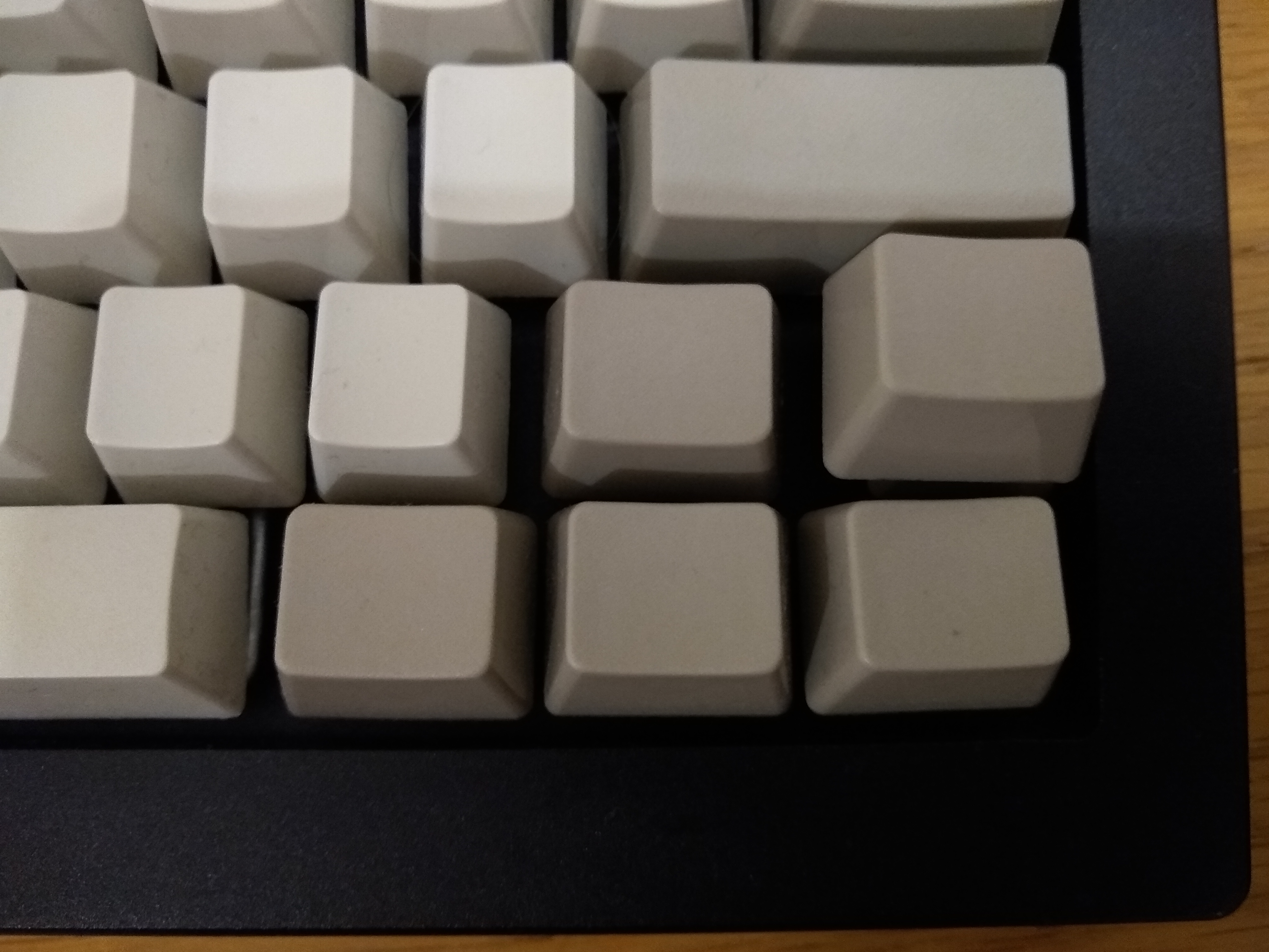

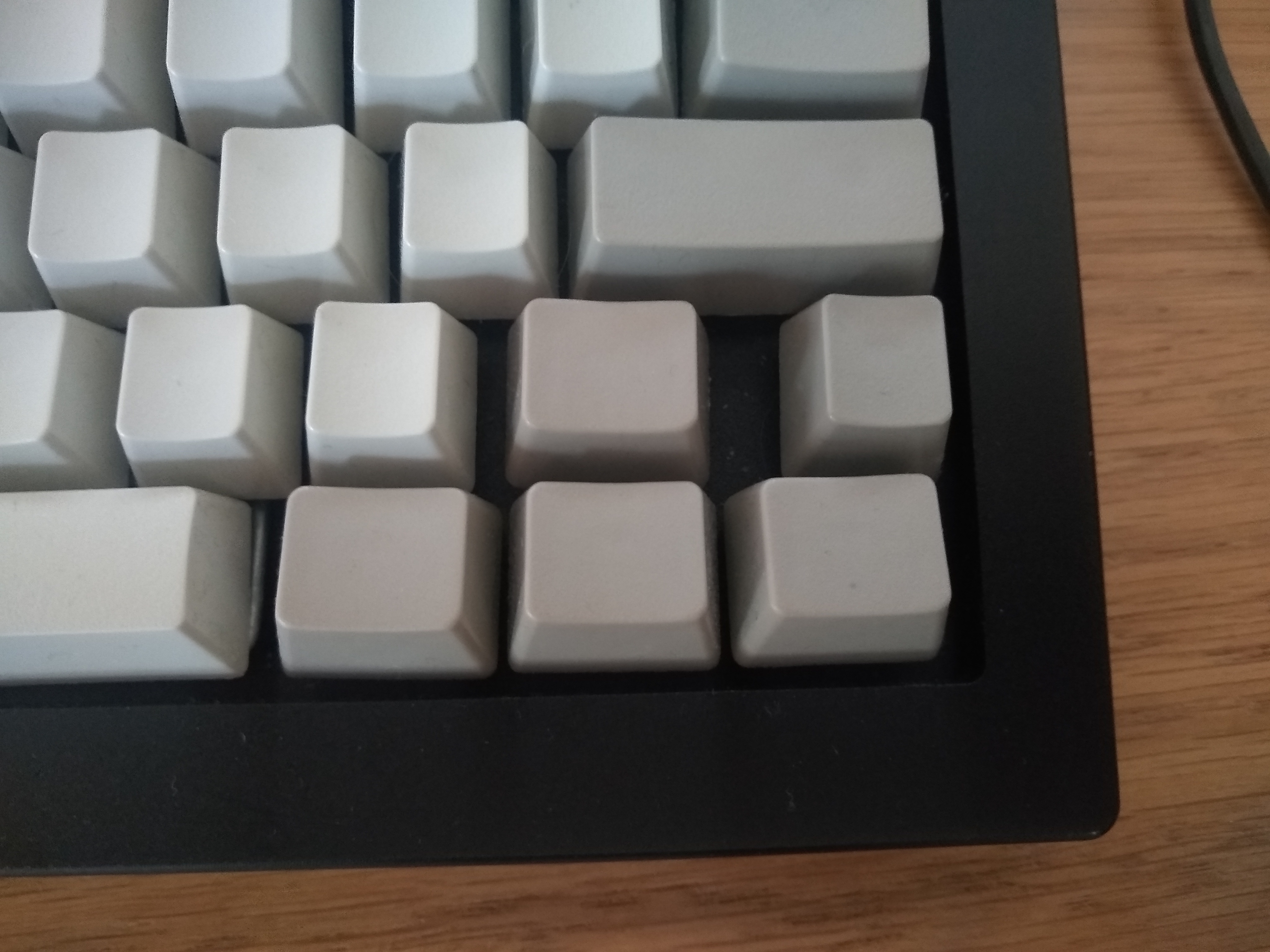

I've done a similar mod to my HHKB-layout board.
I've fitted Unicomp 1.25 U keys to make that inv. T. The stem spacing is perfect for it. It's a shame there isn't a 1.5 U key with an offset stem to replace the Fn key. I might try making my own by hollowing-out a 1.5 U and gluing in a Model M two-part key's stem.

clickclack wrote: 04 Feb 2021, 13:01 I've done a similar mod to my HHKB-layout board.
Order a blank stepped caps lock key from Unicomp and put it as the shift key, that’s what I use and it’s exactly what you’re looking for.
clickclack
04 Feb 2021, 20:18
I've tried that but I don't like the way it doesn't line up perfectly with the 'down' key. Actually, i mistyped in the previous message and it's actually a 1.25 U key I'd want to hollow out. That would give (I think) the same gap to the left and right of 'up' and to the left of 'left'.

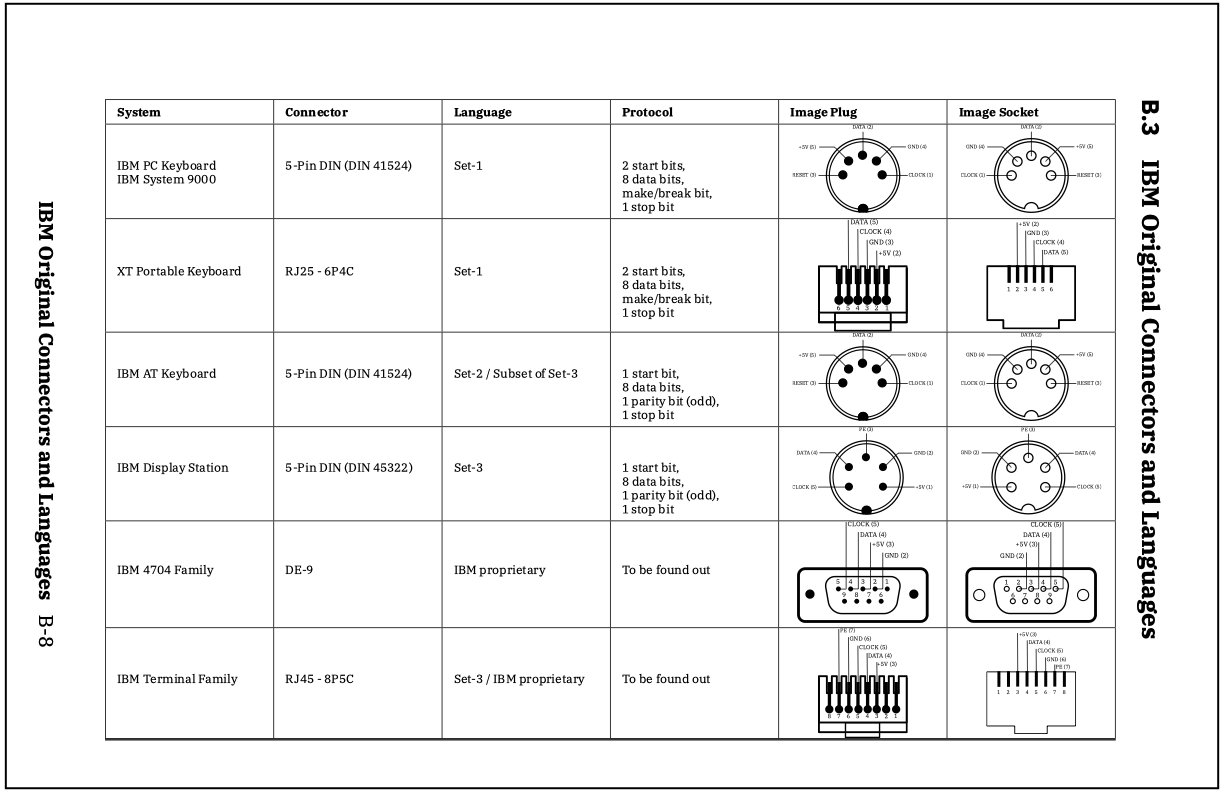

As part of the Model F Technical Manual Project, I am working on a table that contains the connectors, protocols and language sets of the variants. I have collected most of the data, but I can't figure out the details for some models, like our beloved 4704 Models. What I have so far is shown below, I would like to understand the protocol of the 4704 with its original controller. I hope someone can help.
ModelFManual.pdf
(252.63 KiB) Downloaded 304 times
