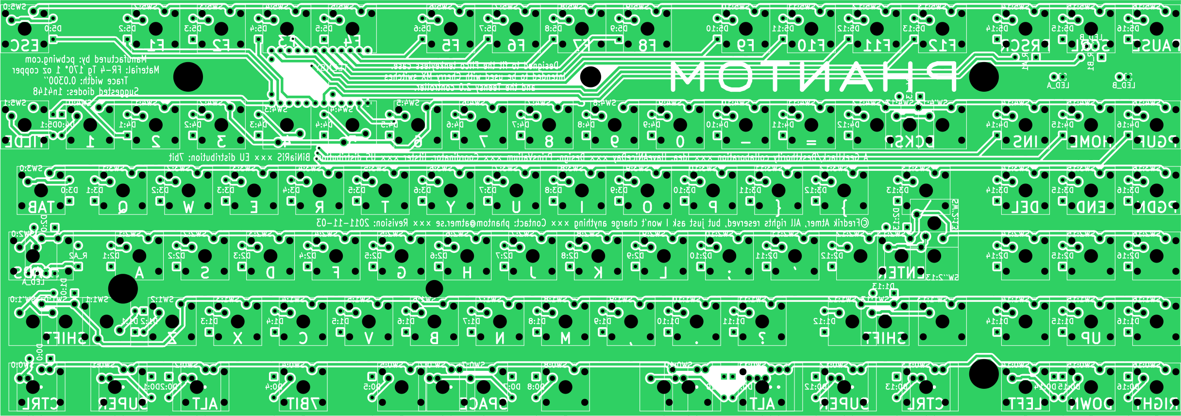

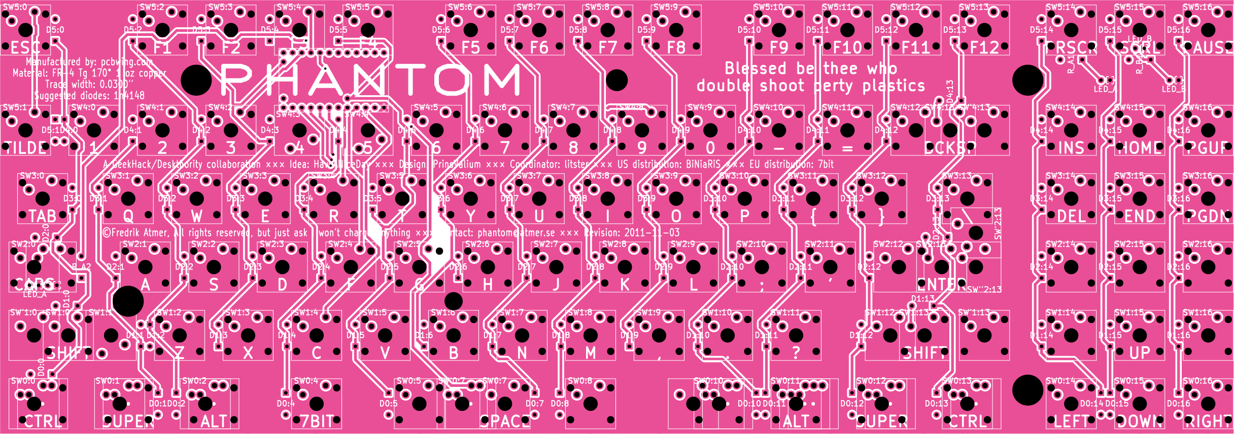

Inboard LEDs have been in place since the first iteration of this. Both CapsLock locations as well as Scroll lock. Plus the 3mm ones above the navigation cluster. There is no NumLock... And there is no free pin on the Teensy to add one either =P That would take some awkwardish redesigning to fix.sixty wrote:Guts, one wish:
Would it possible to have drilled holes for in-switch LEDs on capslock, scroll lock, numlock?
They do not even need to have a matrix or connections to the teensy. They can be wired up manually. I just would like the board to also support the Cherry LED keys.
Here are PNGs of the top and bottom of the PCB for the interested. Component placements should be fairly obvious, ask otherwise. The PNGs doesn't really work well against a white background, load them in a program where it can be chosen in another color.
- back.png (580.64 KiB) Viewed 8094 times
- front.png (583.64 KiB) Viewed 8094 times
