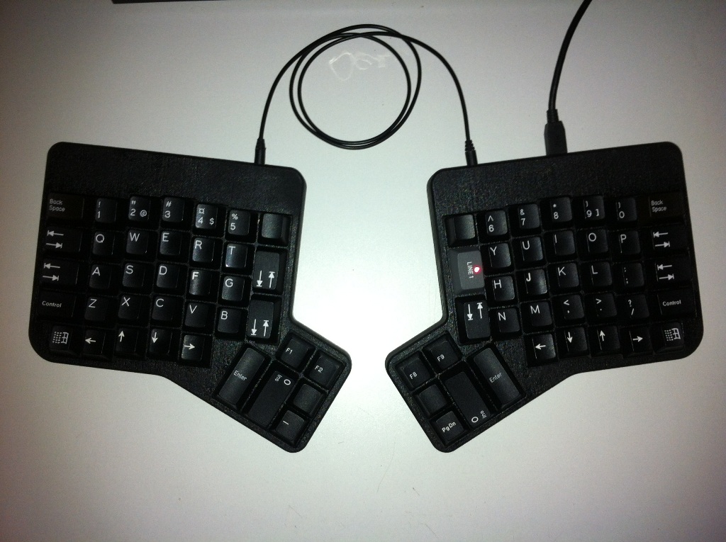

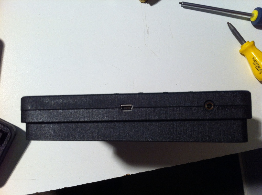

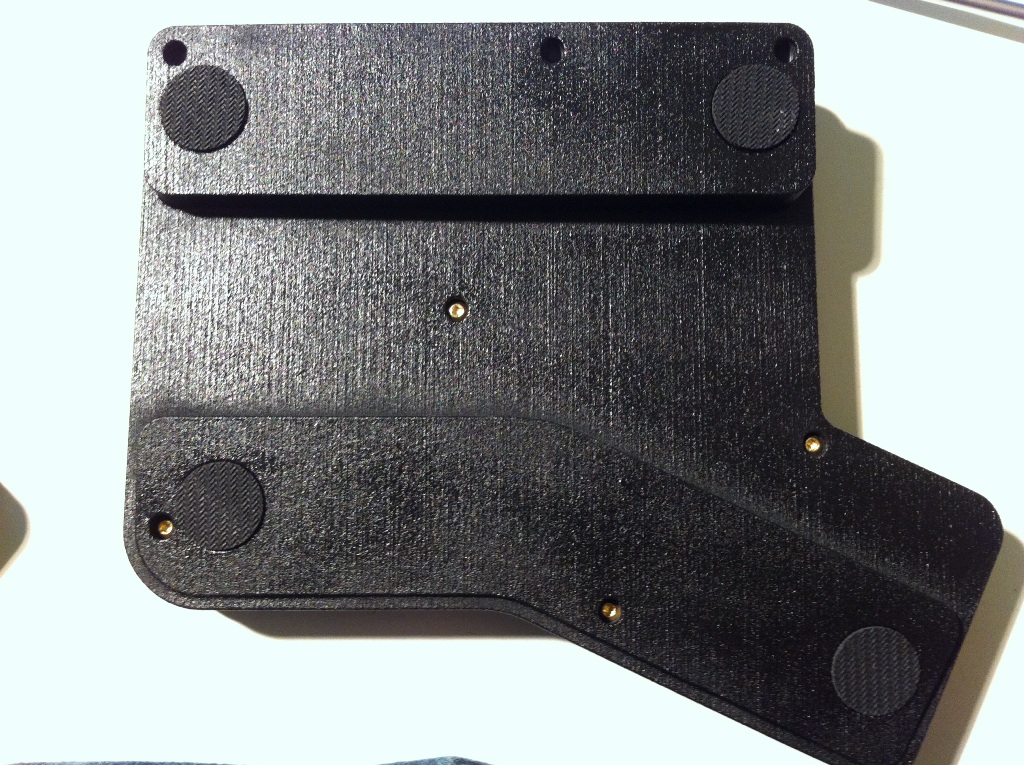

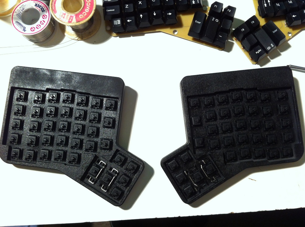

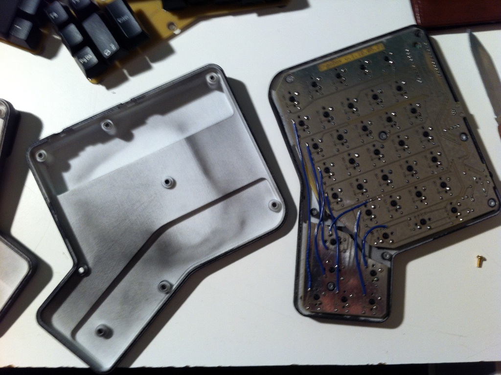

pingbat/PrinsValium: The flippable pcb is a good idea but I don't have much time to do it.
Spharax: I was supposed to add those but I forgot :?. It's not that much work, I will add them to the model.
pingbat: The 2 halves are connected with I2C and a TRRS (4 pin) jack/cable.
hoggy/Icarium: I will probably put the model available to public on shapeways soon.

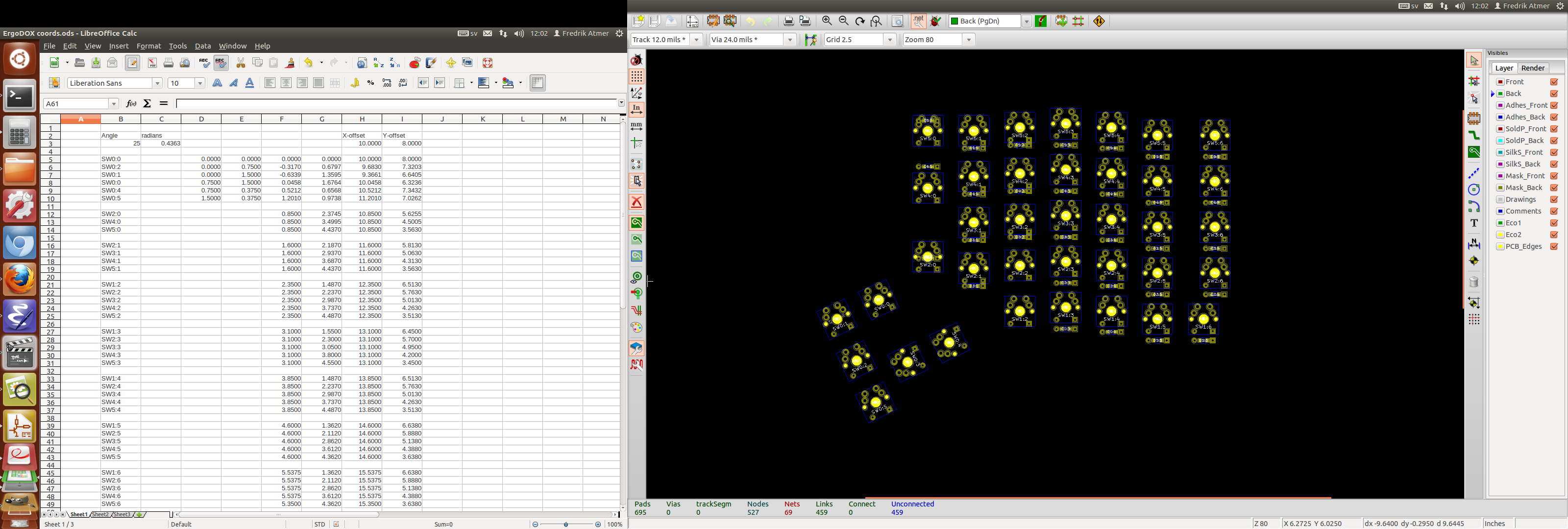

I could help out with the PCB design if you want me to. But I really don't want to barge in on your project, taking credit, telling you how to do things and such... You are using some company specific format for the PCB at the moment I believe. It may be nice doing it in a program with proper gerber support instead as well I think. But a complete redesign of the PCB would also not have been "prototyped".
The truth is I did pretty much of the PCB design already. It was pretty quick since I have some structure to keyboard designing already. There are always a lot more work left than you imagine though...
It is the power transfer between the halves that requires to be jumpered. Since the connectors will be mounted on the top on both halves and the cable is straight (I suppose) the leads will be flipped.

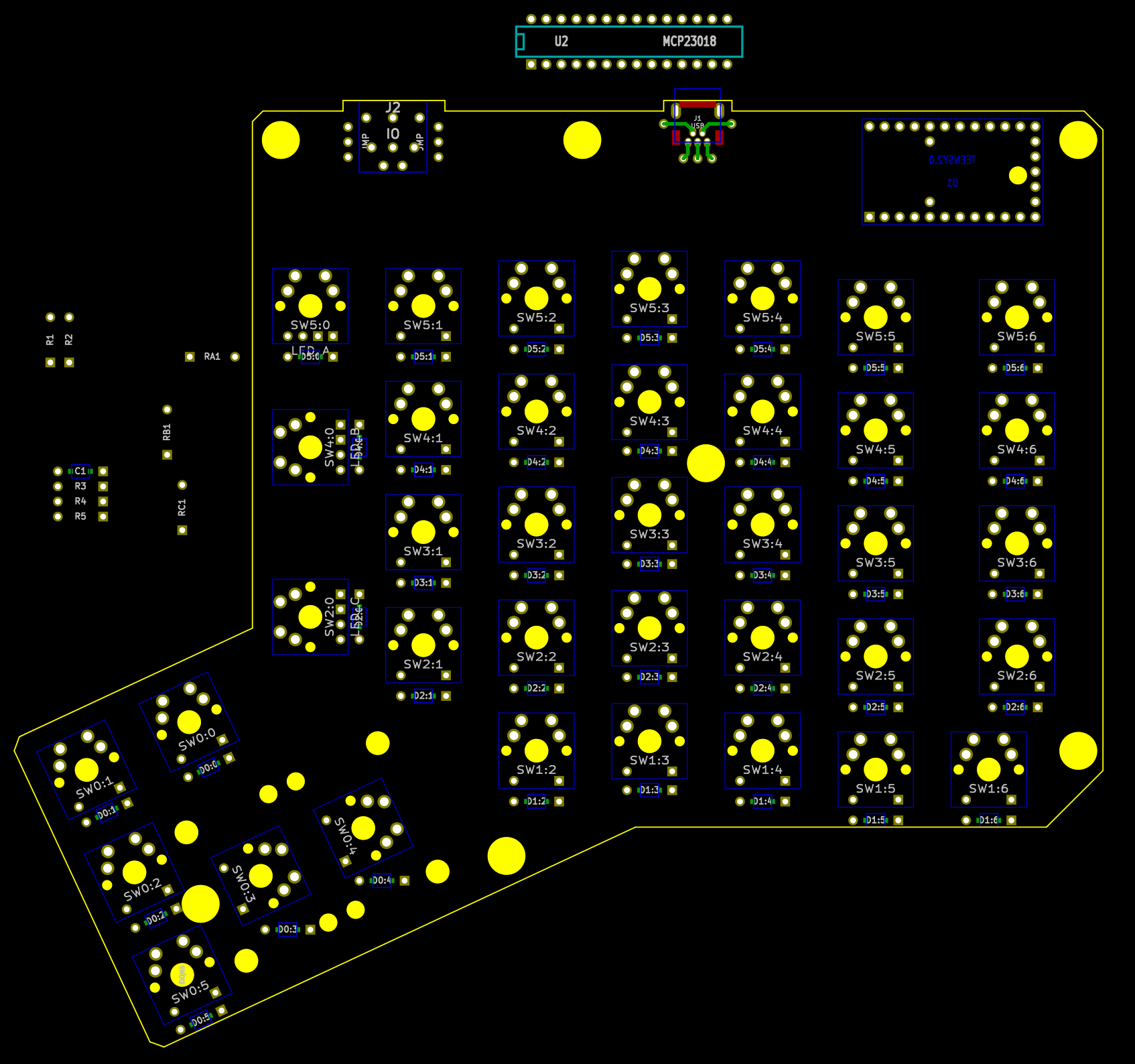

bpiphany
11 Jul 2012, 12:11
God, do I like being square... =D
Working on the ErgoDOX PCB layout.

Prinsvalium: What are we seeing, redesigned it for mirrored layout?
bpiphany
11 Jul 2012, 13:58
Yes, that as well as drawing it up in a proper PCB CAD software.. The KiCAD printing functions really sucks. Screen shots are the easiest way to display anything =P But I am getting there. That IO-expander is bit bulky though...

dox
11 Jul 2012, 20:02
Good start PV! I have a few observations.
  • There is a missing mounting hole near the thumb keys on the left of the pcb.
  • The stabilizers are not required. It feel much better without them. Instead, we could have the option to place two 1x keys instead of one 2x. I remember someone asking for this.
  • The inner pins on the teensy are not used. Maybe you could place the mpc23018 "inside" the teensy footprint?
  • With the reset and ground pins accessible on the teensy, we don't need access to the reset button. The access hole would only work when the teensy is on the left hand. There is a "jump to bootloader" key in the firmware too.
bpiphany
11 Jul 2012, 20:58
dox wrote:Good start PV! I have a few observations.
First if all, I feel a bit relieved you are this open with everything =)
  • That hole isn't quite there in the blueprints... I was guessing that dimple there was supposed to be the same radius as the mounting holes. And now I see from the exprressPCB drawings that this probably is the case.
  • The stabilizers should be possible to combine with optional 1X keys. That requires some changes to the matrix though.. You should have told me sooner, didn't want to mess with it too much, trying to keep my intrusion as unnoticed as possible ;D
  • I am removing Teensy pins as I see no need for them, modifying the matrix may give rise to some rearrangement still.
  • I just finished a mail to "ic07" asking about swapping pins. I had the same idea placing the footprints on top of each other. But then it really helps having the corresponding pins next to each other.
Got to get back to work, but starting tomorrow I have a full week off \o/
