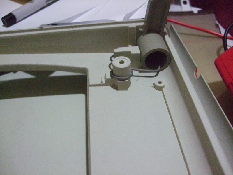

There was one on ebay. I'm really surprised with how little used it looks, though the legends have this ugly yellow border around them.
I won the auction about 16 hours after he Pm's me about this project. I got really lucky again (all my model F's have been really good finds off ebay)
It's also super easy to take apart. I do need to get a nut driver in that size, since it's just about the only size I don't yet have and using pliars to loosen them is sort-of a pain.

It is far harder to reassemble though, thanks to the greater pressure between the front- and back-plates of the inner assembly. The AT ones simply slide together, whereas my XT needed some clamps and a few hits with a hammer to get all the hooks in their slots.

I once posted a tutorial on Geekhack how you could keep the spacebar in place when you're sliding the plates together. I thought I added it to the end of my "mod your model F spacebar" tutorial.
But yes, nut/bolt is preferable if there's room for it, then you can at least fasten each nut separately and even choose how much pressure you want to put on the barrels.

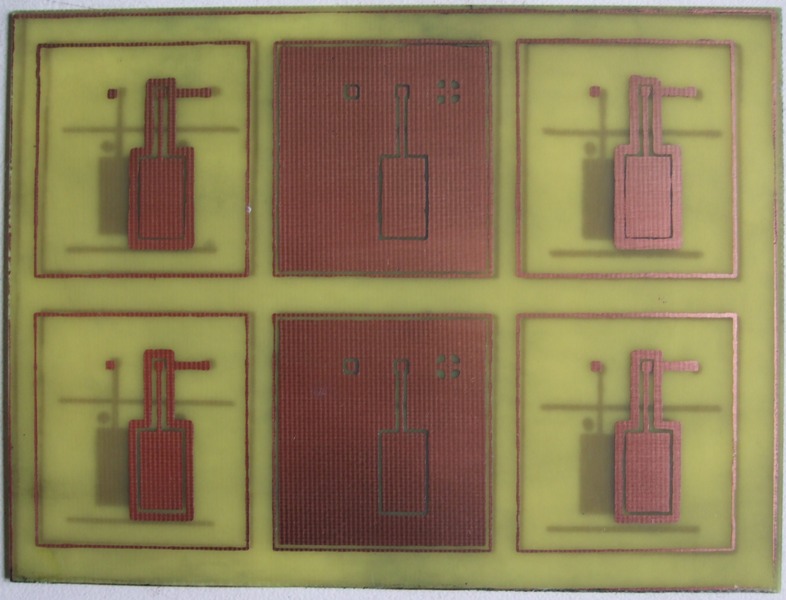

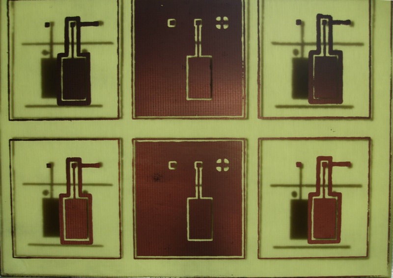

DIY PCB take 2
For my next attempt I found a glossy corporate magazine with thicker paper. I followed the same procedure for prepping and ironing and the transfer results were again unsatisfactory, so I did not bother etching and just cleaned off the toner that did stick.
Working under the assumption that the problem lay with my printer or toner, I decided to give the local office supply store a try. I printed from KiCAD to PDF and took it to Office Depot to be printed on “glossy text” paper (total cost $0.39 for 2 pages). The first thing I noticed was that the pad fills were free from the streaks that I had with my cheap Brother printer. I prepped and ironed the same as the other attempts. While ironing, I noticed that the paper shrank much more than the magazine paper I had used – perhaps > 1%. I also noticed the pattern bled through while ironing the paper much more than with my printer, toner, and magazine paper. But the end results speak for themselves. Testing for continuity, only one of the pads was found to be “bad” and this was because of incomplete etching – the pad is still touching the ground. Next time I need to use the Scotch Brite or an old tooth brush to remove more of the paper.
While drilling through holes i discovered that small drill bits burn out quickly. As I only had one bit smaller than 1/16", that is all the update for today. Smaller bits are available at the hobby shop near my work, so will likely finish the test switches tomorrow.

I'd go over the upper right one (on the bottom PCB side) with a razor to make sure there's no continuity where there shouldn't be. Other than that, it looks really nice! Maybe make the pad slightly smaller, thus increasing the space between. It should still work just fine, and would probably be easier to print.

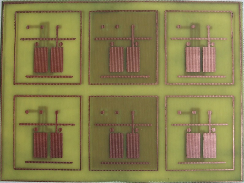

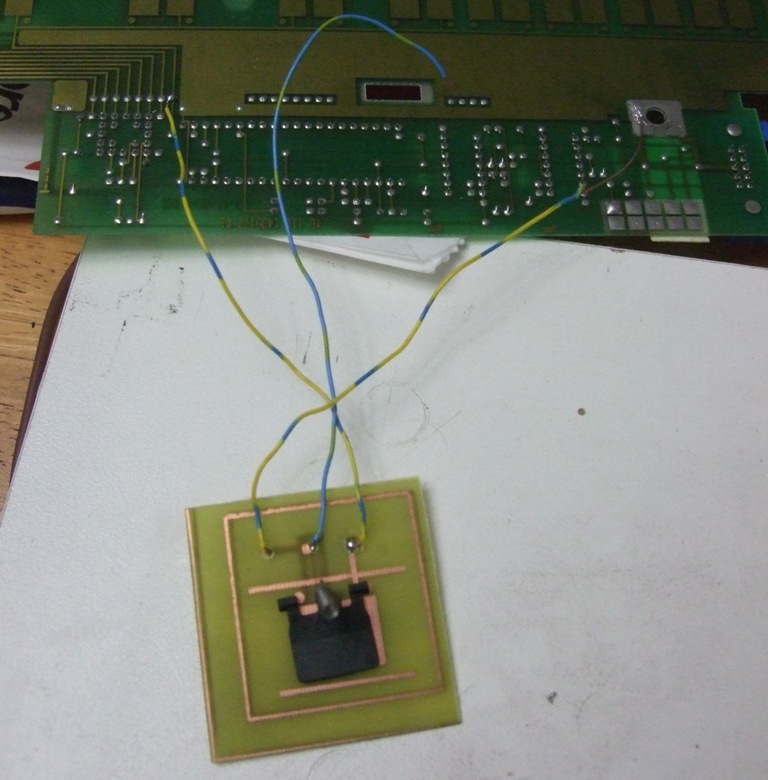

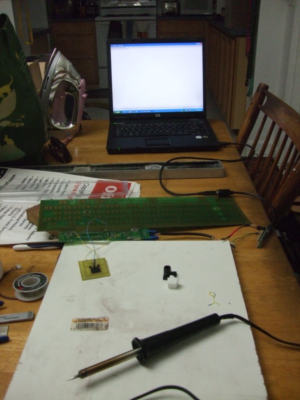

SUCCESS!!!! maybe
i just could not stop myself from wiring up one today. The laptop screen is all "2222222222222222222" Here is a close up of the controller and converter. The "row" and ground wires are soldered to the controller. the "column" wire is loose so i can change it easily. Even with poor alignment it still registers. [edit - it registers even without a hammer, so still have work to do.]

Just a thought: perhaps the copper is the wrong thickness. That might have the potential to cause oversensitivity, but depending on how sensitive this thing is, there are many variables that could affect it. The wires getting close to each other between the two boards, maybe.
Also, I see you still have it connected to the original key part; connecting a second capacitor might make it think a key is pressed. This actually seems like the most likely problem to me, now that I think about it a bit more.

I thought the same thing so i chopped off the old key matrix and no effect.Ratfink wrote:Also, I see you still have it connected to the original key part; connecting a second capacitor might make it think a key is pressed. This actually seems like the most likely problem to me, now that I think about it a bit more.
this test was with 1 oz copper. i have a small piece of .5 oz and 2 oz.

Have you tried to connect the extra pad before the controller is powered?wcass wrote:Here is a close up of the controller and converter. The "row" and ground wires are soldered to the controller. the "column" wire is loose so i can change it easily. Even with poor alignment it still registers. [edit - it registers even without a hammer, so still have work to do.]
If I remember right, the first thing the controller does is calibrate the pads' sensitivity values in the assumption that no key is pressed. If you hook and unhook pads to different places in the matrix while the controller is active, the controller suddenly has to deal with different capacitance on a given crosspoint in the matrix and might think you're holding a key.

Thank you so much. This kind of insight is why this community is so valuable.JBert wrote:Have you tried to connect the extra pad before the controller is powered?
I'll tack the second pad to one of the pins when i get home and post the results.

I'm not so sure about that. I just unplugged mine, pressed and held the F key, and plugged it back in, and it was spitting out F's like no tomorrow. I released the key and it stopped. Maybe it's averaging all the keys and using that for the baseline value, in which case having all the keys cut off would have the same effect as still having them connected. Just speculation; I could very well be wrong.JBert wrote:If I remember right, the first thing the controller does is calibrate the pads' sensitivity values in the assumption that no key is pressed.

JBert wrote:Have you tried to connect the extra pad before the controller is powered?wcass wrote:Here is a close up of the controller and converter. The "row" and ground wires are soldered to the controller. the "column" wire is loose so i can change it easily. Even with poor alignment it still registers. [edit - it registers even without a hammer, so still have work to do.]
From when/where do you remember that?

There was some thread a while ago on GH where MSiegel wanted to rebuild a model F keyboard controller.
I believe I picked it up from one of the following IBM patents:
http://www.google.com/patents?id=vh8QAAAAEBAJ&pg=PA1
http://www.google.com/patents?id=kCo8AAAAEBAJ&pg=PA3
I must admit though that I've only skimmed the documents, as it seems it works still different because those documents talk about reference capacitors. Also, it's not because it got patented by IBM that it saw immediate use.

i tacked the loose wire to column E, so along with row 1 i should be getting 4's. I booted up, opened notepad and plugged in the keyboard with no hammer on the test switch. I did not immediately get 4's, so i placed a hammer on the test switch and ... nothing.
the test switch registers without a hammer when connected after boot, but when connected before boot does not register even with a hammer.
so what does this tell us? am going to have to measure the capacitance of the original switch?

Hm...strange
on my controller there is a little silver, square chip labeled 8273565\nIBM 52\n185040L01 which seems to be responsible for checking whether keys are pressed or not. I don't think there is a start-up calibration process because I think it doesn't have enough wires going into it but I can't be sure. It seems to be connected to two capacitors however which might be used as a reference.
