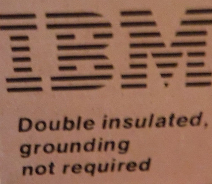

I thought you might enjoy this inscription on a metal badge affixed to an IBM Selectric typewriter:
The Selectric will be a keycap donor for my IBM Displaywriter. The Selectric has beautiful spherical double-shots -- white legends on a black background that looks almost like a dark olive green.
If this typewriter were in the UK, I suppose the badge should say, "earthing not required" (?)
13 Jun 2014, 02:21
Everything mains powered, at least computer wise and I expect electric typewriters too, is double earthed by convention over here. So I heard in "tech" class back at school. No, not high tech, it was what you guys call "shop", I think. We were usually playing with saws and sanders!
