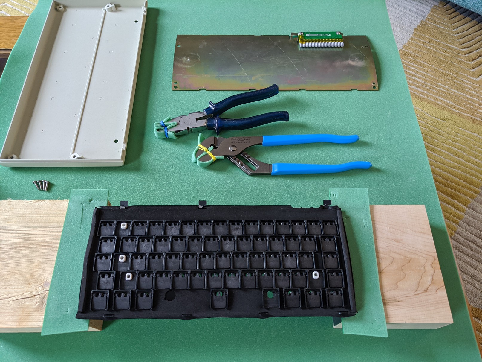

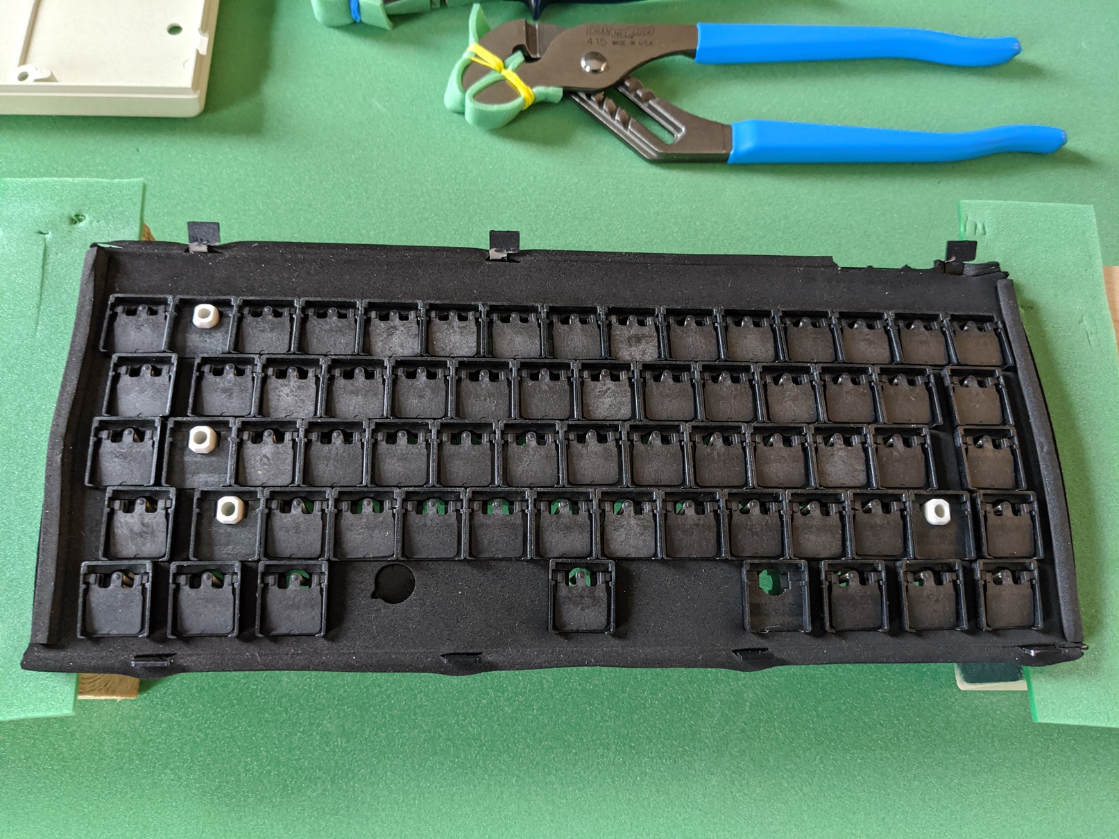

Recently I have been exchanging emails with someone who has followed the manual carefully and with permission I am posting some photos of their Model F setup to open up the inner assembly, as some flippers got stuck after the keyboard was bounced around in shipping (!). The setup was so nice that I thought it would be worth sharing! Certainly nicer and cleaner looking than my own setup!

As a general note to everyone, please do follow the written manual for troubleshooting. It will save you headaches trying to reinvent the wheel when the fastest path to getting things up and running has already been figured out and documented. I've personally inspected over 1,000 new Model F keyboards and have documented the quickest ways to get things up and running, having learned many of these methods reading on the DT, GH, and r/MK forums over many years.
If anyone has any additional troubleshooting tips not found in the manual please do share here so that I can update the manual.
And if anything is not clear in the manual please do suggest what to change.
(I've been messaging Fractal over email. It's likely that the 16th column containing only that one bottom right key is in need of being touched up on both the controller side and on the large capacitive PCB. Same situation with the right Ctrl key on the F62 by the way. It's odd that the soldering gets damaged during shipping because I test each key 100% before mailing out each keyboard.)
