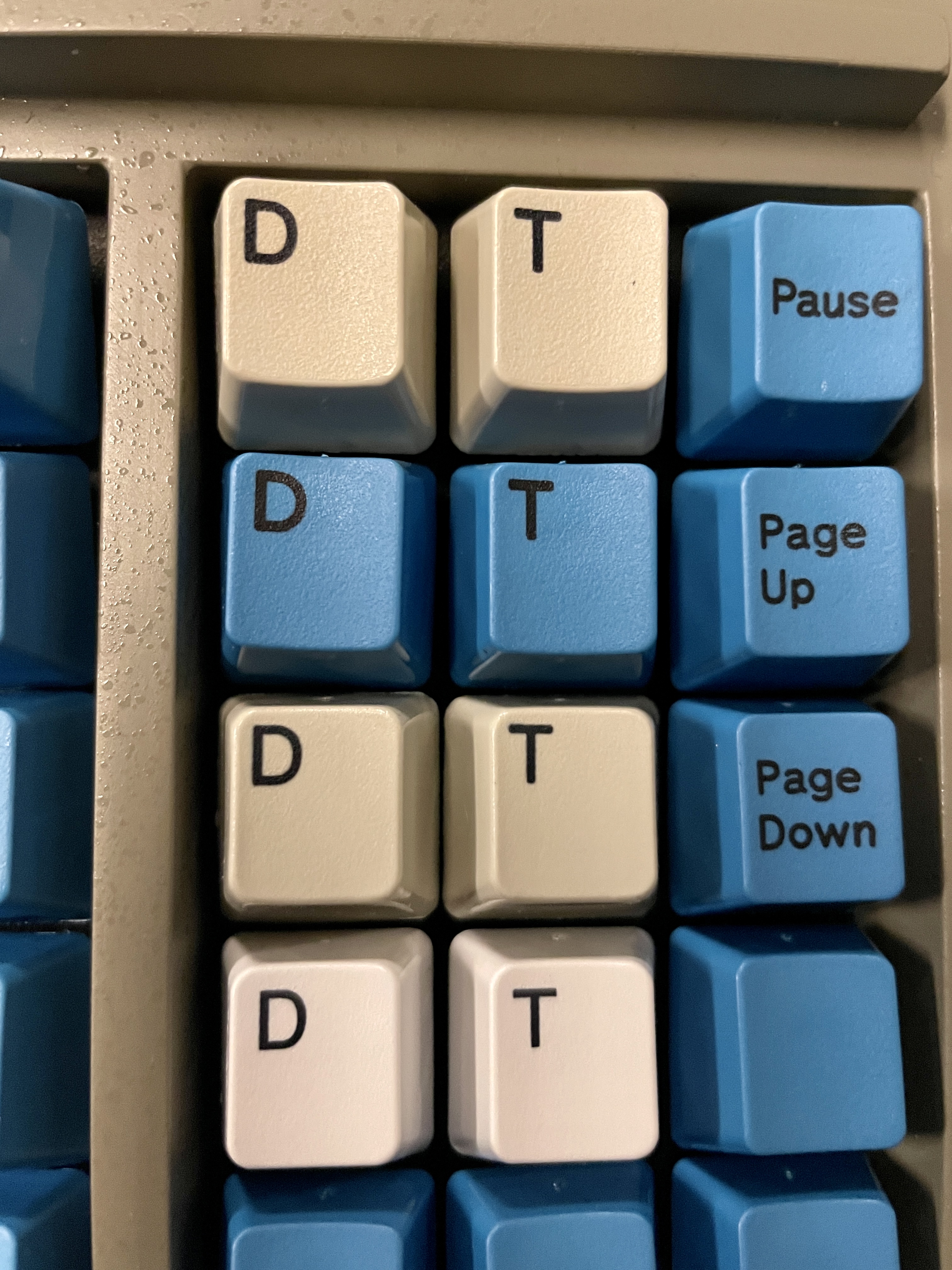

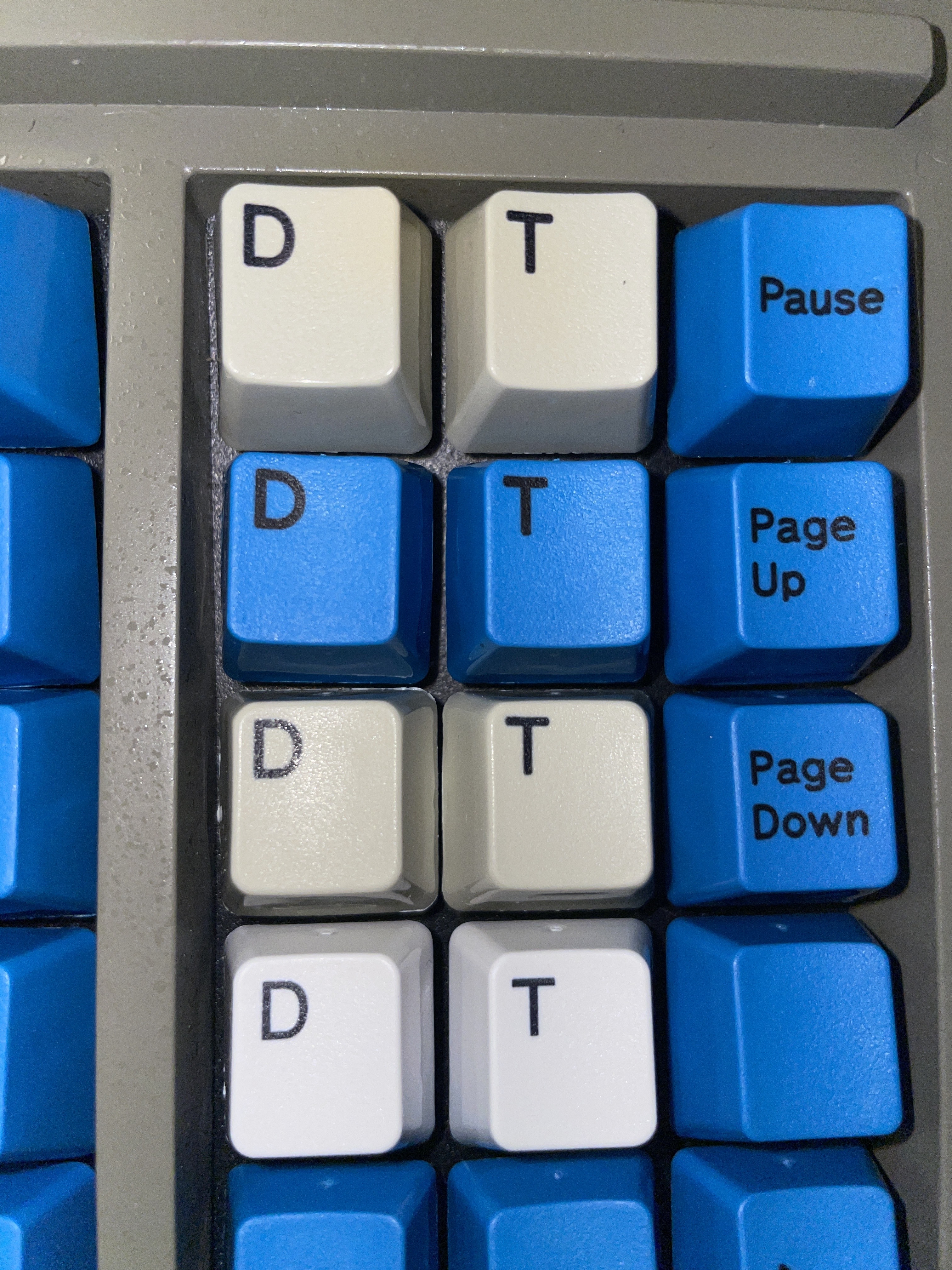

Thought I'd share some pictures of the industrial SSK blue set I just received.
I first replaced the modifier keys since I was using blanks and was pleased, but think a darker set would contrast better than the pearl set taken from my Model F AT.
Below is a comparison of the D T keys from the top-down:
Model F AT (1st top row)
Repro SSK Blue (2nd)
1988 Model M (3rd)
2020 New Model M (4th)
Here's another with the flash turned on to show how much they "pop" in bright light:
I don't have an original set of XT keys to compare to but overall I think the quality is excellent.

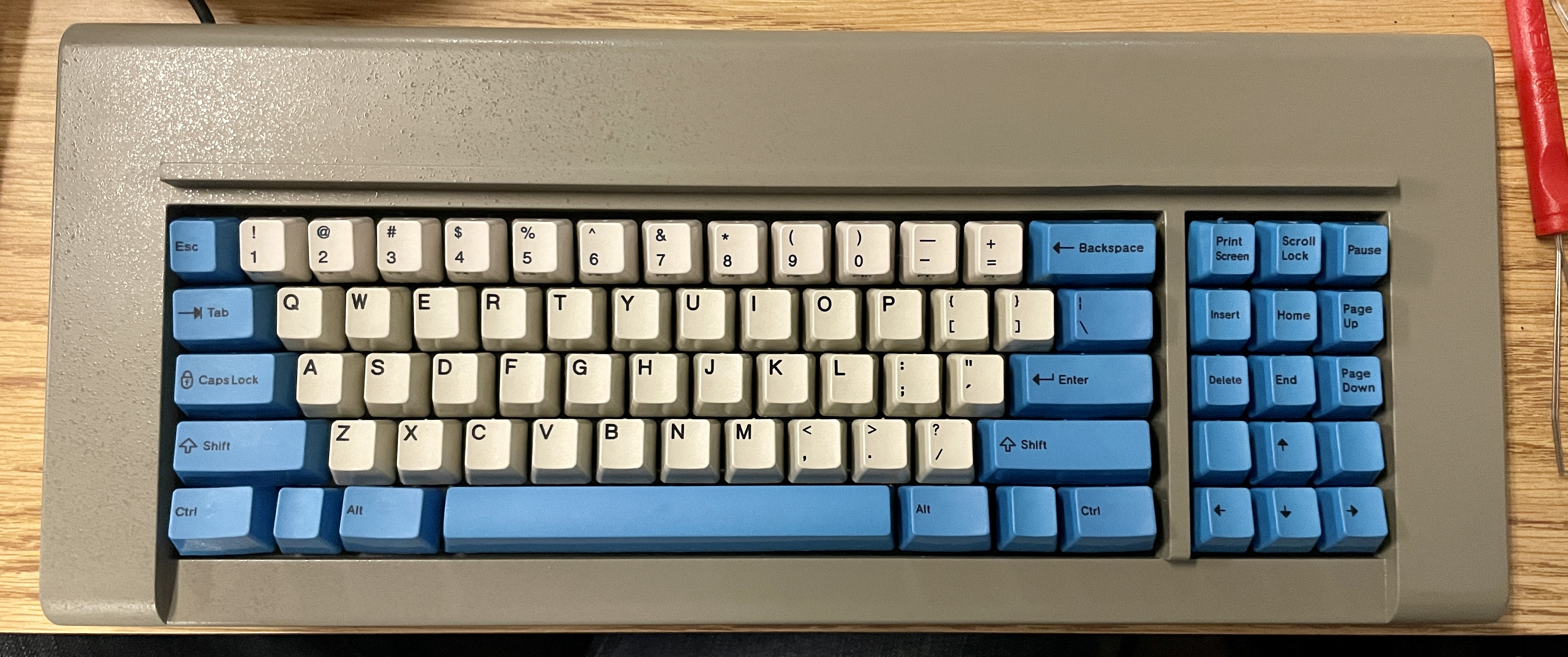

I ordered mine not long after the orders opened, now it is here:
Will share more thoughts as I use it more. First impressions is that Ellipse has done a fantastic job with the keyswitches, the keycaps and the keyboard as a whole.
