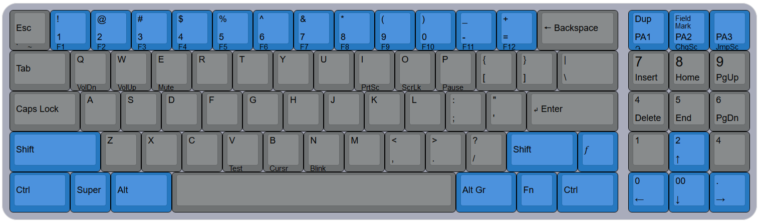

Arkku wrote: 31 Oct 2021, 02:42 Since the ISO enter is not available in other colours than pebble (AFAIK), I wonder if anyone has tried mixing pebble with the dark gray? I was thinking of letters in dark gray, and other keys in pebble.
I've tried mixing gray and pebble together & personally I don't think it works that well, but that's just my opinion... pebble looks very brown/tan when set next to gray.
I'm not sure what color scheme you were ultimately hoping for, but have you checked with Unicomp? It looks like they offer ISO Enter in *their* version of gray. What I don't know is how close Unicomp gray is to Ellipse's dark/60% gray. If you were hoping for all-gray keys, though, I'd imagine the Unicomp gray ISO Enter would clash less than a pebble-colored one would.
(Perhaps you could do dark gray alpha keys and Unicomp gray instead of pebble for modifiers? Only potential problem with that plan is that I can't say how obvious the difference in printing would be between Unicomp and Ellipse caps when side-by-side on the same board.)

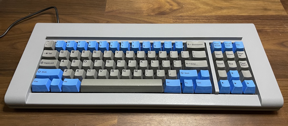

I mentioned in my review from last year that my 5.5 space bar and the 1.5U key to its right did clash a bit, which looked like a slight tolerance margin problem. Still haven't gotten around to file a bit of the plastic on the 1.5U key to wade that issue, though.
Re: F62+F77 orders now open! New Kishsaver+Industrial Model F Keyboards
Posted: 22 Nov 2021, 02:10
by NathanA
depletedvespene wrote: 21 Nov 2021, 00:00
Sp33ls wrote: 16 Nov 2021, 19:47 Sorry if this has been covered already on this thread, but I'm curious if anyone else has had issues with the space bar rubbing against the alt keys on both sides?
So you believe that -- at least in your case -- the tolerance issue is with the key molds themselves, and not with the barrel plate? Or are you just hoping to work around a barrel plate tolerance issue by filing down the key?
Sp33ls says that in their case, the issue affects *both* Alt keys on *both* sides, which seems like would either mean that both Alt keys are too wide, or the Spacebar is too wide, or the barrel plate had the Alt key barrel holes too close on both sides...hmm.
Posted: 22 Nov 2021, 13:17
by depletedvespene
NathanA wrote: 22 Nov 2021, 02:10
Yes.
I mean... yes, I'm gonna file down a bit the 1.5U keycap to work around the tolerance issue. If I screw up, which I'll surely do, because these thick clumsy hands are thick and clumsy, I'll only ruin a keycap instead of breaking a barrel or worse.
NathanA wrote: 22 Nov 2021, 02:10 Sp33ls says that in their case, the issue affects *both* Alt keys on *both* sides, which seems like would either mean that both Alt keys are too wide, or the Spacebar is too wide, or the barrel plate had the Alt key barrel holes too close on both sides...hmm.
In my case, it's exclusively between the shortened space bar and the "extra" 1.5U key to its right. I have toyed around the issue of simply going back to a 7U space bar, but haven't decided to do it so far.

Sp33ls wrote: 16 Nov 2021, 19:47 Sorry if this has been covered already on this thread, but I'm curious if anyone else has had issues with the space bar rubbing against the alt keys on both sides? I have a beige F77 w/ beige keys.
My grey blue F77 with dark grey keys doesn't seem to have this problem.
When my keyboard arrived it had this problem, too. More precisely, both Alt keys were rubbing against the space bar wire, and as a result when I pressed down one or both Alt keys the space bar would depress as well.
I was able to reduce (but not eliminate) the rubbing by removing the space bar, bending the edges of the wire inwards, then reinstalling it. It's possible that, had I kept trying, I'd have been able to solve the problem entirely, but as it happened I had an extra space bar wire, and once I installed that the problem went away.

Check out the Full Key set product page on the project web site where the rendering is now shown.

Ellipse wrote: 22 Nov 2021, 18:10
I am sharing (with permission) another nice color combination that someone sent me
What is the case color on that one? I can't tell from the white balance if it's beige or industrial grey?
I've ordered industrial grey but have been starting to like the beige more and more!
