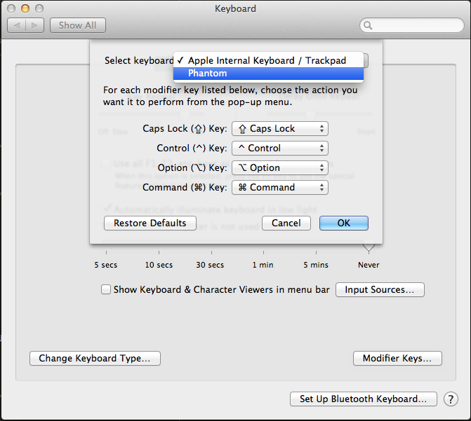

Is there an updated firmware that needs to be checked into the Git repository (https://github.com/BathroomEpiphanies/Phantom-Keyboard)? The one I pulled down tonight has a rather peculiar quirk. When I short the holes for a switch, it will register that switch the first time, but as it repeats itself, it switches to the key in the column to the right. For example, if I short out the pins for the letter "J", then the first key press will be registered as a "J" but then it will immediately switch to repeating "K".
If there's no update ready right now, then I'll start tinkering with the firmware to try and fix the issues. Are there any processes we should be following for check-ins other than "test before check-in"? :)
It's Alive!.png (97.84 KiB) Viewed 5659 times

13 Jul 2012, 16:16
litster wrote:Gimpster, try one of these hex files in the zip file. One for PHANSI (1.5x mods) and PHANSIWIN (1.25x mods).
Phantom Firmware-ANSI.zip
Well, some things work better, but I'm still seeing the same weird bug in some scenarios. Do you by chance have the source for those two files? It would be helpful to see the diff between that and what I've got in my Git fork.

Yup, using OS X. I don't know enough about the hardware yet to completely rule out something I might have done during soldering, however both of my boards exhibit the same behavior, so I'd guess not. Thanks for taking a look though, if you have the time to write up a quick primer to help people get up to speed on the code, that would be wicked cool :mrgreen:, otherwise I'll just take some time to dig into it, there's not too much code there to read through (been a LONG time since I wrote C, though ;) ). I've forked the repository into my own branch, so for now I'll work on OS X support in there. Anybody interested in following that branch can find it here:
https://github.com/gimpster/Phantom-Keyboard

Yah, so OS X has a "feature" that changes the standard behavior when you are holding down a key. In this situation on OS X Lion (maybe back as far as Snow Leopard) it doesn't repeat the character like it will in Windows or Unix, instead it pops up an on-screen character picker so you can pick variants of that letter. For example, I could type "e", but if I hold it down, I can also type è, é, ê, ë, ē, ė, or ę. My suspicion is that it has something to do with this, because when I type on my Filco, I get those options, but not when I type on the Phantom, there it just repeats the character.

In that case it is something that is buried deeper down in the usb_keyboard files from PJRC I would think. I don't know if the firmware actually repeats key-presses on an interval by itself. I believed that should generally be handled by the OS. When I look in 'xev' to see what is going on there are a lot of key-press and key-release events. That might just be depending on which level 'xev' comes in at. If it sees the OS generated key-events that should be just the correct way.. I could of course try a "real" keyboard....
Edit: My Realforce shows the same behaviour in 'xev'
