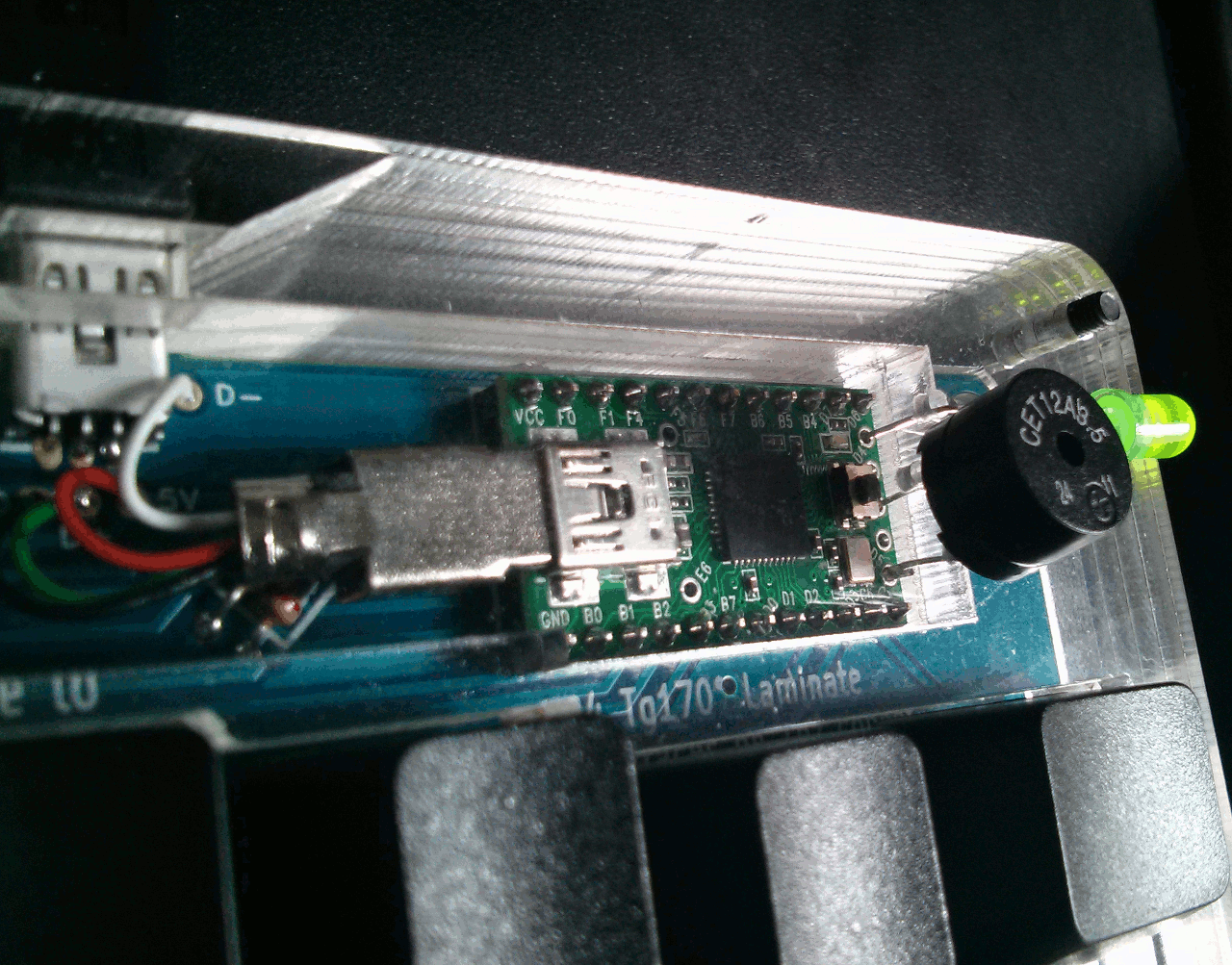

ic07 do you know why there is voltage on D4 and D5 on the teensy ? I put an LED between D4 and GND and it light up, dimly. I measured 1.7 volts across the LED. If I instruct the firmware to actually light it properly (doing it on a keypress) it goes to 2.6 volts and on key release back to 1.7volts.
If I don't put a LED I can measure over 4 volts even though it's supposed to be off. Any ideas?
BTW I noticed this while getting on a buzzer for clicky sounds. It worked by the way, I'm using sparkfun part number COM-07950, here is the code, "led4" is the buzzer (D5) and "led5" is an led (D4) that is lit as long as any key is held down.
Another buzzer I tried was very sensitive and made a light sound even without a keypress, any idea why the voltage doesn't drop to zero on either D4 or D5 ?

I'm pretty sure it's because both D4 and D5 are initialized as inputs with internal pull up on, in .../controller/teensy-2-0.c, and it looks like your code doesn't reinitialize them. Take a look at this file (in the same directory). Probably what you want to do, is somewhere in your custome main(), after calling kb_init(), clear the 4th and 5th bits of PORTD with "PORTD &= ~(1<<4)" and PORTD &= ~(1<<5)".
Hope I got all that right...

Hmm I tried it but no luck. If I put those 2 commands after kb_init(); then they don't light up at all, they become unoperational.
If I put them before the kb_init(); call, then D4 and D5 still hame some current going into them instead of turning completely off.
ic07
Ahhh... when you put those commands after kb_init(), it makes the pins alternate between drive-low and hi-z - so the things you're driving would have to have their other pin connected to Vcc. I feel like this is safer, in general - but since it looks from your picture like you have stuff pretty much set, you could try this in main()
and then in teensy-2-0--led.h
This will make the pins alternate between drive high (when they're turned "on") and drive low (when they're "off") - so in this case, the pin of the buzzer or LED not connected to the Teensy should be connected to GND (through a resistor of course, at least for the LED).
// ... kb_init() ...
// set internal pull-up off for both pins
PORTD &= ~(1<<4);
PORTD &= ~(1<<5);
// set the pins as output
// (because we cleared the applicable PORT bits above, the pins will now be driving low)
DDRD |= (1<<4);
DDRD |= (1<<5);
#define _kb_led_4_on() (PORTD |= (1<<5))
#define _kb_led_4_off() (PORTD &= ~(1<<5))
#define _kb_led_5_on() (PORTD |= (1<<4))
#define _kb_led_5_off() (PORTD &= ~(1<<4))

Bingo!! Changing _kb_led_on to use PORTD instead of DDRD made the new LEDs operational after the initialization! Thank you so much.
Strange why the other 3 LEDs use DDRD, as well as some register stuff that I don't understand

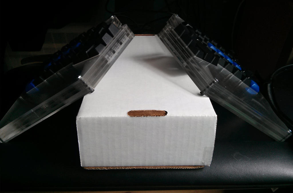

Mine arrived yesterday (I'm in Canada) and I'm typing on it now! To be frank I think I would have been fine with my CM Storm, but... well, what can I say, the ErgoDox is just too cool
I'm finding myself ambivalent to non-staggered layouts; while they're theoretically better I have trouble doing some common bigrams quickly. In particular, "in" is a bit of a stretch for me
FWIW, I'm pretty happy that the switches can be taken off of the plate easily if they're desoldered. I decided, after having put the caps on, that I wanted labelled caps (yanked from my CM Storm), even though I'm a good touch typist (I find this useful for the nonstandard keys as well as the home row marker on the j and f keys). The caps that were sold in the MassDrop GB are insane; they're damn near impossible to remove from the switch. I managed to actually destroy one switch so I had to desolder it and put in a new one. I'm really glad that MD included extra switches! And I had little blue flecks on my desk when I was done from all the slightly broken switches. They work, but I may have to replace them at some point.
Overall I like it. I think the thumb cluster is too far from the main keys, and I wouldn't mind some LEDs to indicate which layer I'm in. It's a pity that the tinkering cost for this is so high (PCBs and cases are expensive, and I want a nice design---no LEDs sticking out of my case! But these are, I think, some minor gripes and it's awesome to see this project come to fruition.
Now all we need is a labelled keycap GB, at least if I can get everyone to agree to my layout >:)

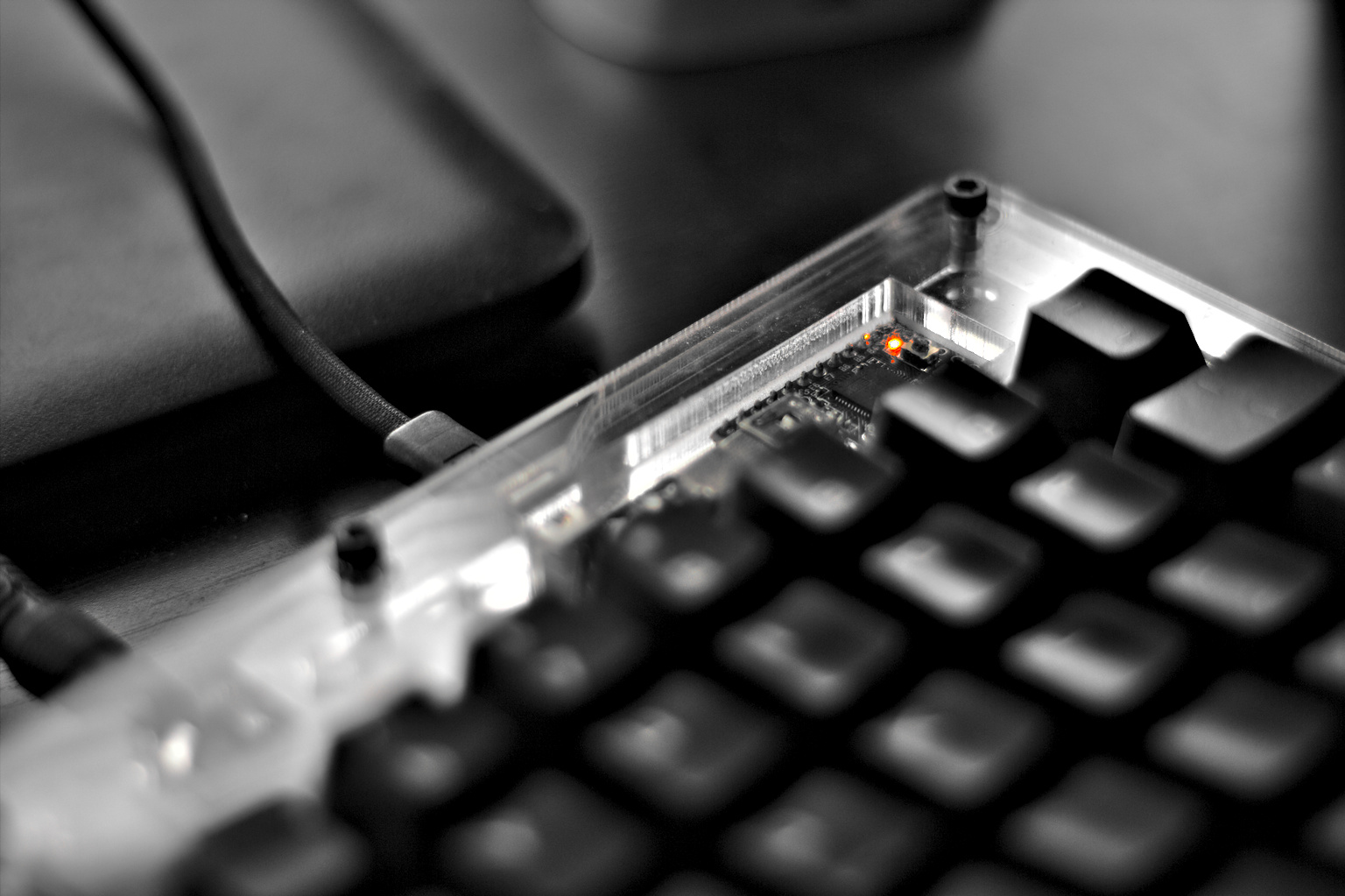

You gave me a great idea, now I made the teensy built-in led light up whenever you are not in the main layer. Shines great through the acrylic case. My code patch includes 2 additional leds, one that momentarily lights up when a key is pressed (using it to connect a buzzer for audible feedback) and the other lights up continuously as long as any key is held down.
Wow the layer LED is so useful, highly recommended firmware mod !

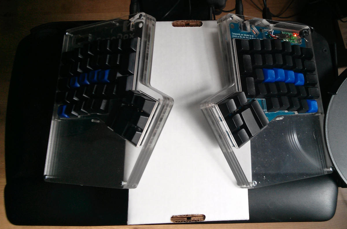

Regarding the thumb cluster, I'm finding it a little bit easier if I angle the two halves a little bit more. Still not perfect, but very workable. Of your two pictures I prefer the second---it puts the innermost thumb key right under my thumb.

Here you go :)
Now all I need is some rubber feet and some tenting!
- Layer LED closeup
- IMG_2821.jpg (386.01 KiB) Viewed 10296 times
- Layer LED
- IMG_2820.jpg (606.15 KiB) Viewed 10296 times
