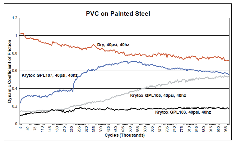

The Korean guys have moved on to Krytox oils. KG-8 not very popular nowadays. (Maybe because it is hard to get in Korea? I don't know. I tried them on Topre switches, but the effect wore off quite quickly and for that reason I don't recommend them.) RO-59's prime time was even before KG-8. RO-59 is seen as fail proof, but its performance is seen as inferior to Krytox oils.
KBDMania members use two types of oils for use inside of Cherry switch. One type for springs and the other type for plastic sliders. LSD oils are popular choice for the springs and Krytox oils for sliders.
By the way, there were significant amount supply of GPL103 in KBDMania from recent group buys. Thicker oils tend to have performance issues over time and thinner oils have durability issues hence 103 was chosen from discussions between members.( http://www.kbdmania.net/xe/3744764 )

Krytox GPL103.png (57.15 KiB) Viewed 4075 times
We will see what would be the next choice of lubricant and which lubricant survives.

You can see from the chart above, GPL103's service life is pretty long. I thought the experiment results were pretty impressive.

Low graph is better? I.e. lower scores on Dynamic Coefficient of Friction?

Yes. Low coef of friction is better. The above experiment is from PVC rubbed against painted steel. Plus, the two materials pushed against at 40psi, which I think is pretty significant force. GPL103's performance after 1 million cycles is not much different from initial application.
The source of the graph was wrong in the above post and I have fixed it. The chart is from http://www2.dupont.com/Lubricants/en_US ... tter_2.pdf
