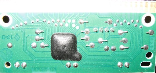

Updates:
1) Managed to open it - no marks of manufacturer.Controller is not a chip, but rather a blop of goop.
2) Switches/PCB are fully pin compatible with Cherry MX.
3) Switches are 50g (had a friend translate the manual)
30 Aug 2011, 21:29
What do you mean a blop of goop? It has alien biological hardware like seen in science fiction movies? I find this troubling. Are you sure this is not some mind control device introduced pending an alien invasion?
30 Aug 2011, 21:32
And what is this claim of multiple board throwing? If you have been doing throwing tests, we want to see the video.

@1 like in the newer G81s ?
@2 do you think the stems are compatible?

That epoxy mount technique is used on LOTS of cheap keyboards and toys too.
