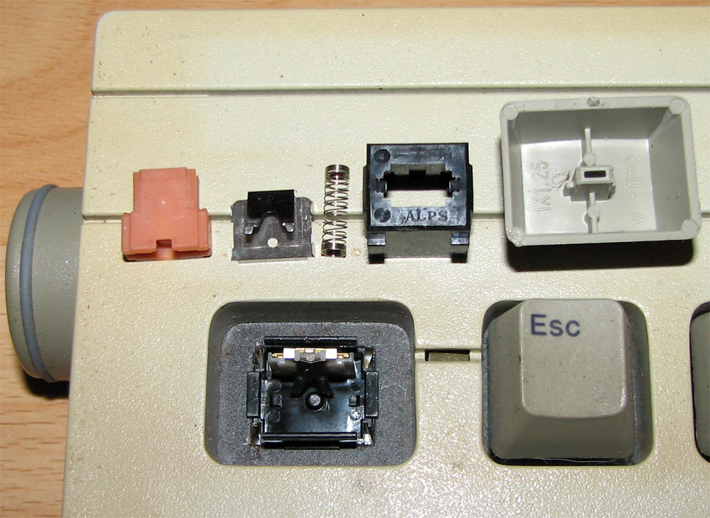

So I was right. Ripster, there's something I noticed in person that I didn't notice in your picture before (but I do now). The spring for orange is differently colored than the spring for pinks- one is a bronze color and one is a silver color. Any idea why that is?
Here are the pictures I took tonight.
So here's what I was right on: Orange ALPS do have a larger back plate. It isn't gray like with white/blue, though.
Pinks have the ALPS logo on the top, while the oranges do not.
The bottom has one difference. Pink on the left.
The orange and pink sliders are the same, but, they do come from different molds! The sprue mark is on the front of the orange slider but on the back of the pink slider.
Springs. They are different color. Like I said, I don't know exactly what this means, I don't know much about metals.
Here are the back plates inside of the switches.

I have a WANG with orange Alps and they have the ALPS logo on top.

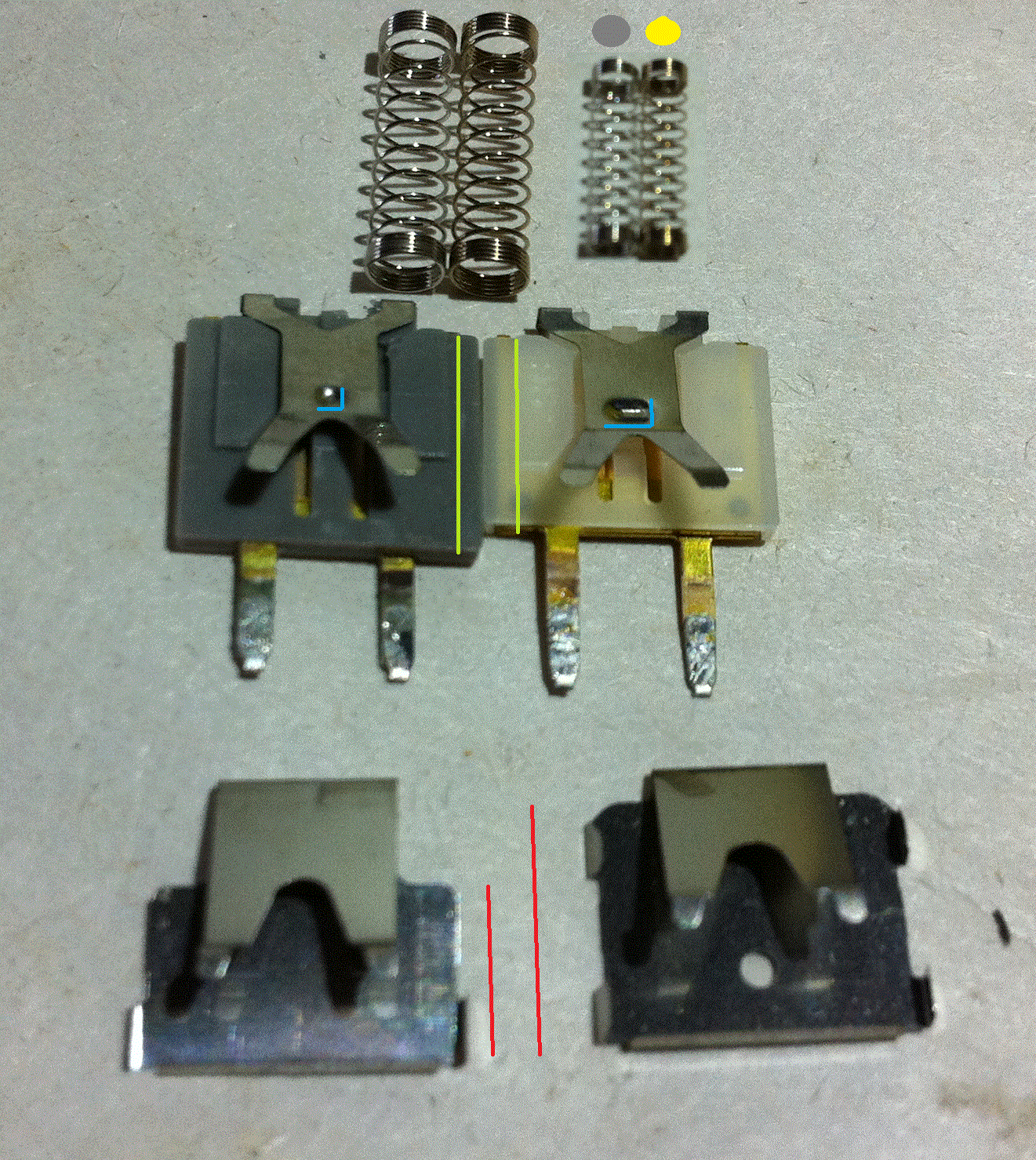

- Wibox
Looks like you got the short end of the stick.webwit wrote:wang.jpg
EDIT: nvm I noticed that wasn't the backplate you pulled out. Disregard ..
I wonder if all oranges without the ALPS logo ontop have the longer plate and all of the ones with the ALPS log ontop have the shorter plate..

My oranges have ALPS logo on the top, I will take one apart and compare photos with those posted here to see if there is actually multiple types of orange ALPS.

Ok, I took a pic of pink vs blue alps, highlighting the differences. Pretty much the same differences as the orange vs pink (I thought my pinks were orange, because it really is not a true pink color, I think salmon is a better word too).
So if pinks are the worse version of orange, how do blacks fit in? They seem to be exactly the same as pinks, but I got rid of my AT101 so I can't compare. Anyone want to explain?
Blue on the left, pink on the right.
- differences between Pink ALPS and Blue ALPS gif.gif (763.92 KiB) Viewed 22683 times
