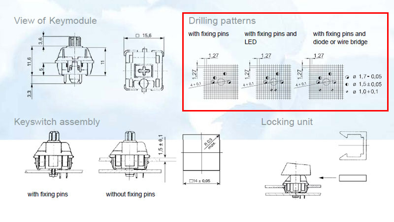

As you'd imagine, it is essential to align and place key switches mm-perfect since it could leads to mis-alignment of keycaps and spaces: and also change in stroke feel(especially with the switch + stabilizers).
Most of the people who's done this modification suggest to use a full plate or partial plate to align switches in right position. Without using mounting plate, it all depends on holes you are going to drill and as you can guess, this is not easy without proper tools.

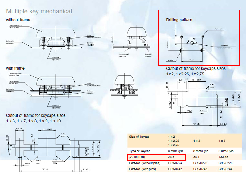

First of all, all the numbers can be found on CherryCorp. website.
NOW... WHERE and HOW???

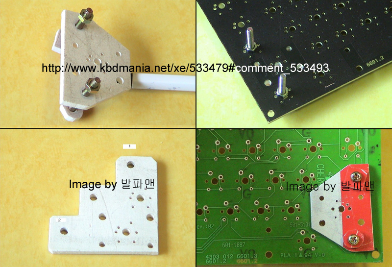

1. A guy from Kbdmania made this hole guide by himself for the drilling. The middle hole's diameter is 4mm therefore he used equal sized bolts to fix the guide firm onto the PCB.

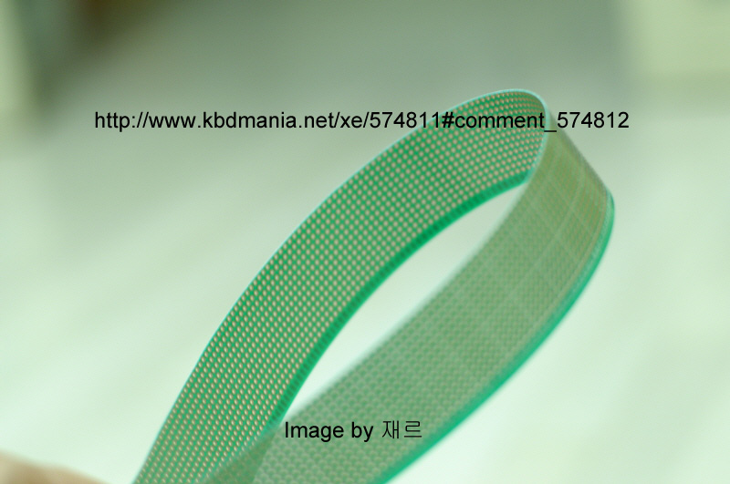

2. Another guy from Kbdmania used a thin-flexible PCB strip to position the switch onto the modifying PCB, by measuring exact distance of switches using the strip. Unfortunately, detailed procedure wasn't explained :cry: .

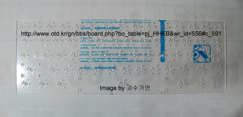

3. Finally, OTD members made a 'group buy', few of below hole guiding plates which helps the key positioning.
I am not sure how many of these have been made and circulated but unluckly, I wasn't able to get it.

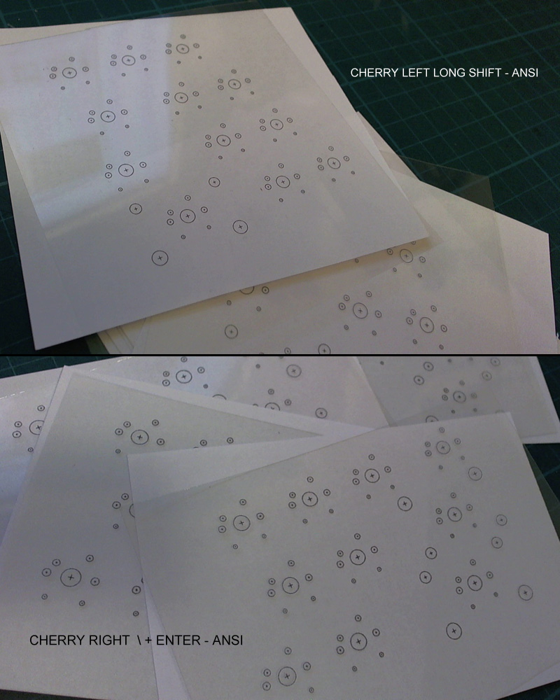

Since I couldn't get hold of those guiding tools, I decided to make my own hole guide.
With some help from a OTD member, toronet - I was able to draw a CAD version of Cheery MX ANSI holes.
Then I printed them on a transparent film like below.

This is already more info than I had ever hoped for. Thank you so much! Great stuff. Could you maybe share your CAD file to print on the clear foil? I would really appreciate it!

Questions: what's the distance between the centre of the main drilling holes? And are the main mounting pins dead centre of the switch?
nanu
17 Feb 2011, 02:02
Yes, the center post is dead center. This lets you conceivably mount a keycap in any direction. The side mounting pins are apparently centered along one axis.

nanu wrote:Yes, the center post is dead center. This lets you conceivably mount a keycap in any direction. So the mounting pins apparently are centered along one axis, just by eyeballing it.
Great, thank you! I don't have any accurate measuring tools, and I was optically fooled when looking at the pictures.

sixty wrote:Could you maybe share your CAD file to print on the clear foil? I would really appreciate it!
Sure, for me, I don't see a problem.
But I have to first ask toronet for his permission, I will get back to you as soon as he replys.

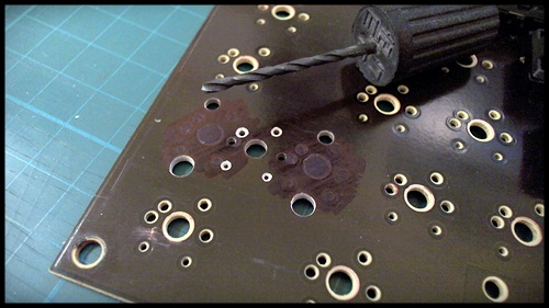

Within this part I would like to introduce few of the tools I am using to block, drill holes and also few tips as well.

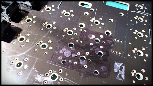

Some people are not bothering to block existing switch and stabilizer holes prior to drill new ones. But I've decided to block them first. I used P38 Car body filler as this stuff adheres well to most materials, also it dries fast and hard on most surface.
First, using masking tape, cover the area, around the holes you will block with the filler.
Apply the filler to holes, but careful not to over fill as this will require more time to sand (or cut) down. The paste can be applied in several layers and the final layer should be just proud of the level required. Personally I didn't use a sand block, instead I used a sharp blade to level the surface after it is softly harden.
I mostly use this filler when I cut and modify cases. It works as a good adhesive and also adds a good strength to the case by thickening the area around the cut.
With Cherry G80-2100, Left-Shift won't need above process as it already has extra switch holes for placing a long-shift key caps. Thanks to Cherry! ;)
After clean the surface of the blocked holes, don't forget to take a closer photo of the PCB pattern as you will require wire soldering around this area once new holes are drilled. New holes probably will break few patterns and it is essential you to link all the broken points with wires to get the keyboard works properly after the modification.
Next step is to place the clear hole-guide onto the block area. Do this with plenty of light around you so you can place the film exactly where it should be.
Now you are ready to drill!

With these kind of job, I will need just around 10000~17000RPM and Proxxon 50EF and MB 140/B should do the trick..
I am using my existing dremel drill bits and finally an automatic hole-punch would help a lot centering each drilling.
Once the drill stand arrives I will try to post few pictures and movies of my own modification in Part 3.

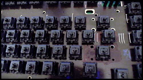

I've been working on 2100 and 1800, and it seems 2100 PCB is much thicker and harder than 1800s' as 2100 PCB needed more RPM(17000-20000) to drill a 4mm hole. The video shows drilling few 1.5mm holes and in this case I could easily manage to hold the board on tight, but when drilling 3mm and 4mm holes, decent clamping tool would help a lot.
[Tips]

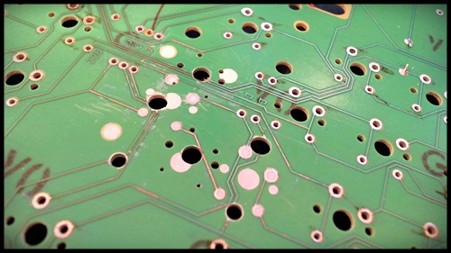

1. Make sure you take all the photos of the boards' circuit pattern also from the top view. You probably need to take few jumpers prior to drill and you will need this photos to check where they all go back and soldered. Also you need to connect all the broken circuit patterns with wire after fitting switches.
2. Before fitting switches into those new holes, don't forget to clear edges of new holes(specially with those holes for 4 pins) to prevent any short-circuit. Just turn and screw a wider drill bit few times on each hole. [/color]Link

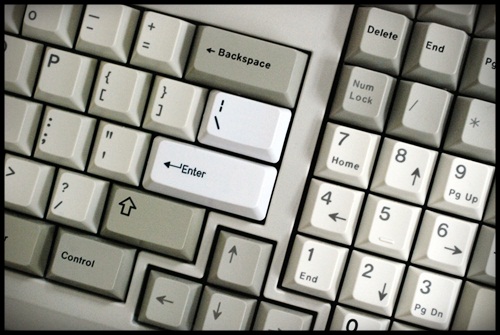

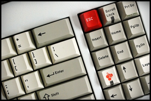

G80-2100 Enter and Backslash Mod.
G80-1800 Left-Shift Mod.
G80-1800 Enter and Backslash Mod.

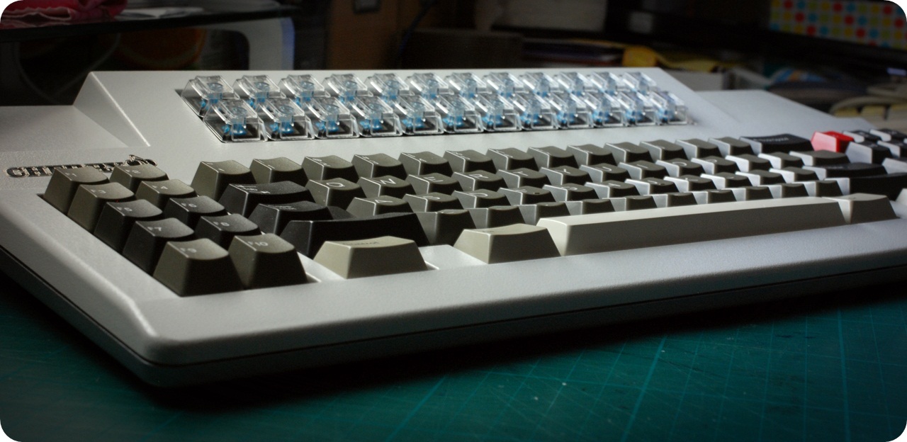

And Finally, MX2100 Saver with Dolch Replicas;
Well, I am quite pleased with the result with my first key layout modification.
But if I get another chance to do it, I would use better bench drill rather than dremel or proxxon basic drill stands next time, also would use a firm clamping tool for drilling 3, 4mm holes. Hope this will give some ideas to anyone planning to try ISO to ANSI modfication in the future.
And good luck to you, sixty! ;)

microsoft windows
24 Feb 2011, 00:24
Cool keys! I like those "Ice cube" style ones a lot.
24 Feb 2011, 00:46
Well done, looks fantastic!
sixty
Gasbag Guru
24 Feb 2011, 01:05
Very nice results! It almost looks like a retail PCB. Very clean!

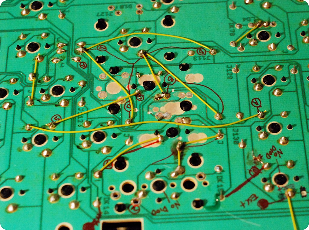

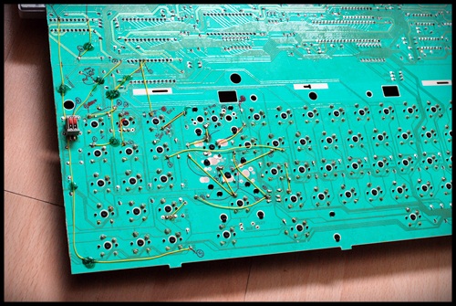

The 2100 looks like it needed quite a lot to get it working again, but I assume some of those are also for your tenkeyless mod. How many jumpers did you need to actually fix the PCB again (aside from those for your cut off numpad)?
mass
24 Feb 2011, 01:22
sixty wrote: How many jumpers did you need to actually fix the PCB again (aside from those for your cut off numpad)?
Here is the closer pic of the pattern which were fixed. Around 10 I guess.
BTW tthe photo is up side down.
DSC_0549 (2).JPG (239.88 KiB) Viewed 27024 times

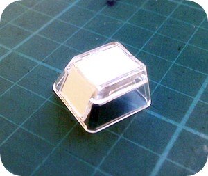

Got those from a member of OTD.kr
It is actually not a LED key cap.
Picture 156.jpg (20.07 KiB) Viewed 27015 times
I just didn't put any label in it.[/color][/size]

Minskleip wrote:Questions: what's the distance between the centre of the main drilling holes? And are the main mounting pins dead centre of the switch?
All the main holes should be .75" pitch exactly. One of those times when good ol' Imperial Rulez.
