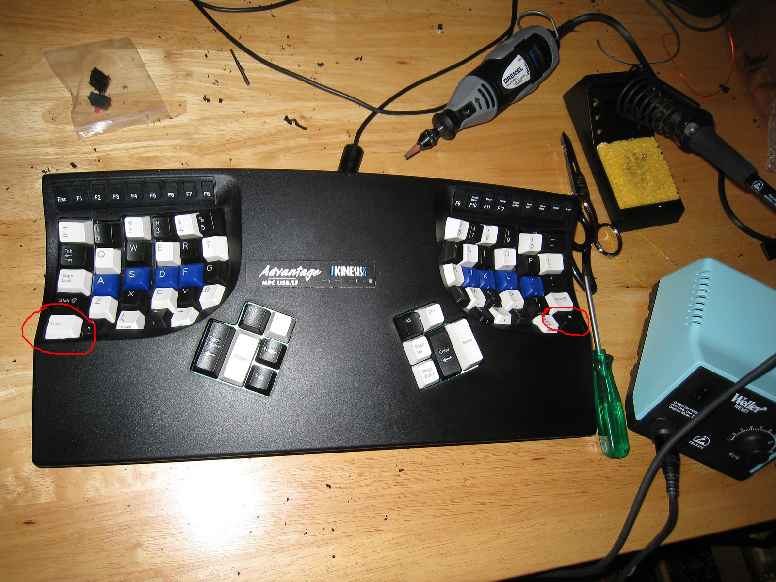

This afternoon I adedd extra keys under each shift on my Kinesis Advantage LF.
I'm using these keys for momentary access the 2nd layer of the keyboard (as opposed to the toggle function of the rubber keypad key). You can also assign extra keys to anything else, like Windows keys or whatever.
I highly recommend this mod, and posted a HOWTO here:
http://geekhack.org/index.php?topic=26579.0

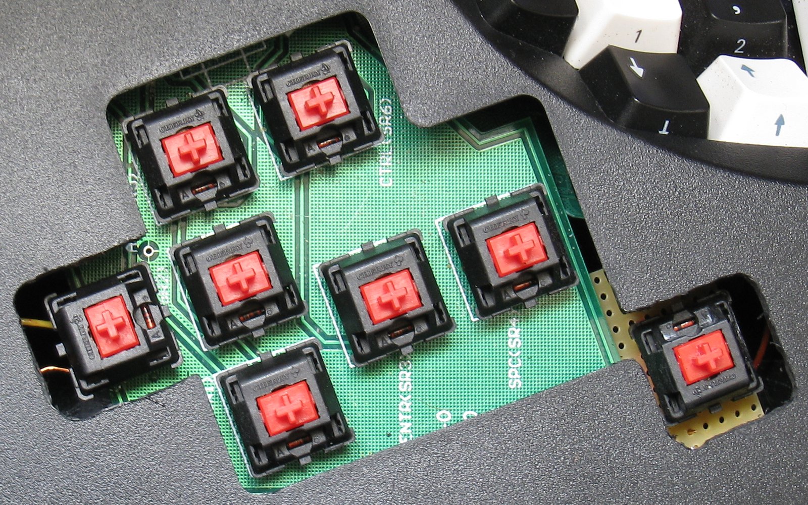

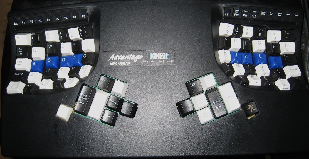

Today I added extra thumb switches as well. It took more work than the first mod, since it involved adding extra PCBs for mounting the new switches. Final result:
Posted: 02 Feb 2012, 18:03
by Findecanor
I am interested in, why did you mount the thumb-switches so low? Was it not possible to mount them aligned with the Space / Backspace keys?
Posted: 03 Feb 2012, 03:03
by sordna
I wish, but the lower keywell mounts/screws are in the way!
You can see details in part 2 of my mod wiki:
http://geekhack.org/showwiki.php?title= ... thumb+area
Right now the switches fall between the 1st and 2nd knuckle of the thumbs. Actually, I'm thinking I should probably have moved the switches even lower, so they would be hit by the 2nd knuckle (base of the thumb). It would make these modier keys easier to hold down.
Posted: 05 Feb 2012, 04:48
by sordna
I added another 2 keys today, using up the last footswitch terminal on the keyboard. With 6 extra keys total, I'm happy and don't think I will need any more; these keyboards have 2 programmable layers anyway.

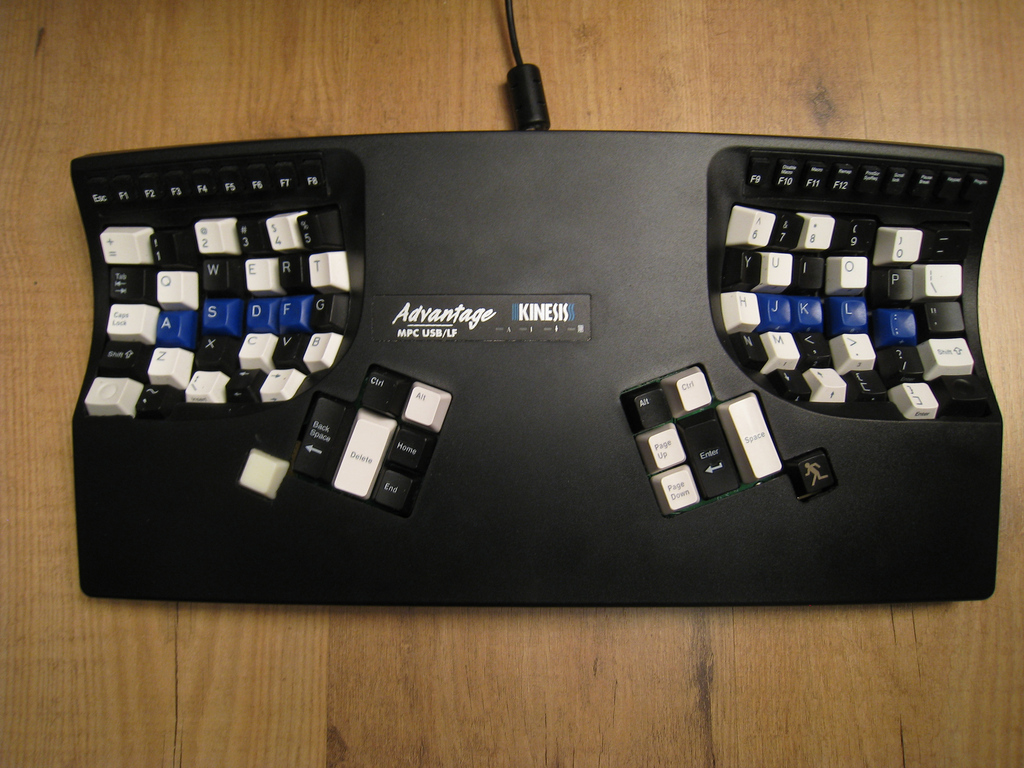

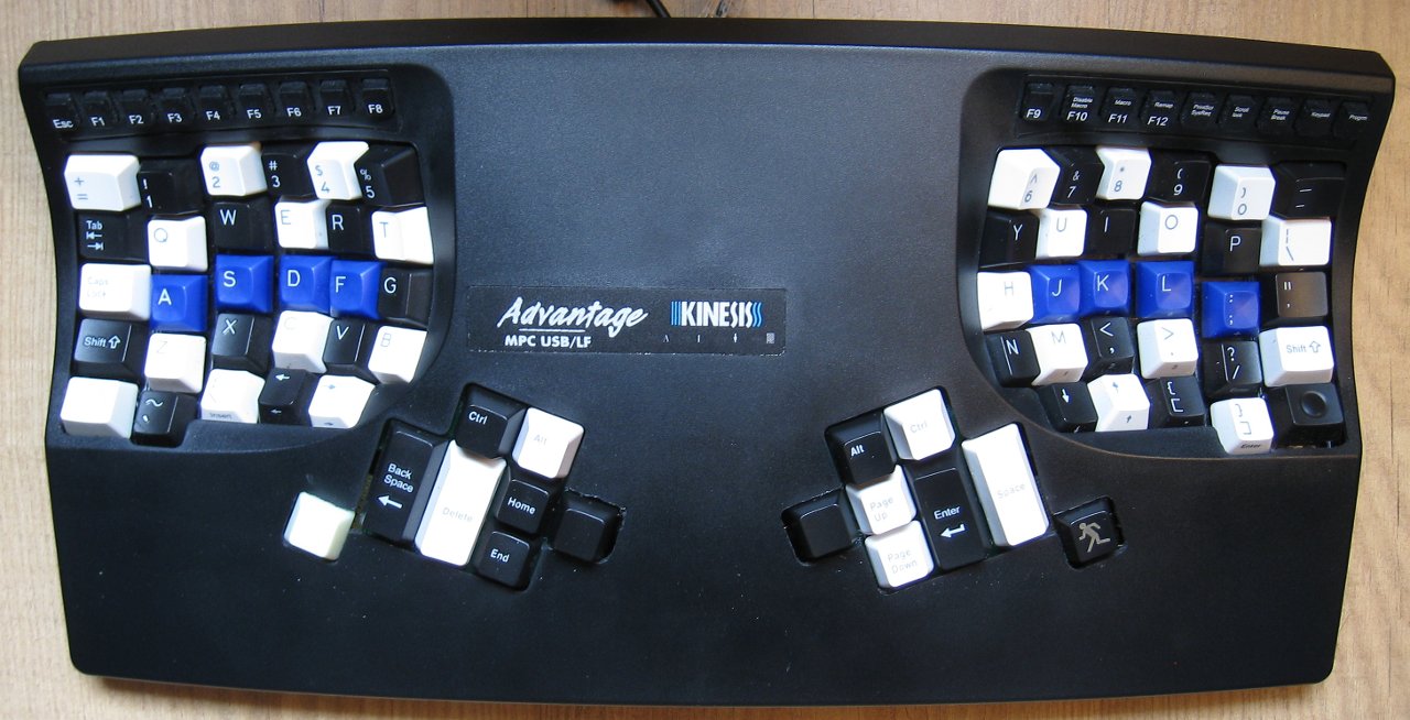

Posted: 06 Feb 2012, 20:46
by sordna
Adding some further pictures:

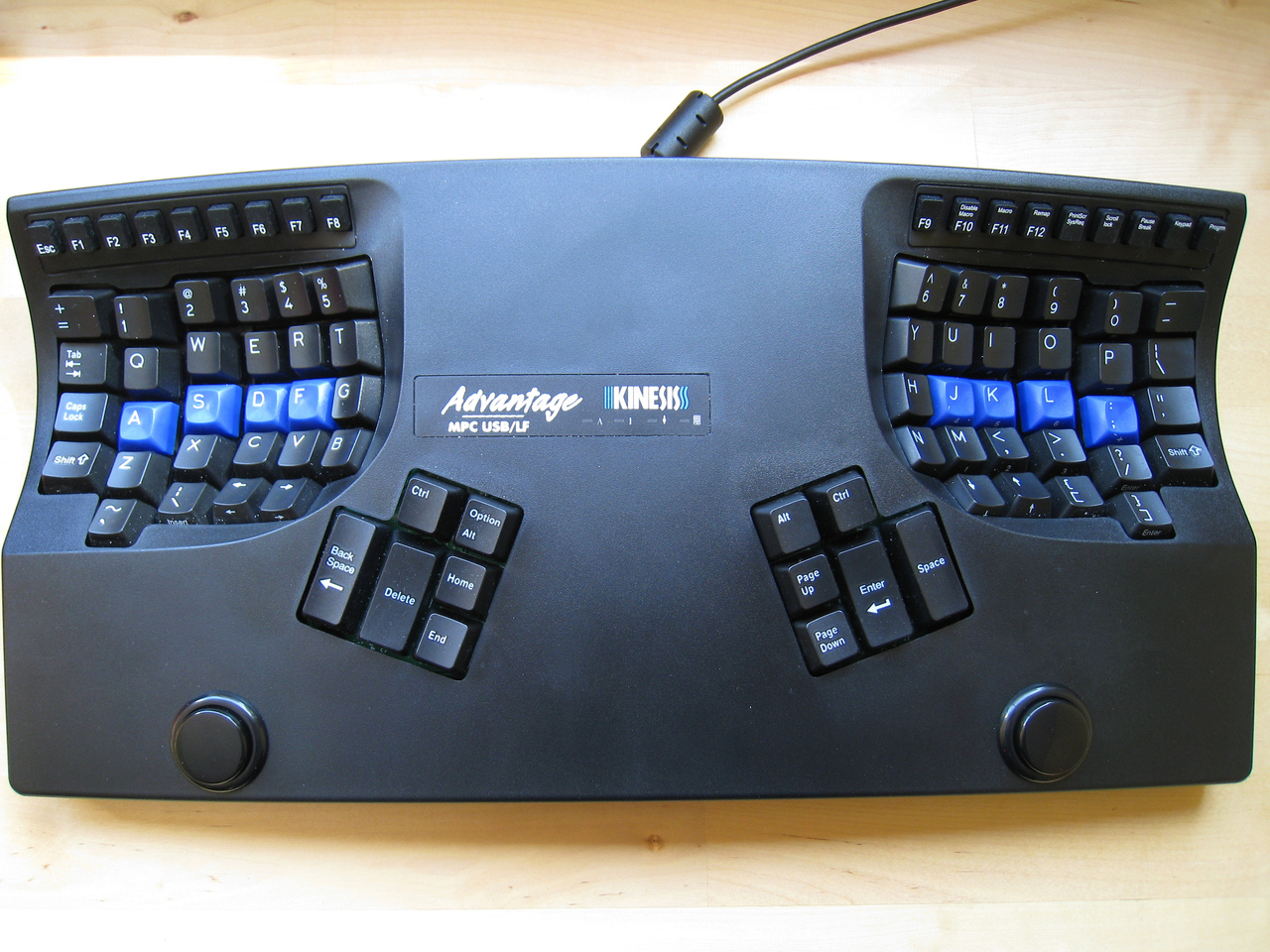

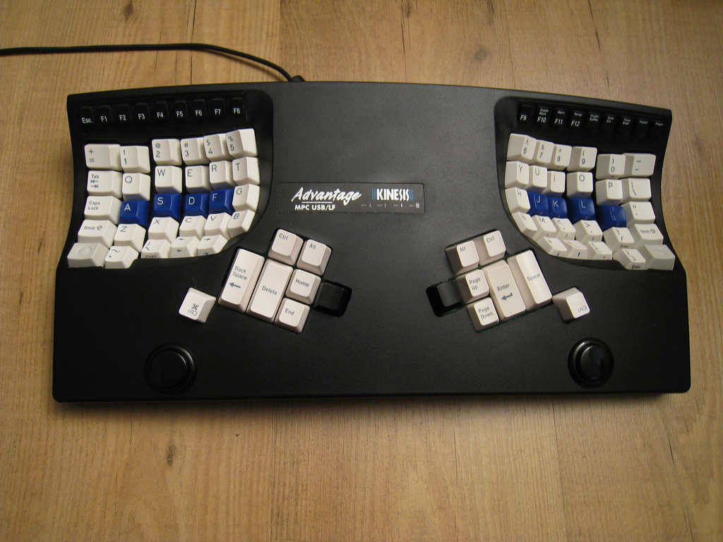

Arcade buttons added for palm keys:

Posted: 31 May 2012, 01:54
by sordna
Here is my work keyboard, with palm keys being the only modification. It's honestly the best single modification you can do, and it's so easy; it doesn't even require a soldering iron... just a step drill bit, and 15 minutes of your time.
Posted: 31 May 2012, 02:34
by Input Nirvana
I have NOT done this mod, but I have played extensively with the placement and function of the "palm" keys on the case. I believe this is a fundamental shift for an ergo option with this keyboard, and is the single largest improvement that can be done.
Hats off on this. Please post what exact measurements you belive would be ideal.
Posted: 31 May 2012, 23:44
by sordna
Each hole center is 20mm from the south edge of the keyboard and 78mm from the side edge.
However, having used these for a while, believe that I placed the buttons too far toward the middle of the keyboard. I can see part of the button if I look down while I'm typing, and find myself having to move my hand inward in order to push the button properly.
The holes should therefore be closer to the keyboard sides, ie I would drill the pilot hole at 70mm (or even less) from the side edge of the keyboard, so the buttons are more directly under my hands.
Having said that, I love this mod, it's an absolute MUST. Way better than a footswitch which gets kicked around and forgotten. The palm keys are always there, where you need them.
It's also a much easier mod than any other key addition I tried.
Posted: 01 Jun 2012, 09:46
by Icarium
What keys are those again? Tried to find similar ones but it turned out harder than I expected.
Posted: 01 Jun 2012, 17:32
by sordna
Seimitsu PS-15 (they are low profile arcade buttons, that don't extend too much inside the case).
Here they are in yellow, you're in Germany right?
http://www.arcadeshop.de/Seimitsu-Butto ... b_746.html
Posted: 02 Jun 2012, 12:02
by Icarium
Wow, that's some service. :D
Thanks!
Alright, immediately ordered two black ones from that place.

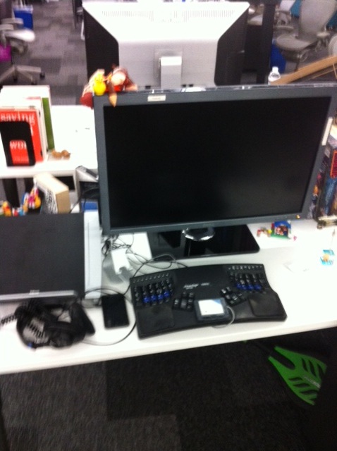

I was at the Facebook campus the other day and saw this....
Facebook Kinesis.JPG (77.03 KiB) Viewed 20169 times
Kinesis Advantage with a Cirque touchpad.

Input Nirvana wrote:I was at the Facebook campus the other day and saw this....
Mein Gott! Open office space. The pour souls.
Posted: 17 Dec 2012, 01:21
by vivalarevolución
An open office makes the assumption that you actually want to communicate with your co-workers. Why would anybody want to do that?
