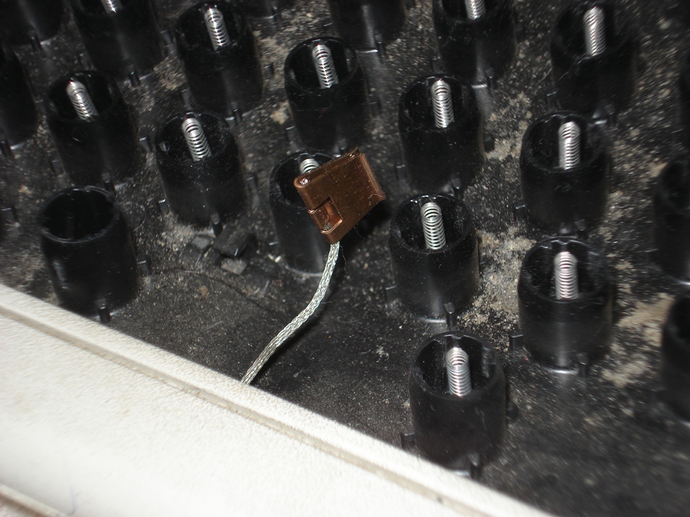

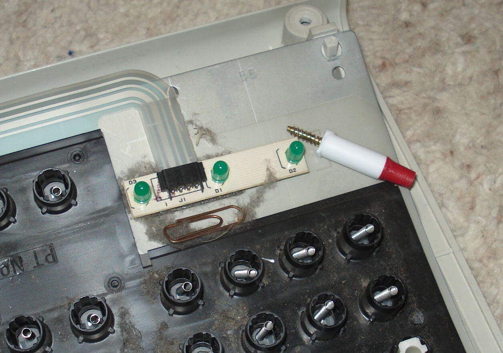

I just took the caps off of the model M I got from Ascaii and found this little flag or whatever. Can anybody tell me what it is? The bold-mod article didn't contain anything on disassembling.

Ground, to prevent you from electrocution and instant death while using a Model M. Only in keyboards from IBM UK, EU regulations and all.

Indeed. I think it's only found on newer model Ms. My UK-manufactured 1396790 (blue label) from 1995 has it while my 1390131 from 1986 (square silver label, also UK-manufactured) doesn't.webwit wrote:Ground, to prevent you from electrocution and instant death while using a Model M. Only in keyboards from IBM UK, EU regulations and all.
BTW, I highly doubt that this ground wire has any effect at all.

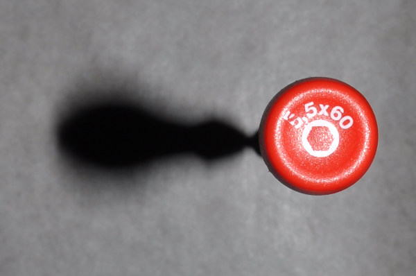

You need a 5.5mm nut driver, which should be plentiful at your tool/model shop or regular electronics supplier of choice.

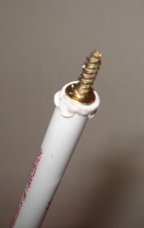

Alternative method:
Step 1: Get a pen, like the Bic pen in the picture.
Step 2: Open the rear end.
Step 3: Burn the rear end. Use a lighter or something. Don't burn it too much. The plastic needs to get weak.
Step 4: Put the rear end in one of a Model M's screw holes so it fits over one of the bolts. Press firmly.
Step 5: Wait until the plastic gets firm again.
Step 6: Start to unscrew the bolt.
Step 7: Break the pen, fail to open the Model M.
Step 8: Buy a 5.5mm nut driver.
Everyone can do it.

5.5 mm or 7/32 inch. Actually, they are not that common in metric Europe. I see you're living in Germany; you could order one at Conrad:Icarium wrote:Okay, next step. Where do I find a damn screwdriver that will open this thing? *sigh*

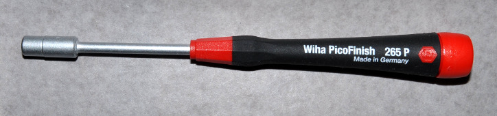

I've ordered one from an autoshop in France and the nut driver is too large for the ssk hole.
For the Model m it fits only if you push strongly...

That's a good point - make sure the outer diameter of the head fits in the hole. You can get slimline ones. I suspect ones made for work on vehicles are designed to be rather more heavy duty...

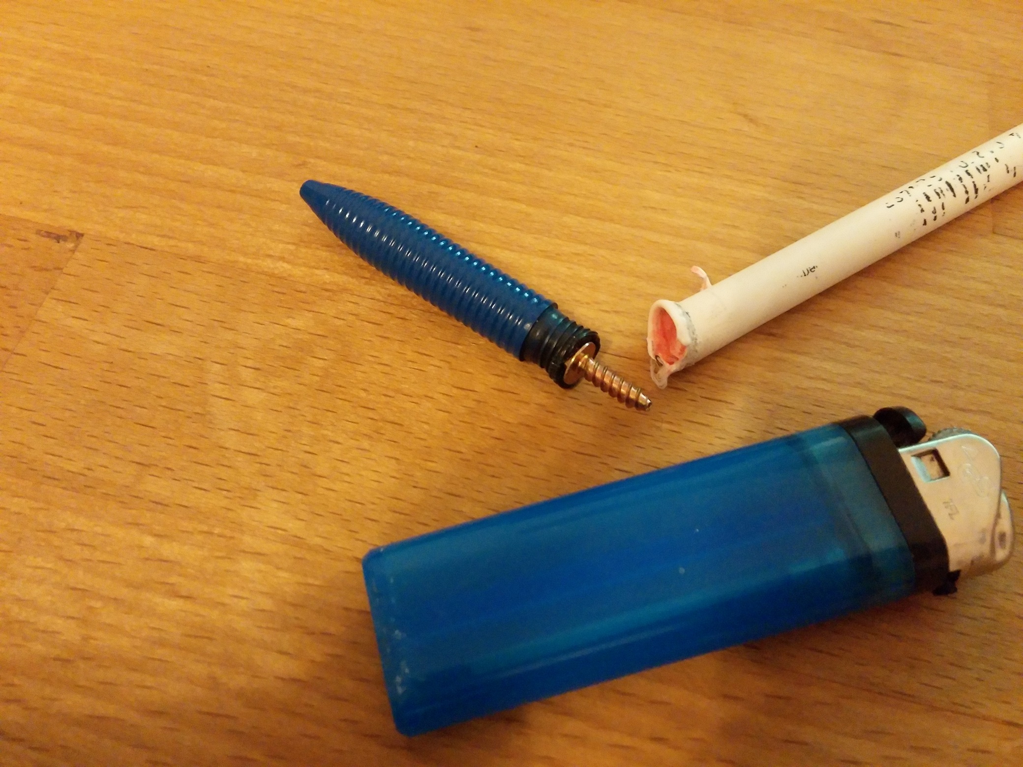

Damn you, you crazy dutch prophet!webwit wrote:Alternative method:
1. It actually works. I was absolutely amazed.
2. As you predicted the damn pen broke exactly after 3 of the 4 screws.
BUT I eventually managed to do it again after cutting of pieces of the pen several times.
(Also note the free paperclip, thanks Ascaii!)
Pen: Giveaway
Lighter: 1 Euro
Poisoning myself with plastic fumes next to an open window at -10 degrees celsius because the dutch keyboard guru says so: PRICELESS
In other news, this is not the first pen that had to die for this model M:

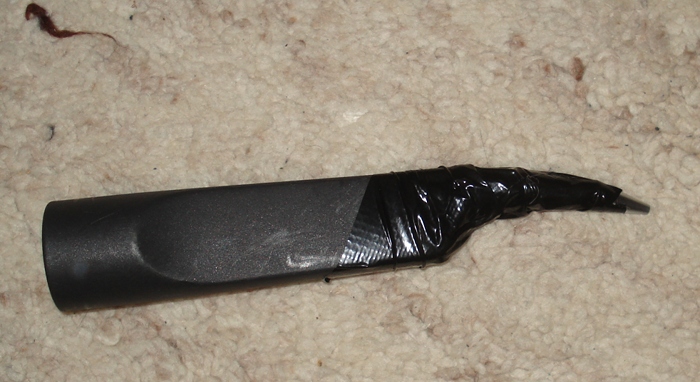

Here is another one:Gilgam wrote:I've ordered one from an autoshop in France and the nut driver is too large for the ssk hole.![]()

The "flag" is a clip which attaches the static drain wire to ground. Static electricity can and does build up when skin is rubbed against plastic repeatedly (the thumb hitting the space bar). You think they put it there just for fun? Perhaps you'd enjoy frying your semiconductors or getting a static shock instead. ^_^Kurrk wrote:Indeed. I think it's only found on newer model Ms. My UK-manufactured 1396790 (blue label) from 1995 has it while my 1390131 from 1986 (square silver label, also UK-manufactured) doesn't.webwit wrote:Ground, to prevent you from electrocution and instant death while using a Model M. Only in keyboards from IBM UK, EU regulations and all.
I'm quite surprised noone else realised what this is for...

Static build up and needs to drain to earth: show me what part of that information is trolling.
Read part 1 of this article: http://www.osha.gov/dts/hib/hib_data/hib19880930.html
Then this: http://www.resistoflex.com/staticdischarge.htm
And this: http://www.explainthatstuff.com/howanti ... swork.html
You may be the keyboard experts, but even experts have gaps in their knowledge. It doesn't take much thinking to realise that a grounded copper conductor will drain away a surface charge of static electricity.
