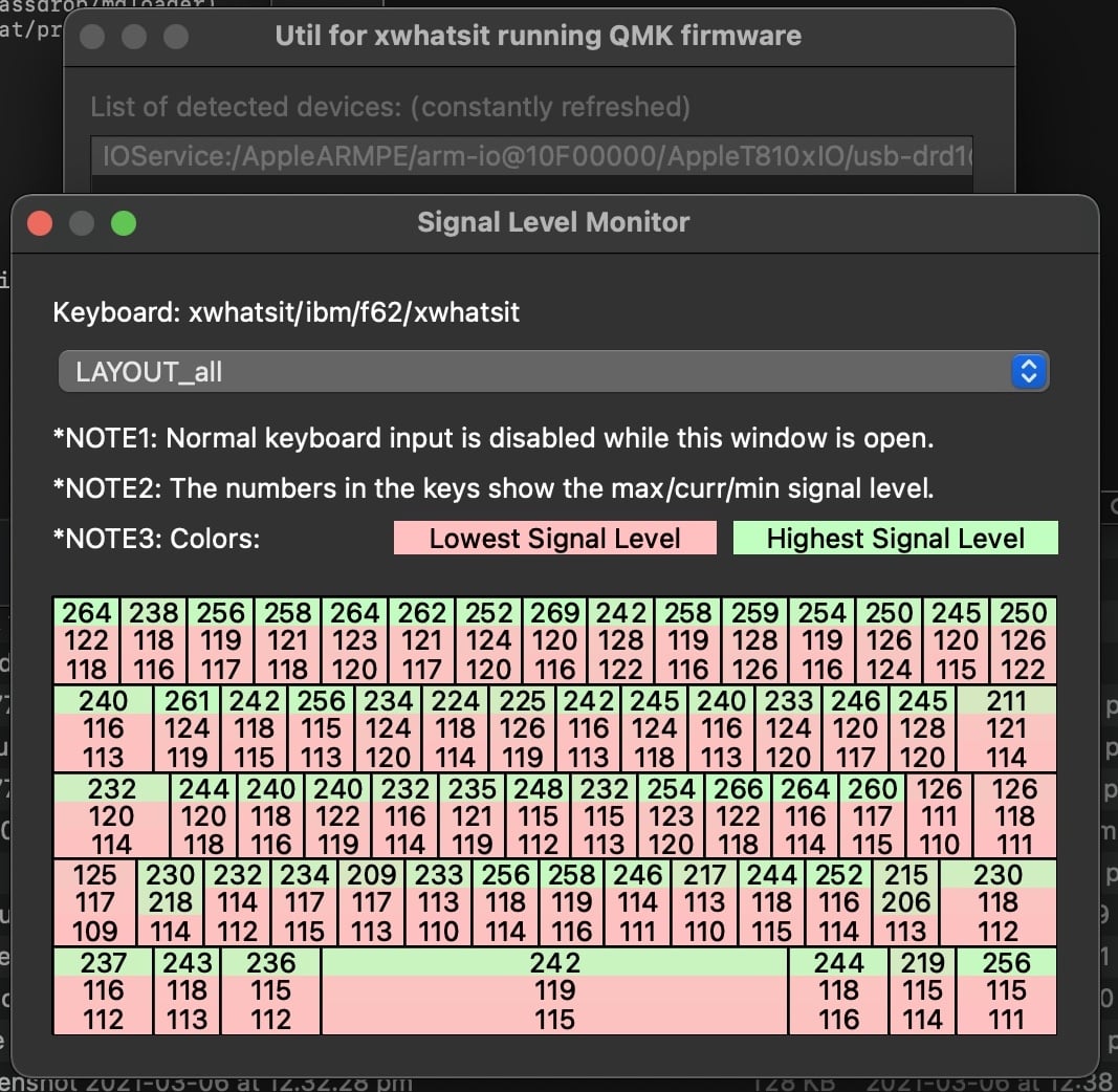

So, here I am, having just followed those instructions myself with my Xwhatsit powered AT. Built my own firmware using the interface within. So far so good!
I didn't need to open the keyboard up—or find an older Mac to run Xwhatit's old GUI on—just to enter the bootloader for flashing. Simply using XMIT's build of the config tool and QMK Toolbox has me all set. Impressive work!
One weird thing is the Caps Lock LED is lighting up momentarily on every keypress, which feels even more oldschool than this AT! Those LEDs were working fine with Xwhatsit's firmware immediately before I reflashed to this, so it's not a wiring issue.

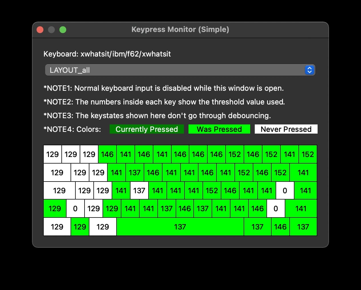

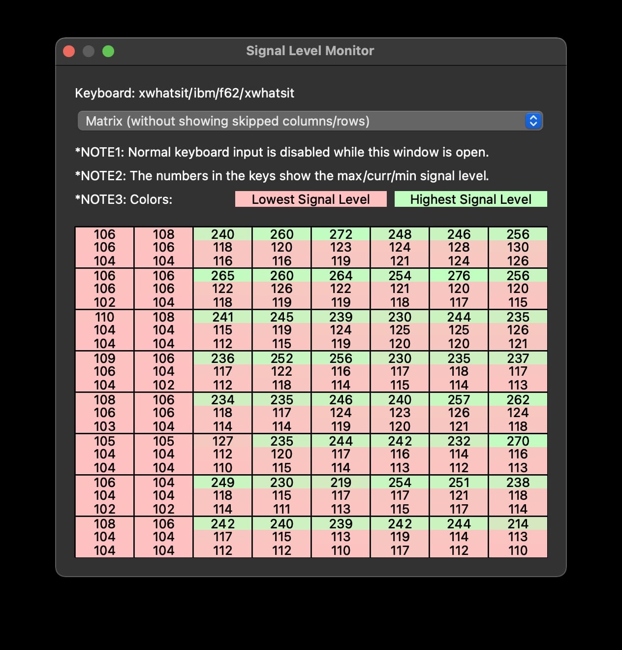

Ahem. The Kishsaver's going to need more work. The firmware loads fine but all the keymappings are wrong. This is what the key tester looks like once I've thoroughly mashed the keyboard:
Screenshot 2021-03-13 at 11.43.19 am.jpg (108.04 KiB) Viewed 26119 times
It's a basic matrix mapping issue in the LAYOUT_ansi_regular_shift_split_backspace definition. All the keys seem to trigger something in the levels test, shown here after a comprehensive mashing:
Screenshot 2021-03-13 at 11.52.21 am.jpg (183.59 KiB) Viewed 26113 times
For what it's worth: my Kishsaver actually has Xwhatsit's prototype Model F controller installed. He sent it to me for testing before the rev.1 production run. Maybe the pins are mapped differently? It is a bit smaller than the final model, as I recall. I wonder how I'll fix it in software…
Here's my Xwhatsit config file, showing the correct matrix mapping:

Oooh! Thanks Pandrew!
I just rebuilt my Kishsaver map on your new configurator, and it's getting there. All keys in the matrix now show up, but several are still in the wrong spots. The ASDF and ZXCV rows both need some work, and Left Shift and Return keys are like this:
Screenshot 2021-03-13 at 1.54.08 pm.jpg (185.83 KiB) Viewed 26078 times
Left Shift is showing up in the hidden pad under that key, while Return is showing up in the hidden pad under Right Shift.
Here's the jiggled keys:
S is mapped to X
D to F
F to D
G to H
H to G
J to K
K to J
L to ;
; to L
' to /
X to S
/ to '
Flip those around and it's looking mighty fine!
Oh: none of these alpha key presses show up outside of (XMIT's Mac build of) your tools. I know they block the keyboard when running in monitor mode but this is also true when they're closed. Yet pressing Command + Tab works just fine for app switching. I don't know what that's all about.
Edit: oh, they do all work *before* running the tools. But they're all disabled after quitting, including Cmd+Tab. Huh… I probably need a new build to match these firmwares.
