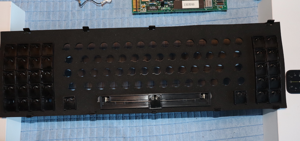

I am looking for the foam templates from Wcass but I cannot find it can someone link the post to me. I am looking for the model f xt. Thanks

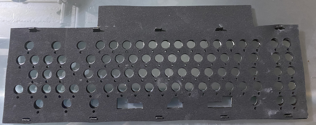

I have used the attached file for F AT foam and it was a perfect fit. I have not looked at the other files (I only manipulated them so they can be laser cut). If you need them for another keyboard, please share the file and results, when done. I would love to make all foam cut files available on my web page at https://www.bucklingspring.com.Samdoses wrote: 02 May 2021, 16:35 I am looking for the foam templates from Wcass but I cannot find it can someone link the post to me. Thanks
I also have converted these two versions which I checked against the Laser Cutting analysis tool for correctness. They contain the SVG file and the PDF. They all are derivatives of a version from the link earlier:

Sorry I meant for the xt versionhellothere wrote: 02 May 2021, 16:53 viewtopic.php?f=2&t=8033
I did a quick check. I think the templates start on page 5.
- Location: England
- Main keyboard: Ibm model M
- Favorite switch: buckling switches
Sorry I meant for the xt versiondarkcruix wrote: 02 May 2021, 17:15I have used the attached file for F AT foam and it was a perfect fit. I have not looked at the other files (I only manipulated them so they can be laser cut).Samdoses wrote: 02 May 2021, 16:35 I am looking for the foam templates from Wcass but I cannot find it can someone link the post to me. Thanks
Model F AT-Model.pdf.zip
F122.zip
F62.zip

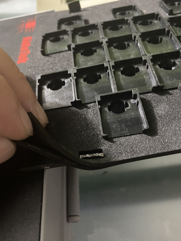

I know this thread is about a template, but here's something that works really well for me. To mark the foam, I like to put it between the front of the barrel frame and the back of the backplate, holding them firmly together with binder clips. The foam should be sandwiched nicely and won't give, meaning it should be super easy to use a pen and mark the holes accurately. Be careful not to crush any stabiliser clips. You can legibly mark black foam with one of those glittery metallic pens.

can I put it together normally without the barrels (I have no clips on hand) or does it make it easy in the order you mentioned. ThanksWazrach wrote: 02 May 2021, 18:58 I know this thread is about a template, but here's something that works really well for me. To mark the foam, I like to put it between the front of the barrel frame and the back of the backplate, holding them firmly together with binder clips. The foam should be sandwiched nicely and won't give, meaning it should be super easy to use a pen and mark the holes accurately. Be careful not to crush any stabiliser clips. You can legibly mark black foam with one of those glittery metallic pens.
- Wazrach
- Location: Tyne and Wear, United Kingdom
- Main mouse: Razer Viper 8KHz/ Viper Mini
- Favorite switch: Buckling springs
You just literally use the bare plates to sandwich the foam, basically the reverse of how they normally are - the outside of the backplate touching the front of the barrel frame without any barrels. Then you use the barrel plate as the template.Samdoses wrote: 02 May 2021, 19:10can I put it together normally without the barrels (I have no clips on hand) or does it make it easy in the order you mentioned. ThanksWazrach wrote: 02 May 2021, 18:58 I know this thread is about a template, but here's something that works really well for me. To mark the foam, I like to put it between the front of the barrel frame and the back of the backplate, holding them firmly together with binder clips. The foam should be sandwiched nicely and won't give, meaning it should be super easy to use a pen and mark the holes accurately. Be careful not to crush any stabiliser clips. You can legibly mark black foam with one of those glittery metallic pens.

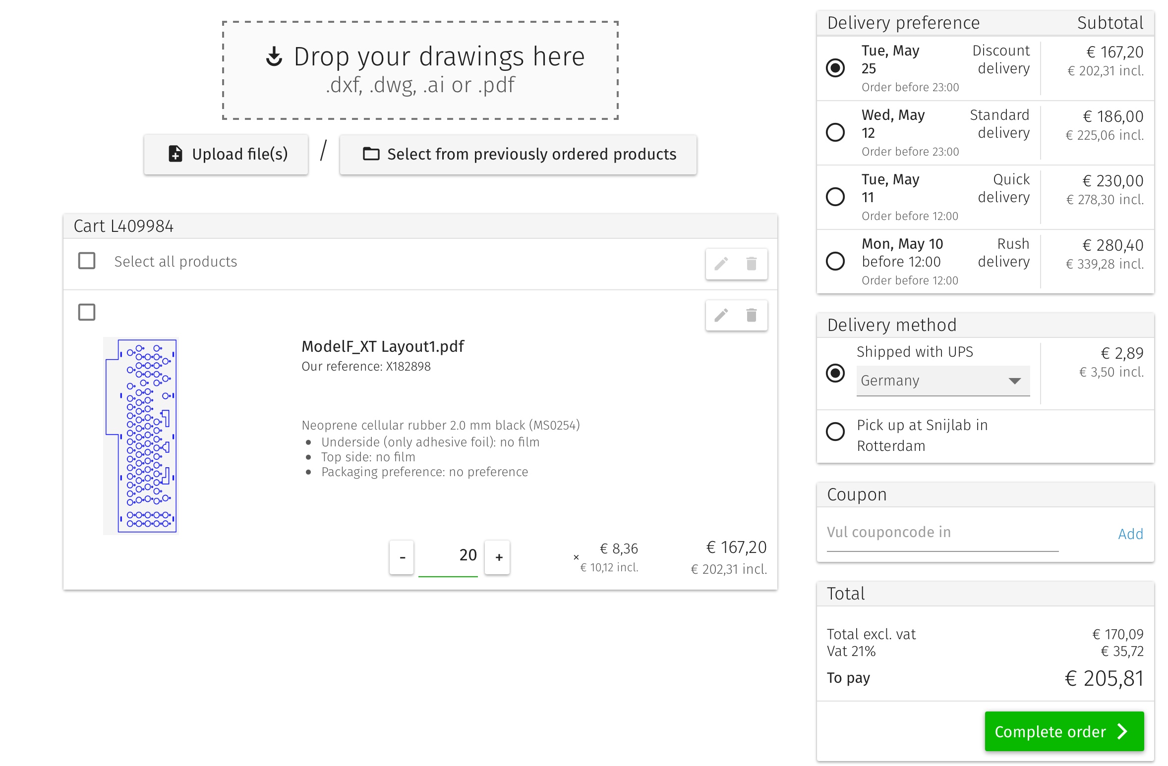

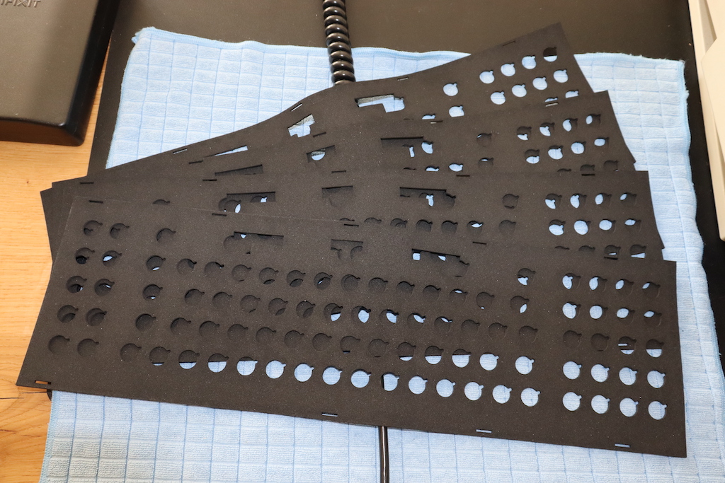

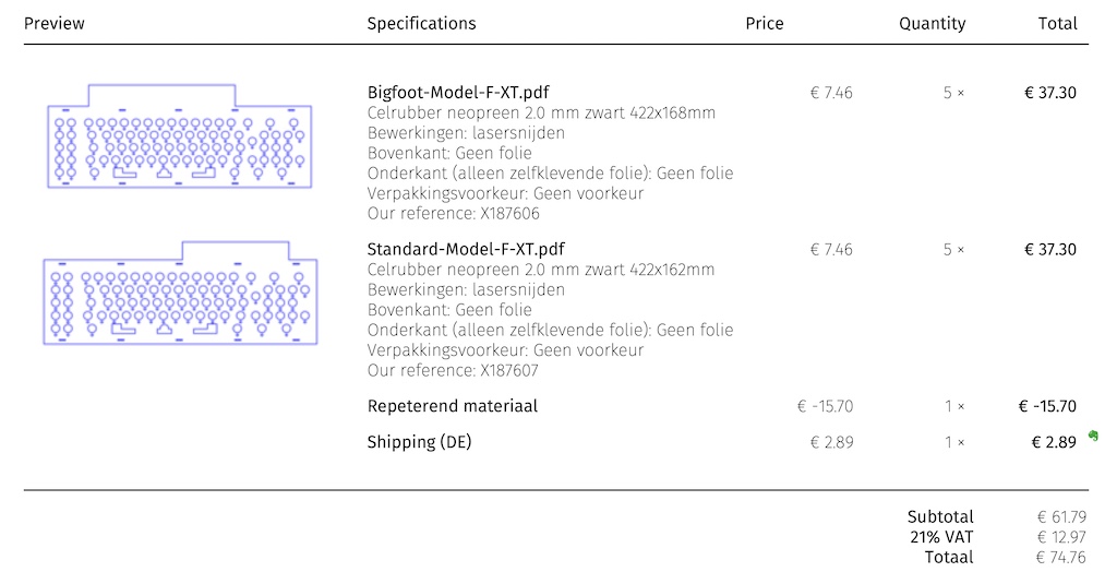

I made 5 AT neoprene mats ... I only needed one. The problem is the price. The cut in low quantities is the problem. I paid $65 for the first mat and <$115 for all six I made. If I would get 20 pcs. created for each major model the price would be at $30 each - without shipping. I doubt that people would pay such a high price for it....hellothere wrote: 04 May 2021, 00:04 I think I mentioned elsewhere, but I would definitely, absolutely pay for someone to make Model F "foam" mats ... if I ever get another Model F in need of repair, that is. While I think the templates are great, I must have failed scissors, hole punches, and Xacto knife trimming in high school. My best job pales in comparison to laser-cut.

For 20 I'd pay 205 EUR shipped, that is US$ 248 (would be ca. $15 per piece if I calculated that correctly).
I am based in Europe, so it would not make a ton of sense to ship them across the pond.
I am happy to get a bunch made here in Europe and pass them on - what would you say are the most common ones needed?

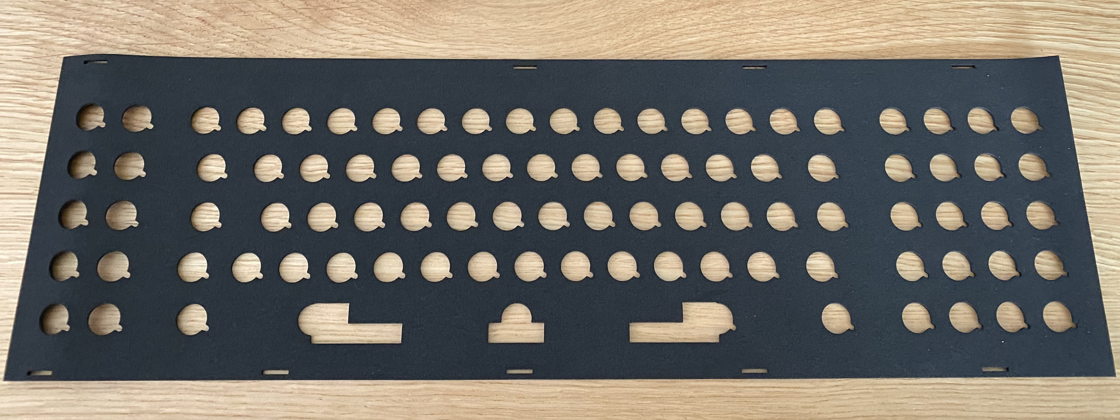

I have a first delivery of Model F AT foam, 2mm Neoprene. I'd sell it for US$ 20, but have no clue about international shipping costs etc.
As the foam can be placed in a padded envelope, it should be relatively inexpensive.
Please PM me, if you are interested in F AT foam ... pictures of it an earlier batch can be seen here but the new cut is exactly the same, made by Snijlab in The Netherlands:

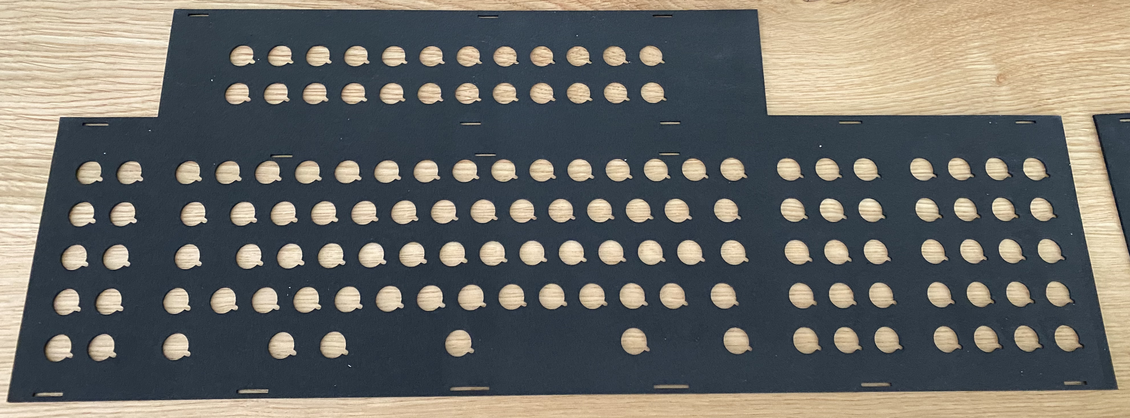

Properly sized foams are available:
IBM F122, 2mm neoprene: US$ 28
IBM F62, 2mm neoprene (not for the reproduction): US$ 12
IBM AT, 2mm neoprene: US$ 14
Shipping cost depends on the country it needs to be shipped to, I am based in Germany / EU.
I only have a small amount available, please PM me.

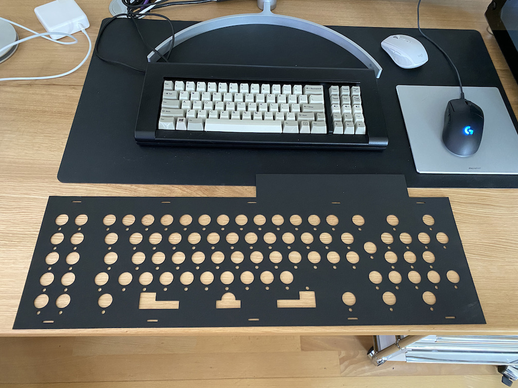

Shoot, I would've totally purchased one from you if they were the right size. Any plans to try another batch?darkcruix wrote: 07 Jun 2021, 11:35 If someone wants to build an extremely oversized Model F XT, I have foams for it ....
Also, I was wondering how you decided on neoprene cellular rubber for the material. I tried researching what foam to use for the Model F, and this is the first place I saw someone mention a material. Is that what IBM originally used?

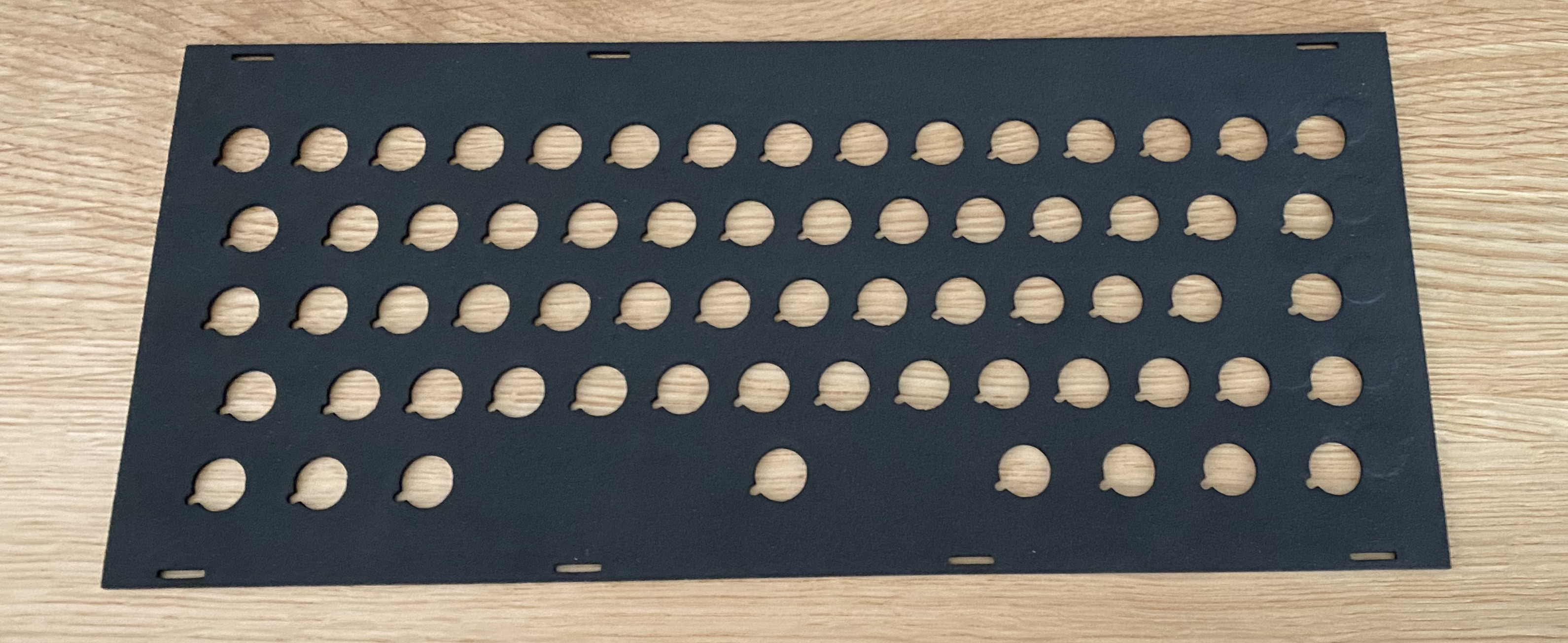

I created my own templates and I ordered a very small batch for testing now ... I'll keep you posted on the outcome.qzyki wrote: 23 Jun 2021, 08:37Shoot, I would've totally purchased one from you if they were the right size. Any plans to try another batch?darkcruix wrote: 07 Jun 2021, 11:35 If someone wants to build an extremely oversized Model F XT, I have foams for it ....
Find attached the two PDF templates I've used.
- Bigfoot-Model-F-XT.pdf
- (13.85 KiB) Downloaded 137 times
- Standard-Model-F-XT.pdf
- (13.83 KiB) Downloaded 155 times

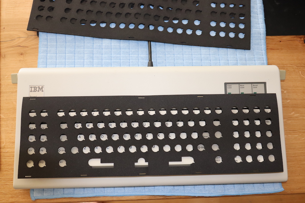

I have received the foams for XT and the Bigfoot... and it fits like a glove ... the templates are good, imho: Unfortunately the foam is only 1.5mm thick. It does work, but not to my specs. I could use two foam mats combined and it was just right: I don't want to sell them, as they are way to expensive, when you need to use two of them. My order of 5 each did cost me 75 Eur with tax ...darkcruix wrote: 23 Jun 2021, 11:17I created my own templates and I ordered a very small batch for testing now ... I'll keep you posted on the outcome.qzyki wrote: 23 Jun 2021, 08:37Shoot, I would've totally purchased one from you if they were the right size. Any plans to try another batch?darkcruix wrote: 07 Jun 2021, 11:35 If someone wants to build an extremely oversized Model F XT, I have foams for it ....
